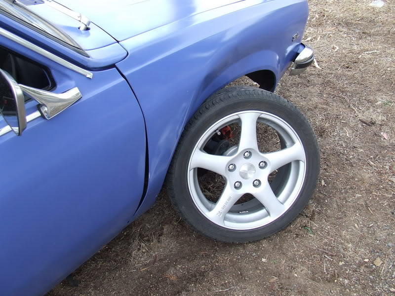

Today i have encountered first hand the dangers of wheel adaptors. I bought some for my lx so i could use commodore wheels on my car...
I can't find who i purchased them off on ebay but after reading this i'm hoping you all will take my advice to stay on the safe side and stay clear of them!
I was cruising down the Hume highway at around 3pm this arvo on my way home from Kyabram when my steering wheel started shuddering, it wasn't a small shudder like i used to have in my torana but was rather vigorous. I braked and pulled off the road as quick as possible and just as i was about to stop and BANG!
The drivers side front wheel disconnected from the car and down she crashed onto the dirt.
It turns out the original studs on the torana stub axles snapped. It would have been from the extra pressure the adaptor plates was exerting onto them. Here is a picture.

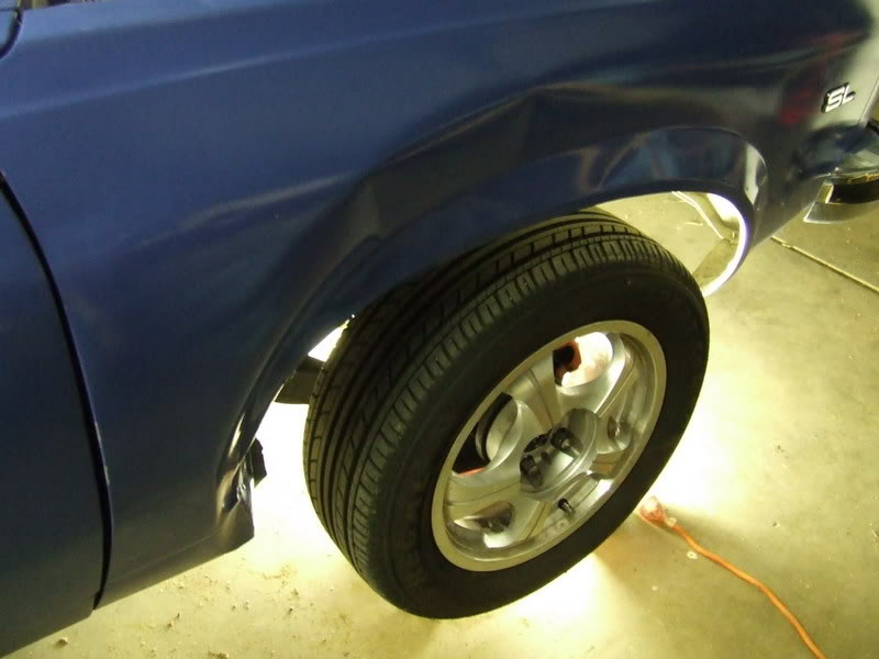

Not only could this have seriously injured myself or others, but it completely destroyed my front quarter panel, which i'm going to attempt to repair throughout the week.
I'm completely devastated (i know she's not a right off but the biggest accident i've ever had), i should've taken the smart advice of Damo and Marc and taken them off... i thought "she'll be right for this little trip maybe when i get back". you IDIOT rhys!!!

How tight did you do the bolts up into the adapter plate? What did you use to tighten them (rattle gun?)? What sort of bolts/threads replaced the standard studs?
Sorry, but I just have questions, personally I wouldn't use em, easier to change the stub axles and get the axles welded and redrilled, but you need precise equipment, if the PCD is out by the smallest amount you'll get bad results, i.e. wheels dropping off.

The adaptors shown in the picture are much thicker than mine, it's not that the adaptor cracked or broke, it simply placed a much higher load on the original studs by bringing the wheel out this creates a large downforce on the studs, in turn THEY BREAK.
"Also used to clear large brakes and as they bolt on to your car more safe then using spacers!"
They are entirely different to wheel spacers which simply space the wheel out from the stub axle/disc and leave you with less thread on the studs.

the nuts holding the adaptor plate onto the stub axle were done up using one of those four way "cross" wheel socket wrench, you may call it? They were done up rather tight, the same as what i do my wheels, not excruciating but really firm.
The studs on the adaptor plate were a little larger than the original ones and i'm pretty sure they're metric. When i purchased my new wheels they gave me a set of nuts which are metric (i'm pressuming new holdens are metric) and the thread is much coarser than the original ones.

rodomo luckily i was only 50km's from home so my little sister drove out and picked me up, drove me home where i unbolted the stub axle? i'm not sure i'm using the correct terms, well the part containing the disc and studs off my spare front end sitting in the shed. It was a little rusted but was only surface rust. drove back out, jacked her up (on the side of the hume highway mind you with big semi's rushing past at a million miles an hour haha) removed the caliper and then replaced the disc...
i didn't want to make the same mistake again so i used my original torana stud pattern speedy 15" wheel, bolted it on and eventually made it home safe and sound. quite an exciting afternoon i had!

Looking at the marks on the Torana disc hub, it appears the centre bore was a touch too small on the adapter. This would prevent the adapter from bolting up to the disc properly. Which would of course eventually cause the failure shown in the pics. As I said, my view is merely from a visual inspection of the photos.

Is there a pic of the adaptor, was the adaptor wheel supported by the centre? no surprise that the studs broke off if it wasnt with the extra distance/ leverage provided by the adaptor.
With 20/20 hindsight it may have been possible to avoid the wheel coming off completely once you noticed the vibration, using the front brakes was possibly the worst thing that you could do in the situation.

Chopper, the adaptor bolted up and sat flush with the torana disc hub, that i'm sure.

I am sorry to hear about your accident. I doubt you would ever feel safe using the adaptors again but I think it would be worth posting some more pictures of the adaptors to see if someone can work out the cause of failure. Have you owned the front disc's from new or did they come with the car. It is possible that the studs had been fatigued or damaged by a previous owner.
I am not convinced that there is any extra load on the studs. I do not see the difference between having the correct offset rim and the Commodore rim with adaptor to make it the correct offset rim. If the track remains the same then what has changed?
Most mag wheels do not have centre bore locator's.
I suggest that anyone who does run adaptors or spacers should consider fitting Commodore studs to the axles and disc's as a safety precaution.

something has gone wrong here at my old work i sold alot of these adaptors to fit au+ wheels the pre au's being the 30mm diffrence the only problem which looks like it may have hapened here is the the nuts holding the adaptor on need 2 b recheaked after 100km's (just like new alloy wheels) because of how soft the alloy is they do need recheaking. the 911 wide bodys run this sent up from factory BUT legaly they r a very gray area
