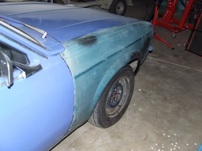

I picked up a new panel in good condition for $55 and fitted it a few nights ago, here's a picture.
Now all she needs is a decent paintjob and some new wheels and she's near complete.
