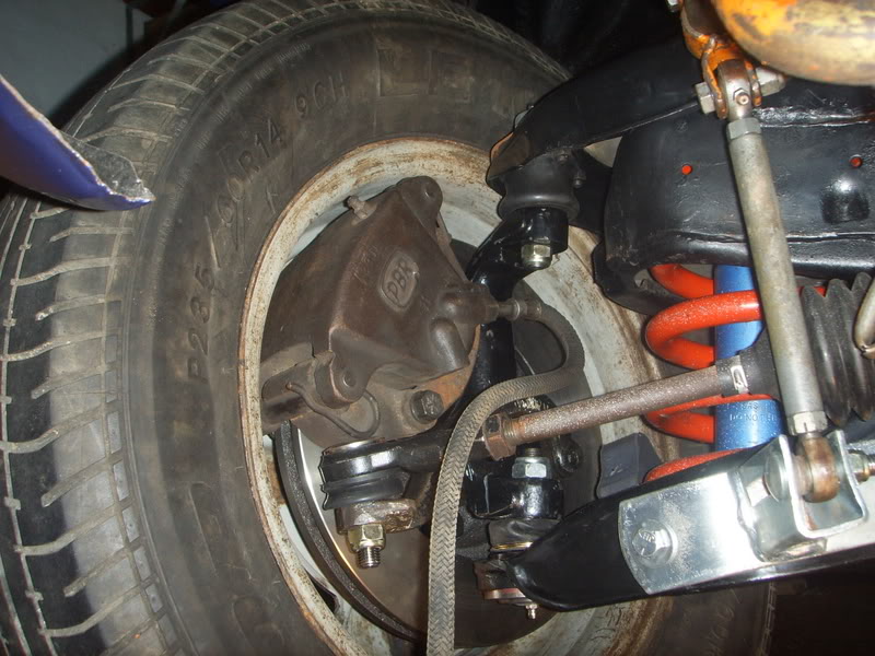

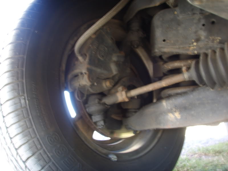

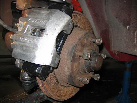

why go to all the bother of grinding etc when a hq caliper will bolt straight on with a hq-z stub? if your after great brakes ,go for something exotic. if you want to use standard equipment then use something that fits.
here is what i wanted to replicate.
L34 pbr caliper.
this is what i had.
standard torana pbr caliper.
remove and throw away,remove stub and throw away.
this is what i did.
HQ pbr caliper.
put left hand hq stub on right hand side of car,fit UC steering arm,fit disc and caliper.
repeat for opposite side.
route hoses in a safe manner(ignore pic/not finished)
ensure caliper doesnt foul upper control arm.(some arms need a clean up of lower edge.)
now thats not rocket science is it?

pic 9: hq stubs with harrop a9x steering arms and wb calipers ( modded ) and commodore brake lines from front
pic 10: hq stubs with harrop a9x steering arms and wb calipers ( modded ) and commodore brake lines from rear
pic 11: hq stubs with harrop a9x steering arms and wb calipers ( modded ) and commodore brake lines from rear

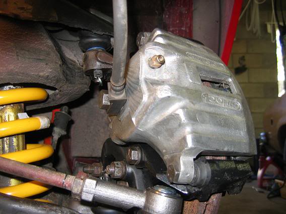

ive modified my lh torana to hq stubs on the front ( swapped from left to right ) and have bought a set of harrop a9x steering arms for the mod. I also have a set of wb calipers ( girlock alloy type ).
Now stop me if im wrong but what Ive read is that this is what was set up on the original a9x toranas. ( holden they made their own steering arms, and all calipers have same mounting arms, but calipers are cast iron or alloy )
I could place the stubs back the other way and have the calipers on the rear half of the front disc, but in full lock the pads hit the crossmember, and push the pads out ( not good next time you need to brake :D )
With the new harrop a9x arms ( to remove bump steer ) the tierod now sits higher, and fouls on the caliper. Ive heard of people putting the tierod end upside down, but then your steering arm isnt parallel to your lower control arm so your steering would be buggered so thats not an option. :(
I heard that the holden engineers ground the calipers to fit over the ball joint but have never seen a pic or set of ground a9x calipers in real life. Does anyone have a pic i could reference, as I have ground mine and they now clear the ball joint in full lock both ways and as well in full suspension travel, but i just wanted to make sure, as you have to grind a fair bit to fit over the tierod with full travel room, but theres still plenty of meat left, just wanted to double check.

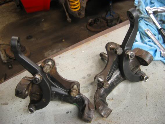

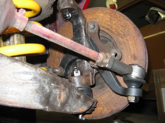

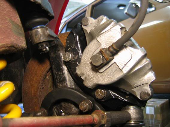

Heres the conversion

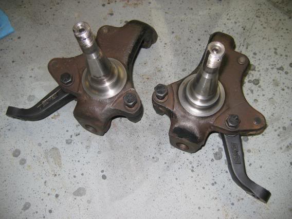

As promised here are my pics of the torana to hq/wb conversion so far.
pic 1: hq stubs with harrop a9x steering arms from front
pic 2: hq stubs with harrop a9x steering arms from rear
pic 3: hq stubs with harrop a9x steering arms fitted to pasenger side with tie rod attached

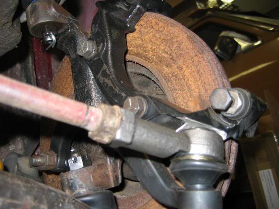

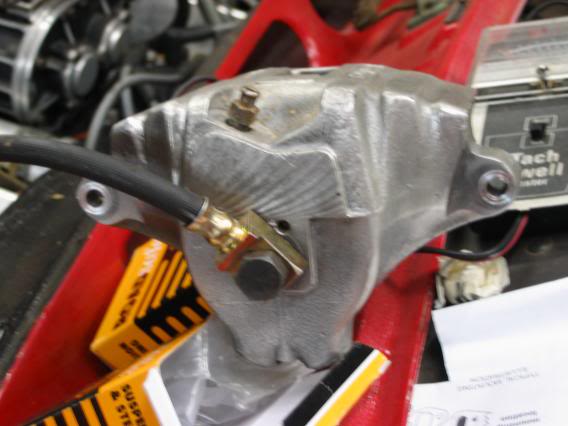

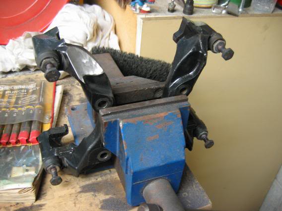

pic 4: passenger side caliper mounting bracket ( wb? ) with metal ground away for tie rod clearance
pic 5: the master at work! :) ( note super cheap grinder/japanese safety boots/and petrol station sunnies )

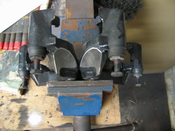

pic 6: both caliper mounting brackets ( wb? ) with metal ground away for tie rod clearance
pic 7: passenger side caliper mounting bracket ( wb? ) with metal ground away for tie rod clearance mounted on car to show clearance ( make sure you check full lock and full suspension travel )

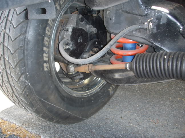

pic 8: wb? caliper with commodore banjo style brake line and bleeder at the top
hope you like, and thanks to everyone for the help so far.
cheers Julian
