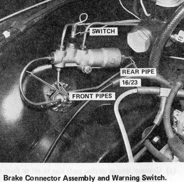

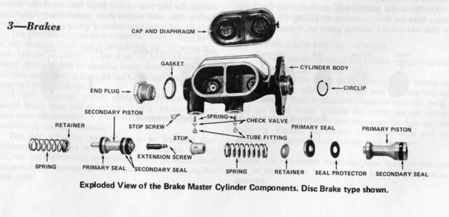

The rubber valve under the brass acorn is referred to as the spring and check valve in this picture. The valve is only required for drum brakes and if left in will cause disc brakes to drag.
The proportioning valve should be retained. It is the cylindrical object with all the brake lines attached to it.
Its purpose is to prevent the rear wheels from locking under heavy braking. I do not know if there is any internal difference between the drum brake prop valve and the disc brake prop valve. I had mine rebuilt and told them I was using rear discs.
It will take a considerable amount of bleeding to remove all the air from the lines. You can often gravity bleed the brakes to get the bulk of the air out. Open the furthest bleeder with a line connected to a container and check the master cylinder is full every couple of minutes.

I would recommend purchasing flare nut spanners for working with brake and fuel lines. If the flare nut is tight then an open end spanner will most likely damage it. The master cylinder has 9/16 and 1/2 flare nuts.
Once the brake line is removed from the master cylinder the brass bush is removed by screwing a self tapper into it then pulling it out with a pair of pliers.

Once you have finished bleeding the brakes you have to reset the brake warning light switch. This is done by removing the switch on the proportioning valve, pressing on the brake pedal and then installing the switch.
