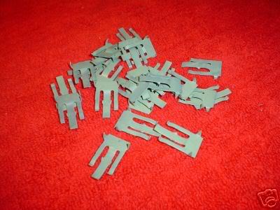

#42 _boynuz_
_boynuz_
Posted 23 March 2007 - 03:49 AM
I bought some brand new clips today. They are the same as the orginals and cost me $16 for 40 of them. I'm so stoked i could get them.
I can't explain why it comes up on the docket as a ford item, there's the code anyway.

#44 _boynuz_
_boynuz_
Posted 24 March 2007 - 03:31 AM
Those are how the originals look for lc and lj
