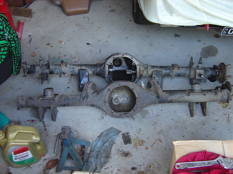

I now have ...thanks to Andrew at Milton Performance..a LH diff and Nissan B/W side by side...I will measure BUF and show pics tomorrow.

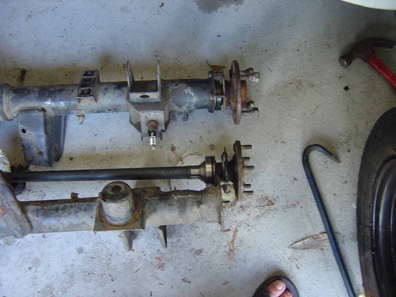

OK..The final washup..
Nissan diff housing 1338mm
LH diff housing 1320mm
Thats 9mm each side longer..
BUT!
After looking real hard..I installed an axle into their final resting places..and guess what??
The bolt up face from edge of flange for the Nissan is 53mm
The LH buf is 57mm....it sits out 4mm further than the Nissan
You can actually see in the pics the difference in axle hanging out past the bearing on the LH.
Final washup?...The Nissan B/W diff is 5 mm wider on each side...I can live with that!..get a ruler and look at 5 mm..The centres are even in the same place. End of argument.

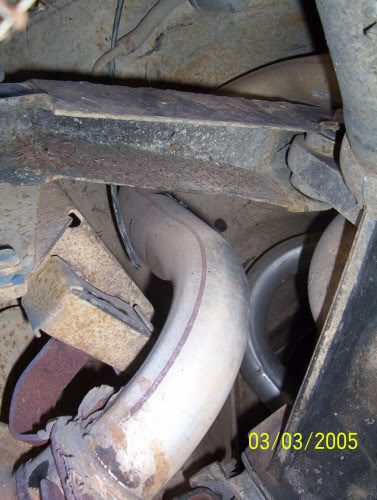

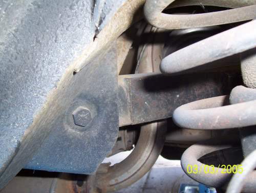

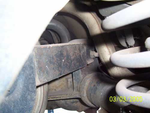

mine aren't actually dog-legged but I agree that they cant be working too well, here are some piccies
the sailsbury also seems to be taking up a lot of room under the car, more than I would be expecting with a 9 inch or BW
Edited by makka, 11 February 2007 - 07:19 PM.

Posted 11 February 2007 - 07:55 PM
thats precisely what i meant by dog legged.
better than some going around though.
great pics makka.
