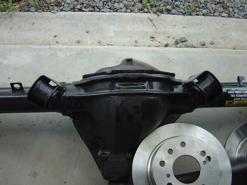

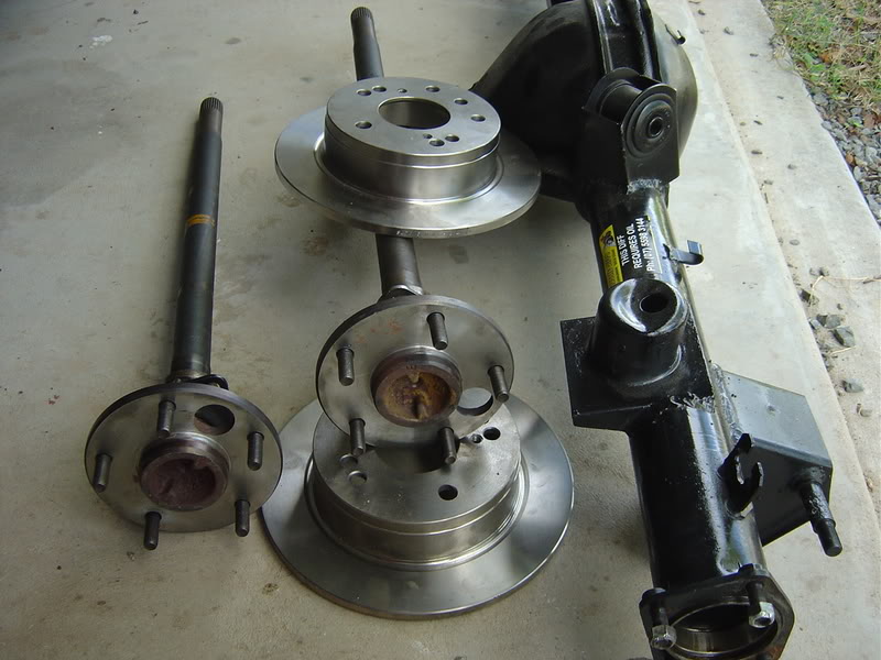

Posted 12 May 2007 - 05:17 PM
ITS HERE!...LOOKS FANTASTIC!!..Will pos pics in the morning ..have to go out tonight.
#74 _@milco@_
_@milco@_
Posted 13 May 2007 - 01:37 AM
party hard rory then show us some pic's mate i am hanging out
#75 _rorym_
Posted 13 May 2007 - 10:35 AM
Super happy with job...Just picks up a small section o the cast housing..redrilled an welded axles and redrilled rotors to HQ style. Even welded the brake lines holders on as well for the Nissan rear brakes. They fitted the rear cover so I will whip that off this arvo..fit axles and do an overall size/length to bolt up face.
