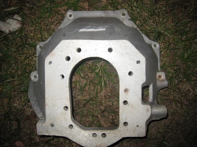

That would be ok if you had 6 cylinder.
These are the 2 dead weights i have.
Ill get the owner to PM you if ur interested in a price.
The lower of the two is both turbo and aussie pattern with cable clutch.
No forks, just bare bell housings.

If you wanted to use a hyd. clutch you can send the top bellhousing back to CRS and they can drill it for both patterns. Cost $45 last time I had it done.
LHM, you could use the box, speedo cable and hydraulics from that eBay deal, but would need to resell the 6cyl specific items. I reckon the deal is a bit rich. Give him a call or watch the auction. It may not get a bid, then you can extort him for the gear you need after it ends.

Cheers guys, i new the bellhousing wouldn't fit but is it a corona 4sp??
Good idea struggler so if i could get this, V8slrtorana's top belhousing get it redrilled, grab a new cluth, manual pedel etc would that be what i need?

That is the right box.
If he comes up with a tailshaft you can just change the slip yoke over to your shaft.
His crossmember looks a bit full on !!
Get a new spigot bush from CRS.

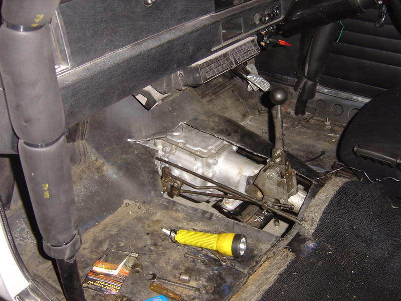

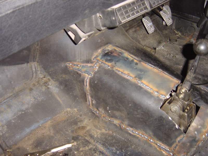

Posted 24 October 2008 - 07:56 PM
Before
After
NO WAY did anyone fit a toploader without modding the floor...thats a Hurst shifter...I am about to try a Renagate sequential after Nossa Historic in Nov.
rorym I modify where shifter was positioned , I also had to give the trans tunnel a couple of hits with the fbh to allow room for the shifter linkages . I did'nt have to cut it up like a tin can the way you did , I wanted to keep it a close to stock as possible without weakening the tunnel .
#58 _rorym_
Posted 24 October 2008 - 11:04 PM
I WANTED ROOM..MAYBE 1/2" CLEARaNCE ON EVERYTHING TO GET AT THE LINKAGES..THE fbh IS AN OPTION BUT LEAVES NO ROOM TO ADJUST ANYTHING.....WITH THE CARPET IN...NO ONE KNOWS ANY DIFFERENT.

#59 _rorym_
Posted 24 October 2008 - 11:06 PM
If you didnt lift it to that height...I would check your gearbox/pinion angle.
