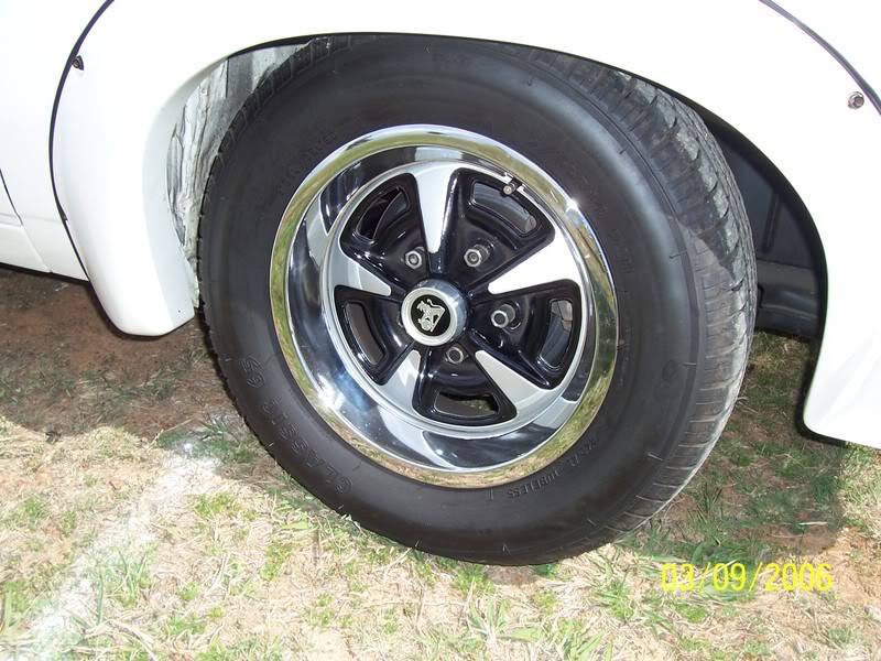

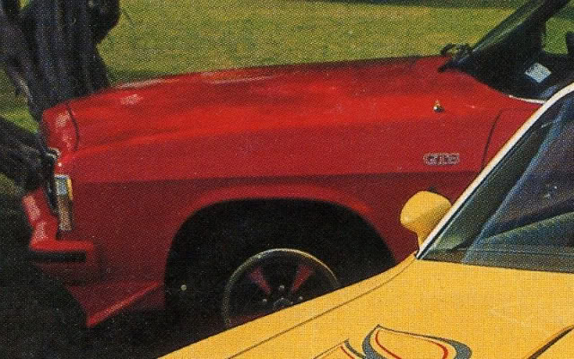

Here is a couple of pics I took at the 06 Muscle Car masters.
This should show the difference.
Hope this helps
#19 _pallbag_
_pallbag_
Posted 26 March 2008 - 10:25 PM
It shows us the difference but doesnt really explain the difference ... which picture shows which grey ?

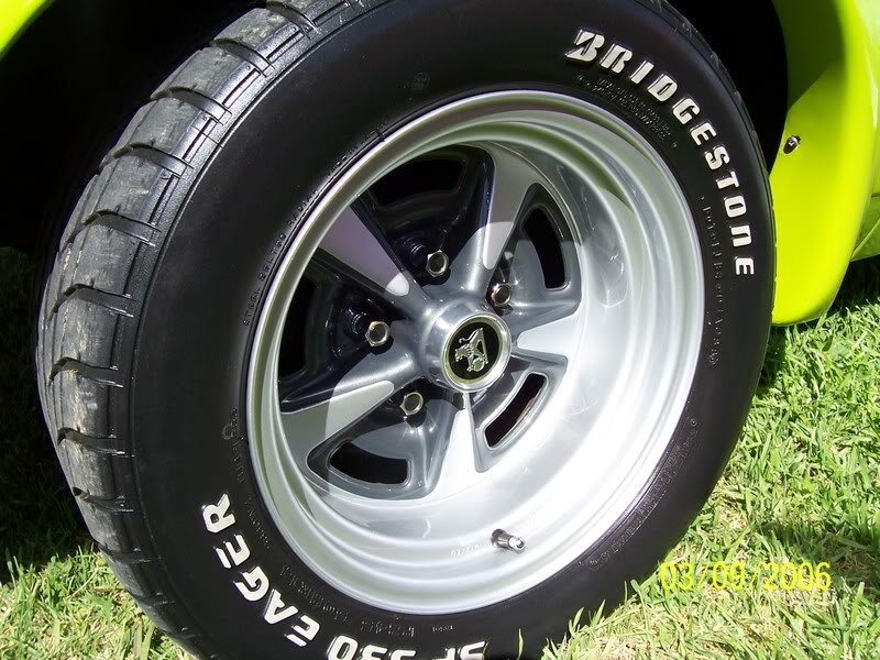

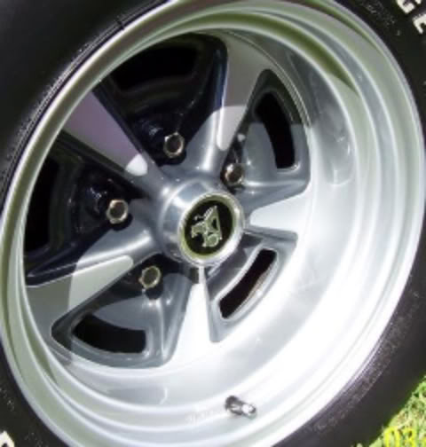

This is one I have had done in 350 grey metallic and 350 silver . I asked the same sort of question about he paint I thought it was supposed to be a lot lighter.

Basically the 350 Grey/350 Silver was used throughout the HQ range and included the L34 Torana. (Short tail centre caps)

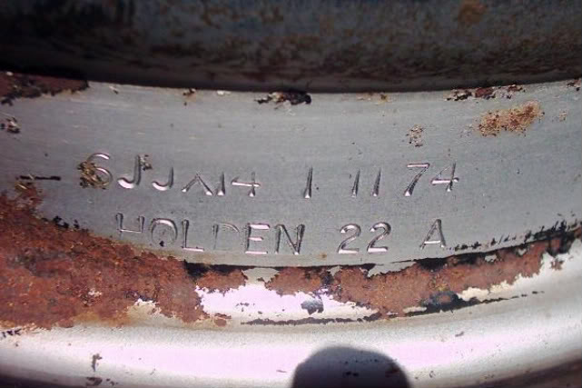

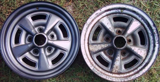

These are the best pics i can come up with so far for Charcoal Grey/Wheel Silver
The rim on the right is a HJ rim dated 1-11-1974. As far as paint goes its still a virgin (ie factory original paint) not in bad nick still for a 34 year old paint job.
The rim on the left is also a HJ rim that im restoring for a mates HJ Sandman Panelvan. As of yet i have,nt masked it up and applied the silver. (To lazy).
This is the best i can come up with for the silver (Wheel Silver 17216)

Brian (slr5640) that colour match on your L34 Torana rim looks allmost perfect to me.
