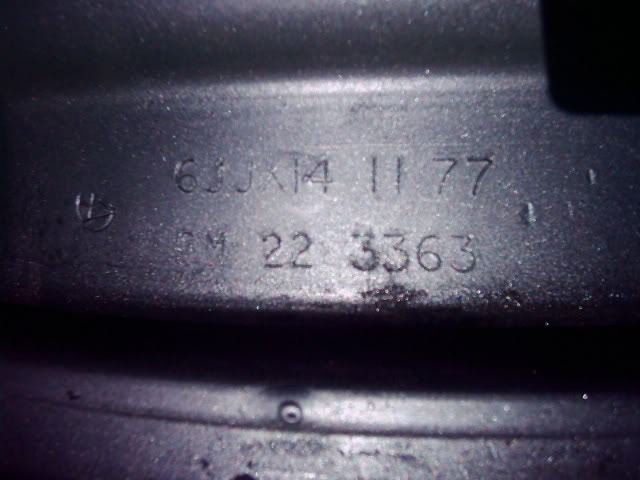

320 = 320th day of (Wednesday the 16th of November)
7 = 1977
22 = ROH code for Holden
There were 2 batches of A9X Torana rims built. These are often referred to as 231,s and 256,s.
231 = Friday the 19th of August
7 = 1977
These were generally used on the September built A9X Toranas and had no date inside the rim, only GM 22 3366N.

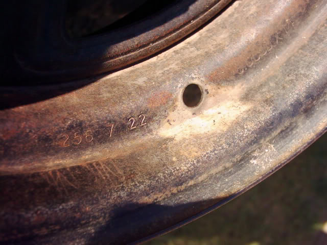

The 256
256 = Tuesday the 13th of September
7 = 1977
These were generally used on the October, November and December built A9X Toranas and are dated 9/77 inside the rim.

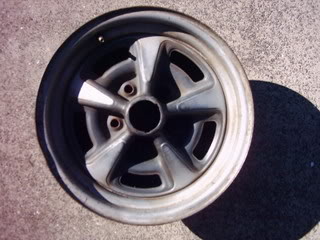

I couldn't find dates introduced, but I did go fishing in the boot and in the shed to see what I could turn up and this is what I found.
The rim below is an unmolested original A9X rim in a low KM car. It still has the original tyre thats never been fitted to the car.
The colour looks the same as the one on ebay at the moment

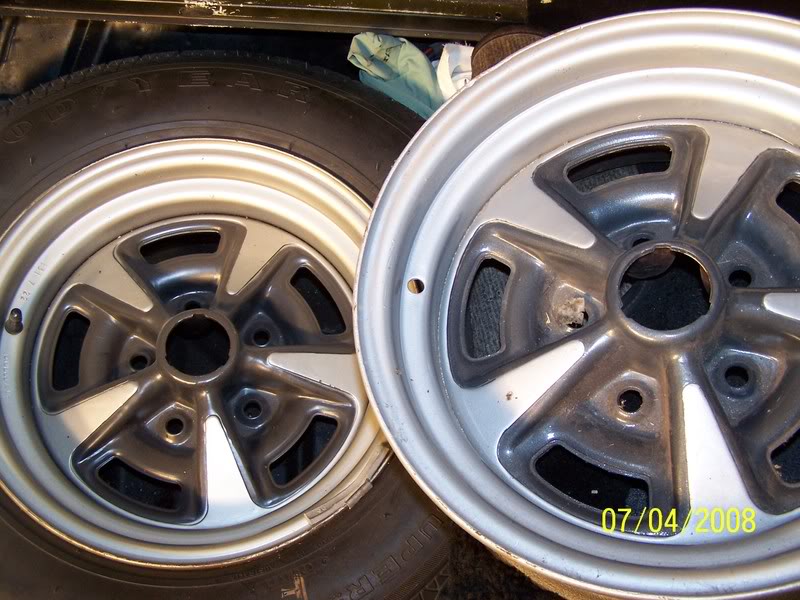

This is an L34 rim painted in 350 grey and 350 silver
It's hard to tell from the pics, but in real life they are very similar, the repainted one looks to be a little darker, but it could also be the paint is a lot thicker than the original rim.
Here are the two of them next to each other

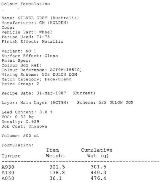

YES, Mick (REDA9X) you were 100% correct. A painter friend and i got together and mixed up 6 different Holden greys and silvers, which we then applied to 6 different GTS rims. We had 2 GTS rims with original paint still on them to compare and match by eye.
After mixing and spraying all these Holden Greys & Silvers our conclusion was that Grey 350 (13384) & Silver 350 (13383) was the correct match..............

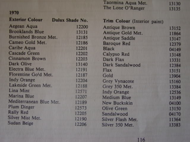

3 colour charts for 1974. The first one was January, with another one released in March, however it was identical. The new colours didn't come online until October 1974. I believe this is when the GTS wheels changed over. (After L34 production) Eyepeeler has an A9X rim on his unrestored L34 and you can see the difference in the colour.
Attached File  1974 October 2.jpg   79.67K   1 downloads
