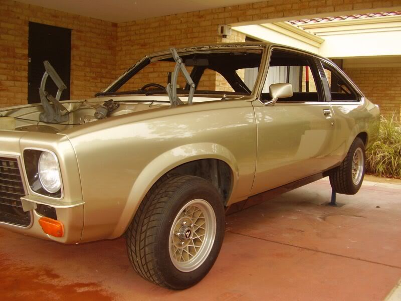

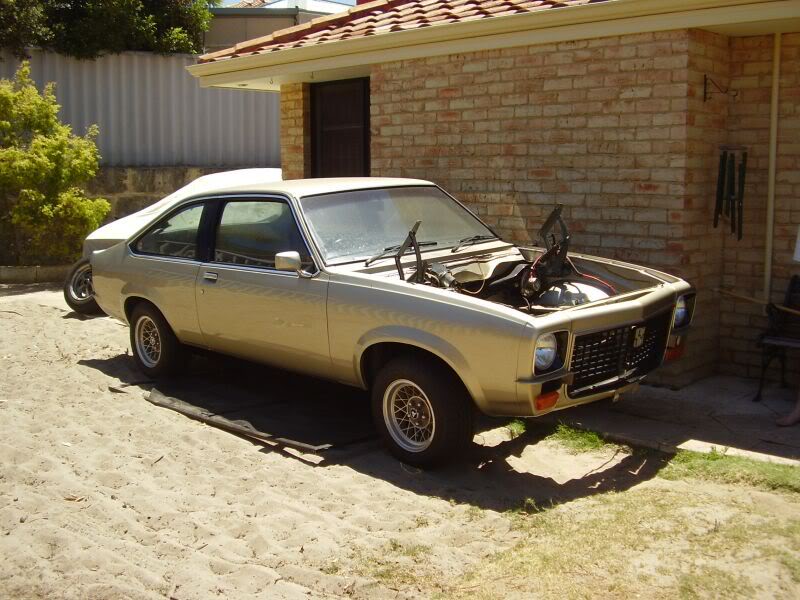

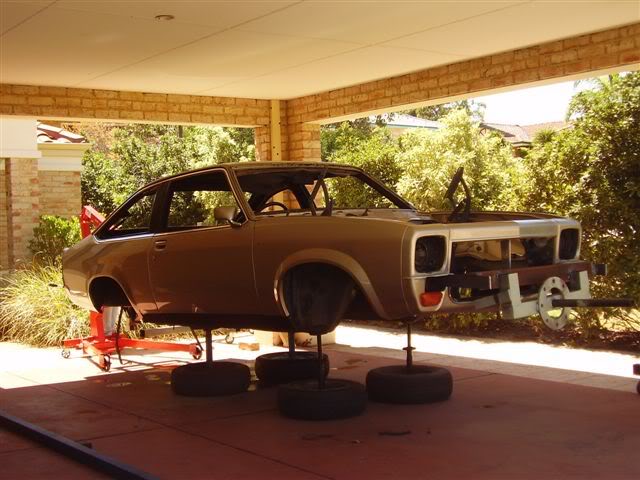

After much delay, many excuses and finally taking instruction on the posting of pics from Datto and my 12 YO;
Here are some pics of the build to my hatch.
The car is being constructed to 2007 CAMS Tarmac Rally specifications - C3 to be exact. (Although most of the earlier part of the project has been C2).
Firstly, here is the old girl as we started the strip down.
#2 A9X
Posted 29 April 2007 - 10:50 AM
The sand patch is the area i cleared when i ordered my shed for the project.
Back in October.
Shed was installed last week of March
until then, we had to strip and blast the old girl in my carport.

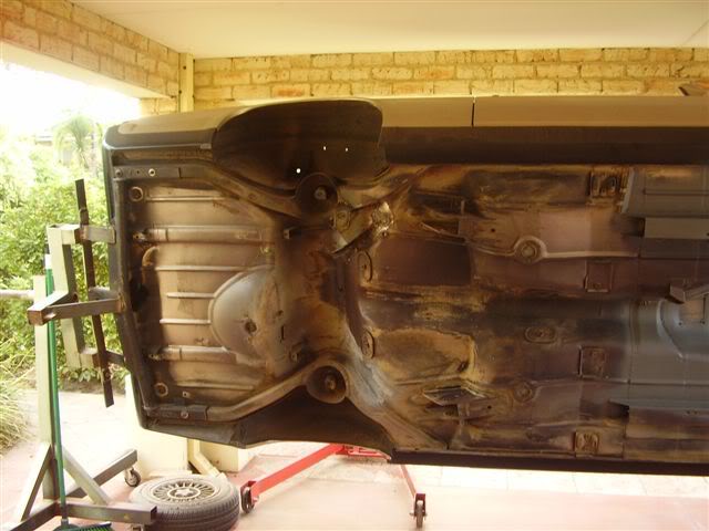

#3 A9X
Posted 29 April 2007 - 10:51 AM

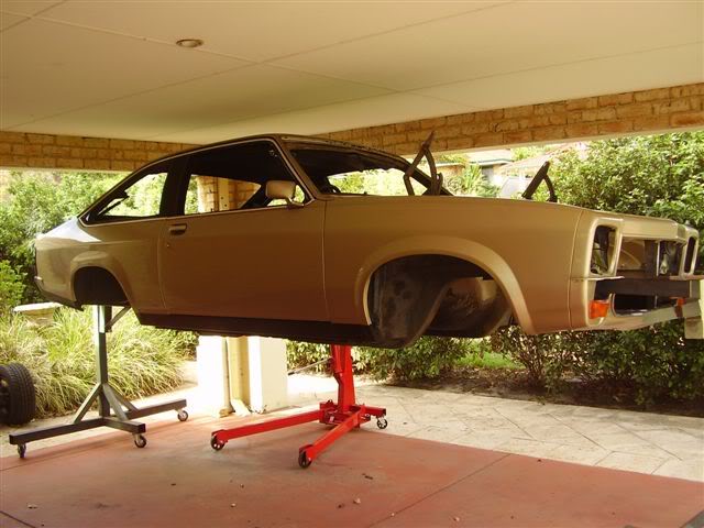

#4 A9X
Posted 29 April 2007 - 10:52 AM

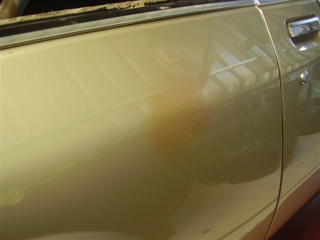

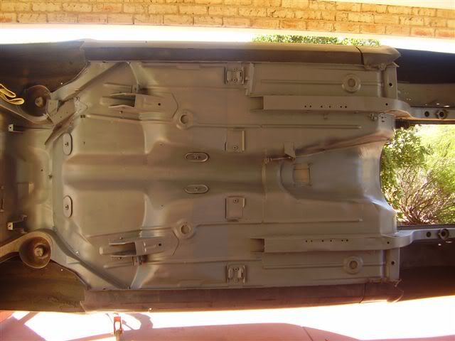

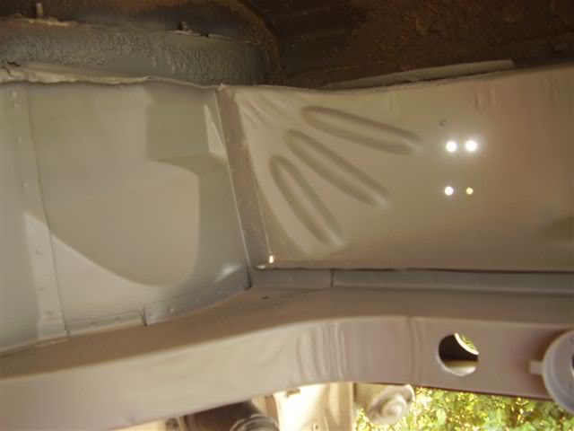

Posted 29 April 2007 - 10:55 AM
as you can see, the car was a very clean and tidy example before we started.
No rust anywhere apparent, although the drivers side c panel had some when we went looking.
There are two pinholes in the drivers side floor that only showed up after the sandblasting.
Otherwise, rust and dent free.
More pics tonite.

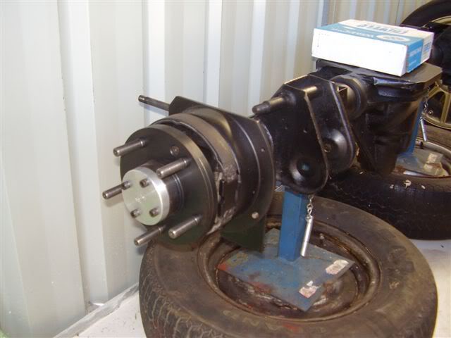

More pics to follow, diff is a genuine A9X unit, with full floating axles and Harrop discs, Big Tank is a Brown Davis unit.
Ian Tate is building the motor from a virgin block, specs to follow.
Front brakes are Harrops, gearbox at this stage will be a Tremec TKO (unless a Super T10 falls into my lap)

The body on this thing is super clean
Infact for a 30 yr old car it has less rust than most new cars
It had a 5c piece sized surface bubble on the drivers C outside skin
feeling inside the inner panel is perfect and clean
Almost a shame to sut up a perfect car for flare fitting
The best hatch I have ever seen bar none

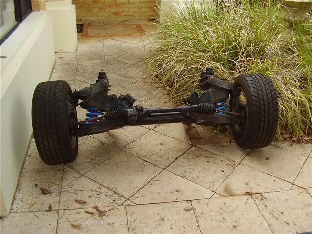

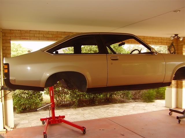

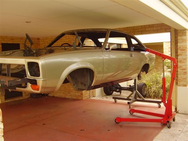

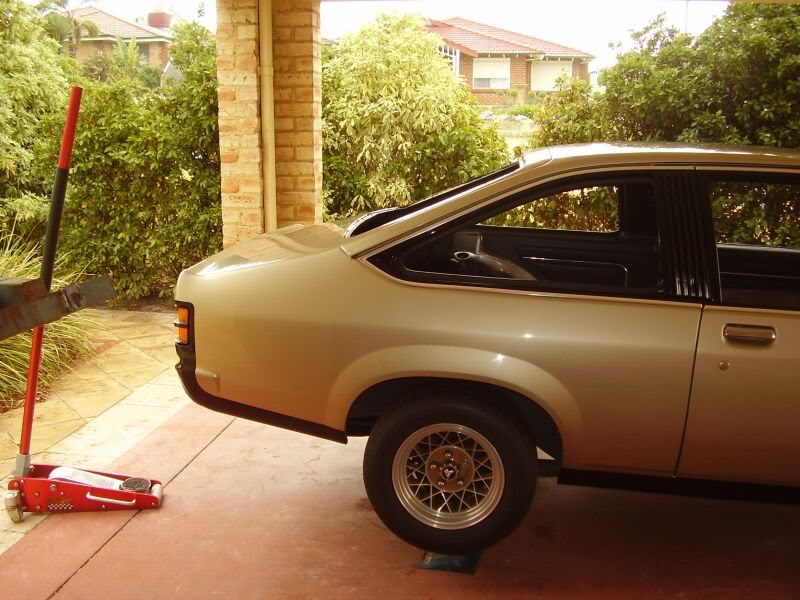

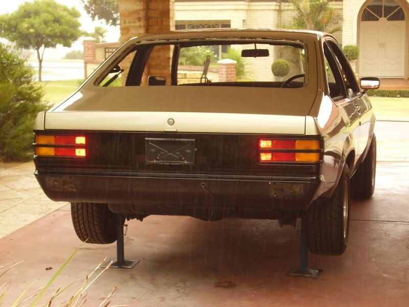

So to continue, up in the air sje went to first drop the front crossmember and then the diff.

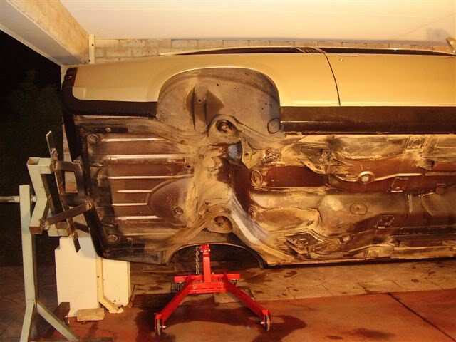

#18 A9X
Posted 30 April 2007 - 07:54 PM

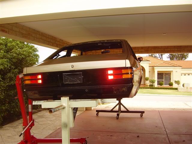

The Rotissorie was built for an LJ, and in our haste to make it fit, we didn't get the balance right. The bugger was so top heavy.....
The only way we could turn it was to use an engine crane and lower one or the other sides down

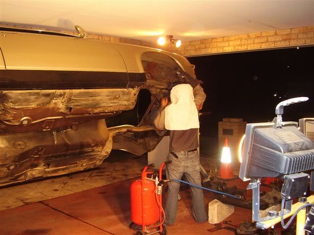

Posted 30 April 2007 - 07:55 PM

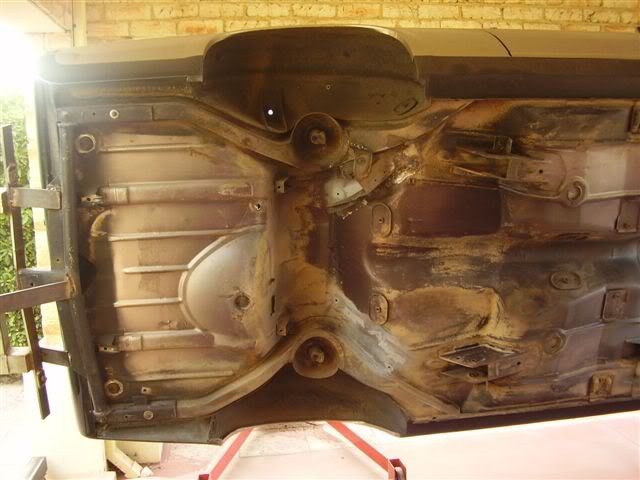

Next up, scrape and sandblast the chassis and the floorpan.
#20 A9X
Posted 30 April 2007 - 07:58 PM
sandblasting was done over a couple of nights, apologies to the neighbours.
In the end , the job was well woth the effort
#21 A9X
Posted 30 April 2007 - 08:03 PM
minor F@#$k up.
When stitch and seam welding the rails, some metal or sparks fell onto a rag that had fallen into the rear quarter panel recess above the wheel arch.
Murphy's law being wht it was, the only flammable material in the car caught fire. We didn't notice it quick enough and the heat from the rag blistered the exterior paint.
The car is being taken back to metal anyway, but it was the first blemish in a good project.

a quick view of the Harrop Diff with the floating axle mods and the inner handbrake.
Some pics of the brakes soon.

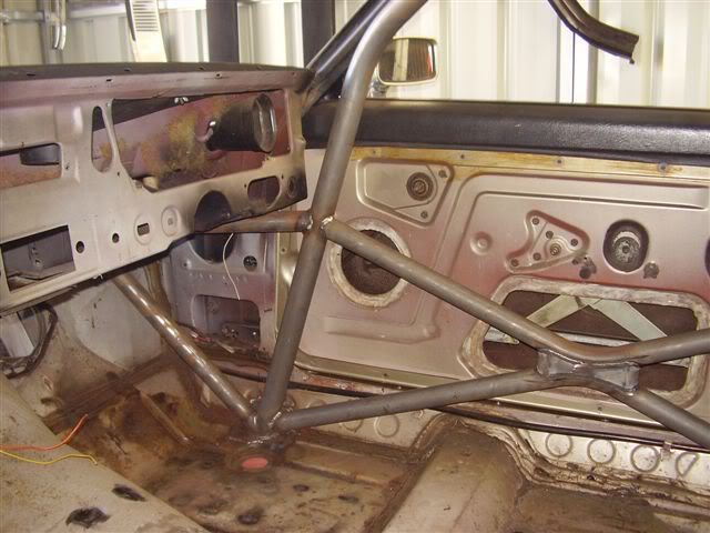

#23 A9X
Posted 30 April 2007 - 08:08 PM

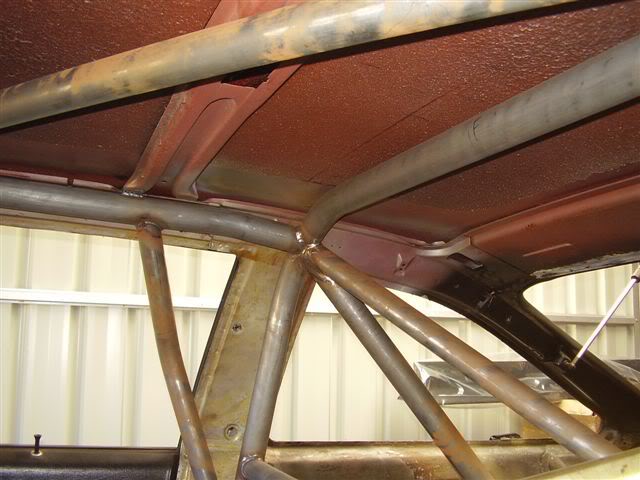

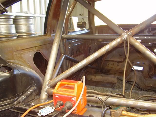

and lastly for today,
some quick pics of the cage
Welby

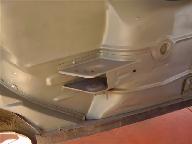

#25 _The Baron_
_The Baron_
Posted 30 April 2007 - 09:14 PM
I spy you have removed a top arm mount for the diff.
Next a UC Patch?
Good way to go.
Just mount up the diff with all the arms attached to the diff and lower mounts on the car.
Then attach the top arms to the UC patch and get your pinion angle right and start welding. If you UC patch is a little bigger to allow overlap, you should get a stronger finish.
