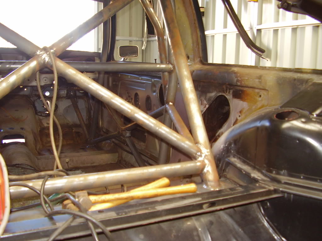

Here's a couple of quick pics of the cage.
Better photo's soon if anyone is interested.

#52 makka
makka
    A møøse once bit my sister
  • 3,559 posts
  • Name:Cohen
  • Location:ya daughters place
Posted 03 May 2007 - 01:38 PM
she is gonna be nice and tight on the feet!
#53 dattoman
Posted 03 May 2007 - 03:04 PM
Plenty of room for Welbys small feet
He has little girly feet and wrists
Not much room for an accellerator pedal though
But we have a plan

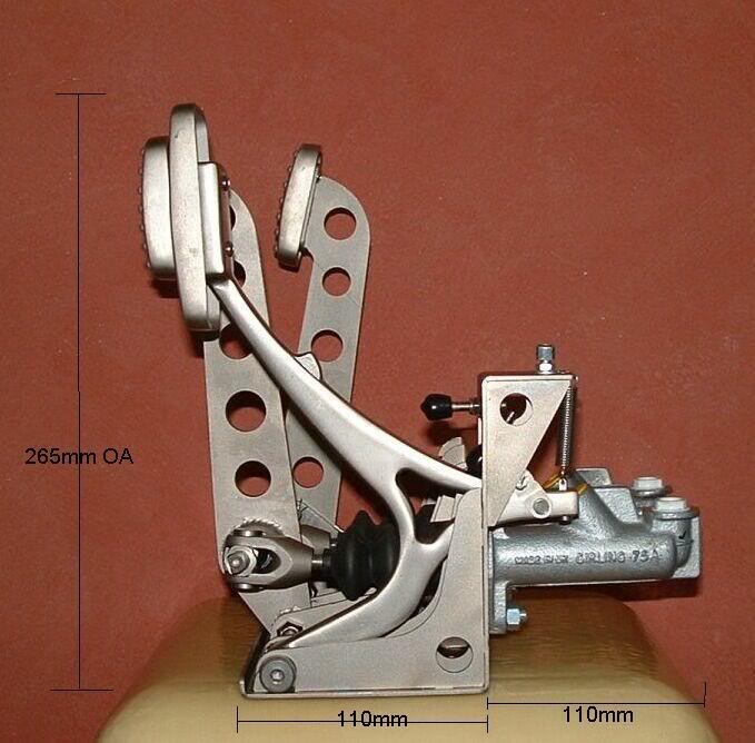

#55 Racehatch
Racehatch
  • 1,028 posts
Posted 03 May 2007 - 03:38 PM
But we have a plan
Custom pedal box - wilwood or similar?
#56 A9X
Posted 03 May 2007 - 04:17 PM
Similar
:D
#57 _rorym_
Posted 03 May 2007 - 05:00 PM
Targa West 08 looks like a possibility..Jesus ! Welby! You will need 500HP to carry the cage!!! I am using Wheels on WideBay in June as one of my observation runs to get my National Rally License.
Edited by rorym, 03 May 2007 - 05:02 PM.
#58 arrimar
arrimar
  • 3,134 posts
  • Location:brisbane
  • Joined: 13-January 06
Posted 03 May 2007 - 05:02 PM
mmmm triangulation....love it.
will the dash still fit in?
#59 dattoman
Posted 03 May 2007 - 06:45 PM
Best hurry the painters up Welby
The boys want more pics
Decel pedalbox . Floor mounted 3 pedals
Dash still fits in uncut
#60 _1uzbt1_
_1uzbt1_
Posted 03 May 2007 - 06:49 PM
just outta interest,who built the cage,looks the biz

#62 dattoman
Posted 04 May 2007 - 12:17 AM
I think the goal is 480
According to Tate-o
Matty the cage is a Maitland I believe
#63 A9X
Posted 04 May 2007 - 11:16 AM
G'day
Yes Rory , the cage is a bit heavy, but we will cut some weight out of the occupants.
Starting tommorrow, no more donuts.
The pedal box is a Decel, pretty piece of kit too.
There are pics from Rory's thread -
http://www.gmh-toran...&highlite=decel

Gearbox is to be the excellent Tremec TKO but at this time we have not chosen a clutch.
The cage was built by Steve Maitland who does all the work for Maximum Motorsport, the Subaru boys behind Dean Herridge. Championship car builders who know what they are doing.

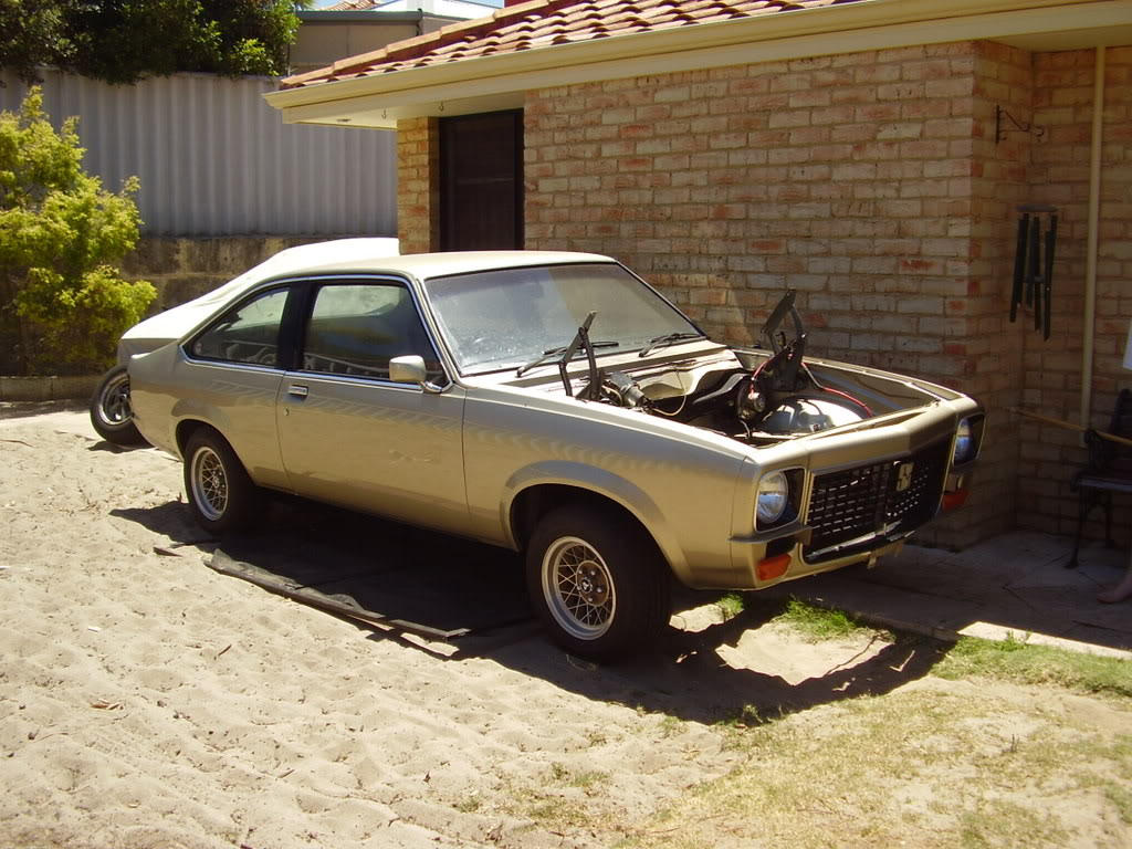

#70 A9X
Posted 06 May 2007 - 01:08 PM
Well the car has gone to the paintshop which will give me time to work on the shed.
Ordered in October last year, the building boom here in the west meant that they didn't start it till the beginning of March.
I laid some paint down but it didn't take, so with the car gone for a few weeks, it's a good opportunity to redo the floor.
Heres a before and after.
Welby
#71 _Chamois hatch_
_Chamois hatch_
Posted 06 May 2007 - 01:17 PM
nice build, just one question
whats with all the sand and no grass?
#72 _rorym_
Posted 06 May 2007 - 01:18 PM
Dont you have any good engine builders in WA? :huh: Thats b4 he put the slab down for the shed Chamois.
Edited by rorym, 06 May 2007 - 01:18 PM.

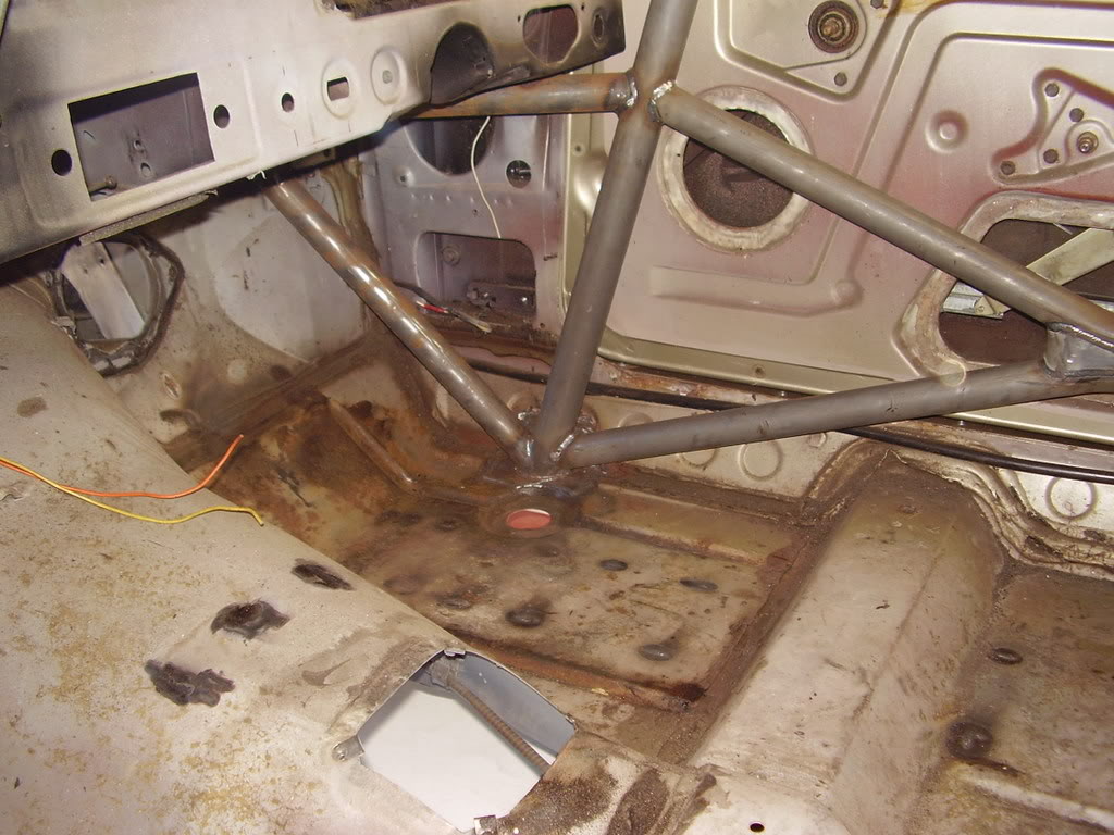

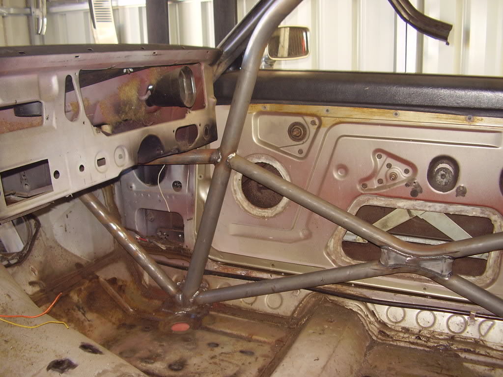

#73 _rorym_
Posted 06 May 2007 - 01:21 PM
Datto did you trial fit the pedals in the well?..There is not a lot of flat floor there up against the fire wall....
#74 A9X
Posted 06 May 2007 - 03:49 PM
Rory is right, the grass was pulled up in readiness for the slab, i thought it would take a couple of weeks, I just didn't expect it to take a couplke of months.
We have trial fitted it, luckily i've got duck's disease so we can pull it towards the seat a bit.
We may also lower the steering wheel a bit and move the seat back a bit further than standard.
Seat fitting yet to be completed.
Pics to follow.
Welby
#75 _rorym_
Posted 07 May 2007 - 06:03 PM
I was more concerned about the height of the pedals...and if the reserviors cleared the floor at the back as it slopes up quite quickly there. Guess you need to see it in.
