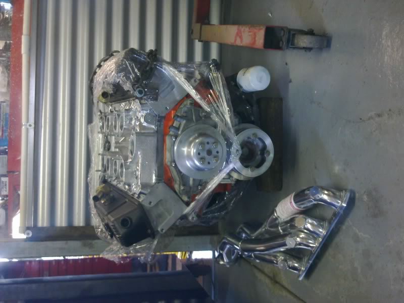

Posted 20 December 2009 - 01:20 AM
Just got texted a pic of my engine at the builders.
Its back together and the manifold and extractors have been ceramic coated.
hanging out to finish the top end now, got the new jets while i was in europe,
looks like the christmas break will see me swinging spanners :burnout:

It'll never run at that angle

Easy access to the oil filter thou.
