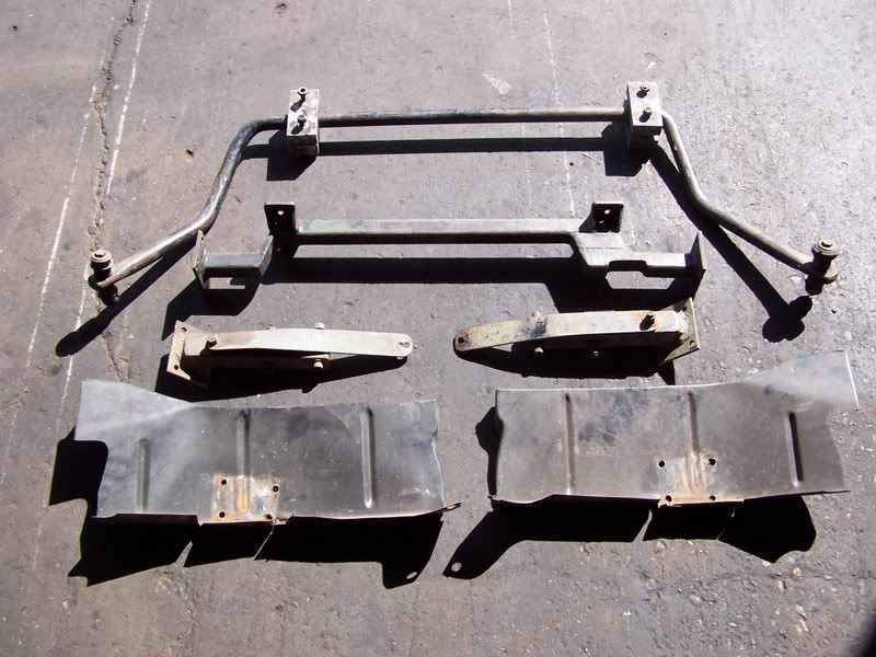

Hi was wondering if anybody had any pics of a group C or A9X font sway bar and mounts. I require any information on these front bars. How the mount to the car and wish bones and if they run in front of the engine. And what sort of bracketry required to mount it.
I have a normal sway bar that mounts to the rear of engine but as i have put extractors on the sway bar does not fit. Any help would be much appreciated.

I can tell you that the Jansen/Perkins 79 Bathurst A9X had a front mounted bar last time I saw it
It mounted with alloy blocks to the chassis rails and large green brackets to the lower control arms
I don't have any pics here with me at work but Welby might as I sent them to him recently

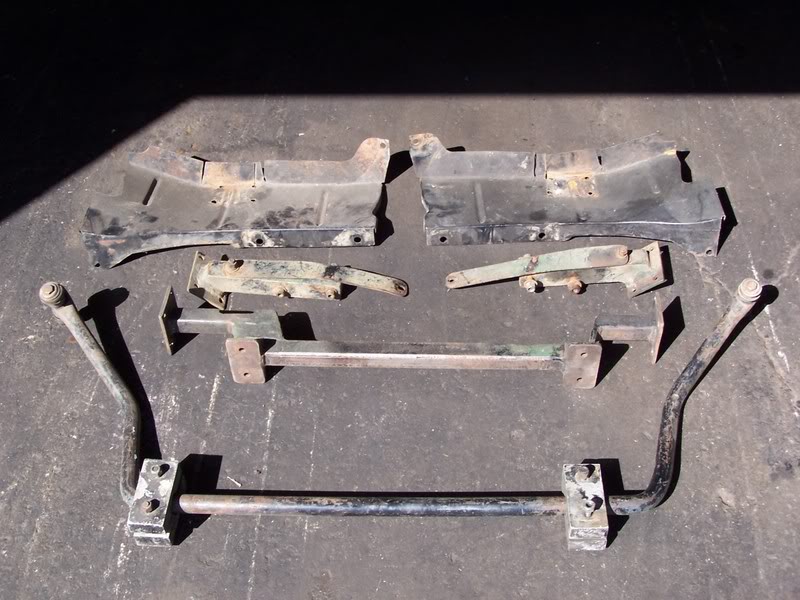

#14 A9X
Posted 09 May 2007 - 03:54 PM
Here ya go Rory.
Sorry for the delay, some of us have to work.
The Janson A9X
Welby

#16 _yellowa9xs_
_yellowa9xs_
Posted 09 May 2007 - 08:40 PM
Welby, that side view of the sway bar looks exactly like the one on my '77 Janson hatch. The alloy blocks look the same as mine.
#17 A9X
Posted 09 May 2007 - 09:19 PM
Hello Michael, i believe they are photo's of the '79 car.
How about some clear photo's from yours?
Did your car come from Rob Hands?
Welby

#19 dattoman
Posted 09 May 2007 - 09:38 PM
As you can tell by the horrid photos I took them
They are during the resto of the 79 car done by Paul Kramer
Didn't get many front bar pics
Got a few good rear bar ones though
