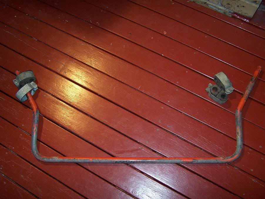

Rory i can still borrow the setup down here, if you want ive got that KMAC front bar that I got off ebay a few months ago, i'm just going to buy a new KMAC setup, you can have the sway bar ive got, make the brackets and you're done.
Either that or get A2 to sell his... :spoton:

Yeah didnt think you'd sell it, just thought i'd get Rorys hopes up lol, the KMAC bar I have is the front of engine type not the regular 1 between the engine/gearbox Rory

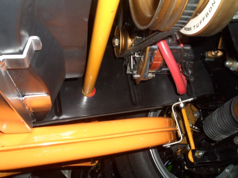

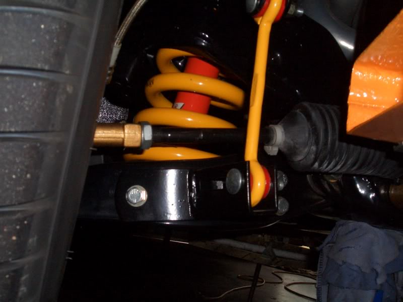

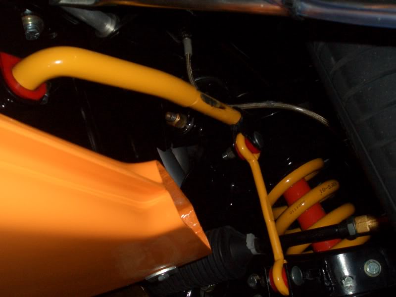

With the lastest kmac front adjustable forward mount bar , it clears the A9X brake ducts , but you either have to remove the splash guards or drill a hole in each to allow the bar sit through also if you have an engine fan off the water pump it could be a problem as I run thermos and it sits less then 1cm off.
The bar could of been better design shaped due to the fact of my 17x10 255s hitting the bar when turning and taking away some steering lock.
I emailed kmac about this problem but they would not respond , they dont back their product up very well , also the finsh is crap ,so I had everything powdercoated...
