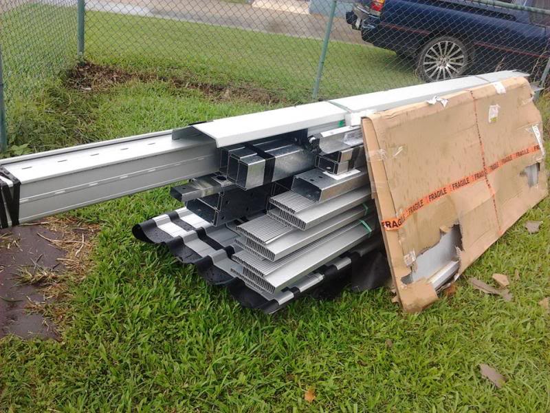

Posted 28 December 2013 - 08:48 PM
I just need a good erection to get it up.......................Single phase, 2 poster $1880 delivered.
