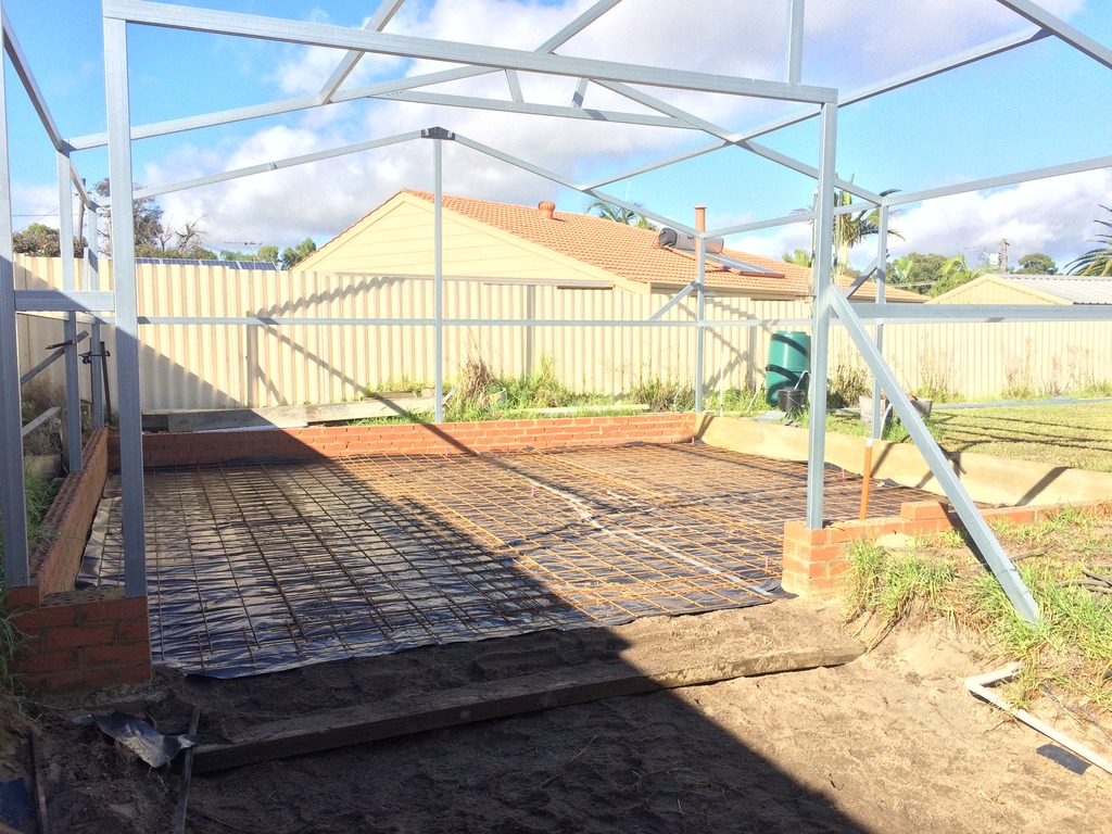

Finally getting the slab poured.
All prepped up and ready to be poured in the morning.
It's only going to be a small shed compared to others on here but it's big enough to get the job done.
The size is 7x6.5m
