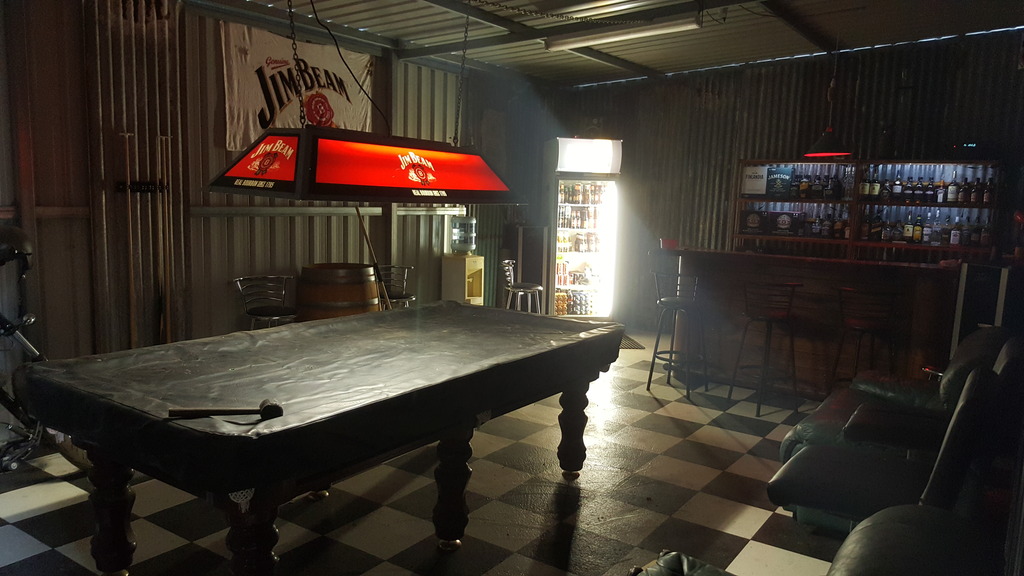

Posted 05 June 2017 - 07:28 AM
update
#754 Ice
Posted 05 June 2017 - 10:42 AM
Nice cave Jonesy didnt know you were a holy man
#755 Redslur
Redslur
    Has been Torana owner
  • 3,536 posts
  • Name:Gerry
  • Car:HQ GTS Replica 350.
Posted 05 June 2017 - 08:09 PM
Your burbon choice is spot on too :-)

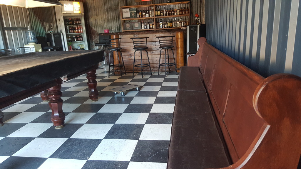

Posted 18 June 2017 - 02:04 AM
she is a nice pew, latest edition, got her for a nice price i dont the anyone else had the motivation to move it !
