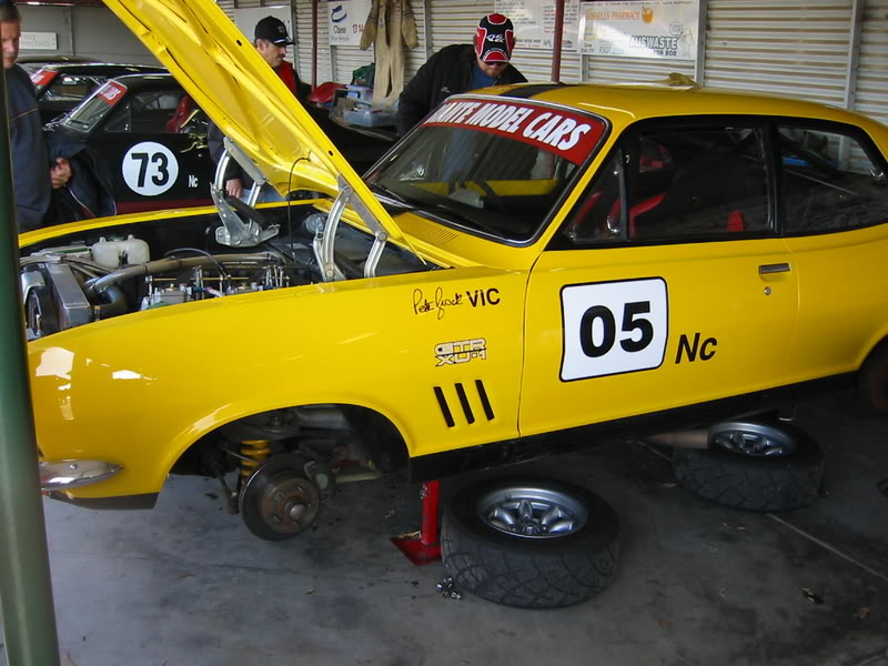

#14 _rorym_
Posted 15 June 2007 - 10:37 PM
This one.
#15 micklx
micklx
  • 1,785 posts
  • Location:Frankston South
  • Joined: 18-November 05
Posted 16 June 2007 - 10:08 AM
What happenned to that car after PB finished with it ?
#16 dattoman
  • 16,493 posts
Posted 16 June 2007 - 10:31 AM
I guess the owner took it back and its sitting in a shed somewhere

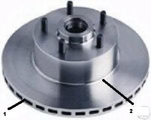

#17 _SLR Goat_
_SLR Goat_
Posted 16 June 2007 - 11:35 AM
when u say machine the outer diameter down by 6mm do u mean the part that the number one 1 line is pointing to and machine the disc face down to the bolt up face as line number 2 points to do u machine it down level if so much much does it take off the rotor thickness?
cheers dennis
Edited by SLR Goat, 16 June 2007 - 11:36 AM.
#18 Struggler
Struggler
  • 2,426 posts
  • Name:Andrew or AJ
  • Location:Canberra A.C.T.
  • Car:UC Sedan
Posted 16 June 2007 - 12:23 PM
Yes, 6mm off the No. 1 and on a USED disc you will need to machine the face all the way to No.2. To save time some shops don't machine the disc all the way to the centre when they remachine them. On a new disc you won't need to as the face hasn't yet been hacked by a pad.
