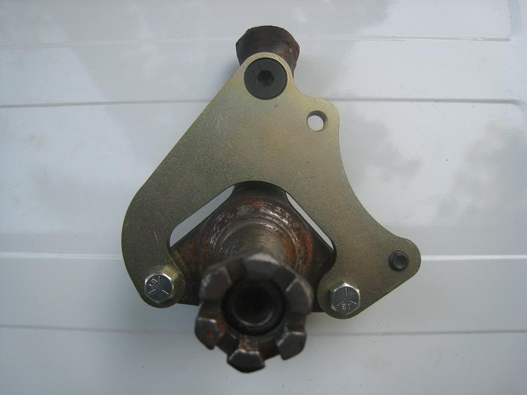

v8lrtorana quick question - this is a pic from ur photobucket -
that is the modifyed drum brake stub axles with the crs hq-wb caliper adaptor plate?
