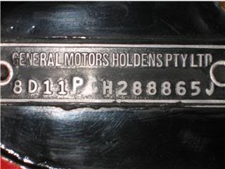

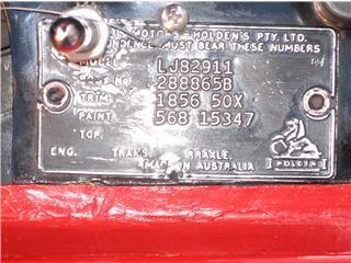

meanmachine72 its more than likely a typo error the car needs to be inspected if anyone is serious about buying itI would be checking diff and gearbox as this would givestrange vin tag appears to be xu1 but betsbac code on disc is not
an idea if car is xu-1..human error??? tag stamped wrong??
(like john gongs GTR)
76203C..GTR
77403E...xu-1
if human error..well one number maybe but three??? or
GTR with XU-1 options..the reason i say this is on page 163
of the antoniou book there is a service letter
SUBJECT: engine modifcations and idle settings
MODELS: TORANA LJ 82900 WITH XU-1
Iam yet to see a tag that says 82900
any ideas or a printing error???

thats right this car got me stuff? thats why i need some help guys. looks like up on the hoist to check diff & gearboxwhen one says to take a good look at the tags, with the vin tag are you saticfied that someone has not turned the l into a p ???. tony you have being wheeling and dealing in these cars long enough to know if this car is or is not the real deal.

much as i hate to admit it ,it is becoming very obvious that there is many flaws/human errors in the vin disc,i would look at the car first, if all is right , nos match/all the right parts in the right places, not a 's' reshell, then its a xu1,be a pity to have a genuine xu1 knocked on the head by human error/poor record keeping from years ago. cheers daz
Sorry but I have an issue with the theory of a "typo" that can turn 77403 into 76203 and thus create another xu-1 out of what is obviously a gtr. Yes the disc isn`t the bullet proof "be all end all" that some beleive it to be but REALLY come on that is a stretch.

ps and i has already said this twice check the vin ??? and after looking at a pic of the vin number that was sent to me by tonys2d, the p has bein tamperd with.

guys im not bombing the disc,there is not just 2 or 3 mistakes on that disc there is dozens of mistakes ive found on it, doubled up eng nos, eng nos next to the wrong chassis no and vice versa,im dam sure i wouldnt want my car knocked on the head by a typo,would you??. a mate of mine has put the vin disc in spreadsheet form alph numericly and printed it up, and filled in the blanks over the years,and agrees lots of holes.i know this disc is all we have , i use the disc as a guide also,but ignoring the FACT that it has lots of errors is counter productive.i fully support the fine toothing of a car , if between us supposed experts we cant pick a fake/genuine xu1 by now,were stuffed disc or no disc .much as i hate to admit it ,it is becoming very obvious that there is many flaws/human errors in the vin disc,i would look at the car first, if all is right , nos match/all the right parts in the right places, not a 's' reshell, then its a xu1,be a pity to have a genuine xu1 knocked on the head by human error/poor record keeping from years ago. cheers daz
ps spoke to tony last nite about possible previous owners of this car, being a brisi/sydney car ,i think most of you will know where im going with this,jeez i hate this shit ,hope it all turns out ok. cheers daz

its a mighty fat outer place p, dont we think.

no xu-1 stamped next to eng

Hey gong as if you couldnt tell that plate has been fuxxed with plates are gtr as to the car who knows until you look at ithere.
cheers john

Clearly different. Having said that - the one on the right is an Adelaide car.
