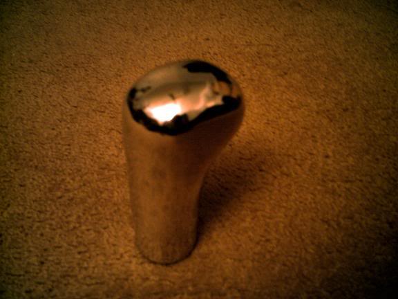

My polished grill I did using techniques from the quoted site. It's not perfect, but I don't think it's too bad.

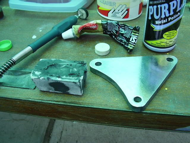

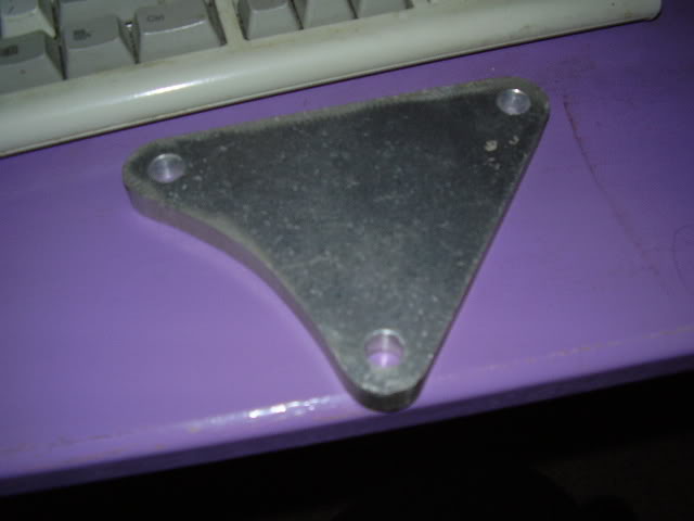

Here is my first serious attempt at polishing metal.
The item before:
And the item after 1.5 hrs (nowhere near finished yet.)
Jeremy spends hours doing this stuff and I can see why.
I dont have the high speed buffing wheels and pads that Jeremy uses and the tools I used are in the photo.
I wasn't aware that Jeremy had left his high speed electric drill at my place so tomorrow I will dig that out and spend an hour or more using it.
As you can see I have only just touched the surface on this yet and have yet to complete one side, let alone the back side and edges.
It's a bit of fun though.

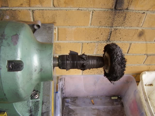

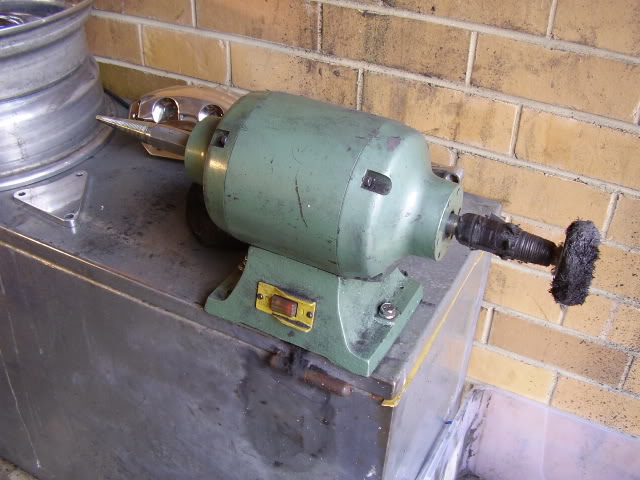

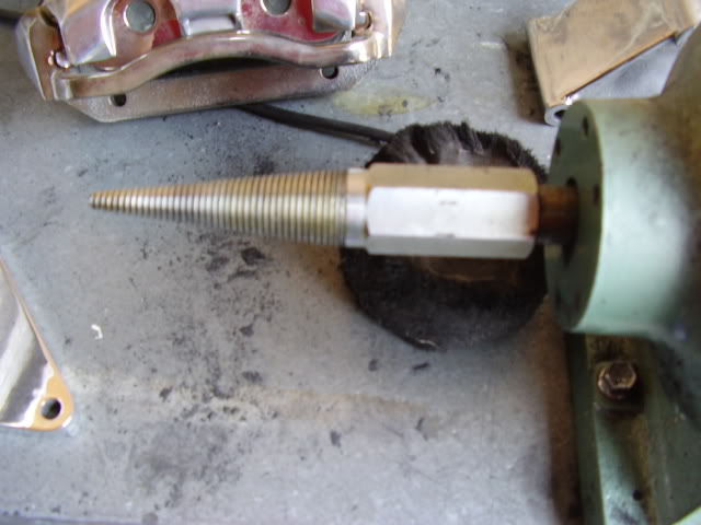

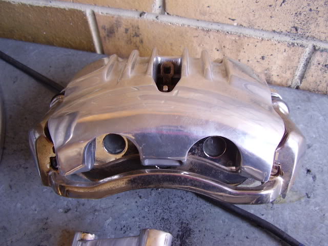

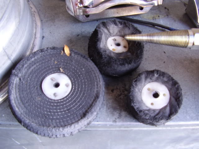

Posted 20 January 2008 - 04:31 PM
Hi guys,
I am posting this on behalf of Jeremy. he has been asked about the gear he uses.
All the above gear is available from Bunnings.
Here is a quick sample of some of his work.
Enjoy.

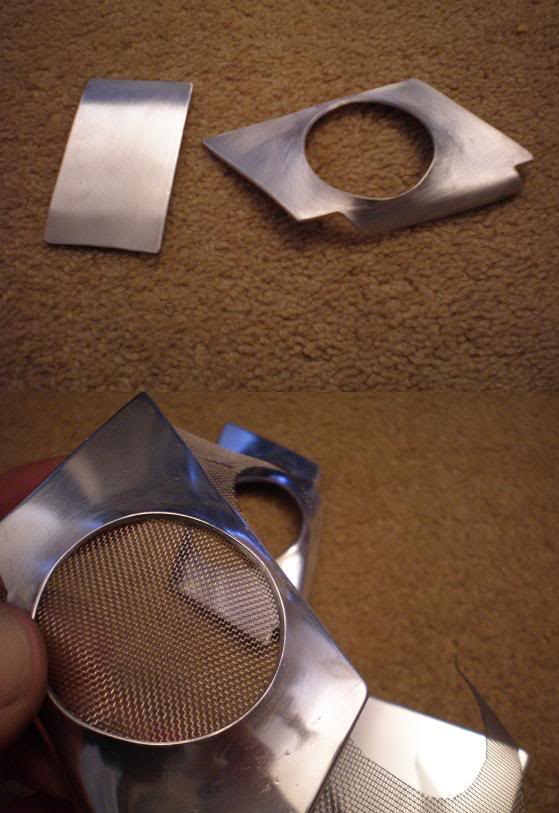

And I've been doing these..but they are a bit hard to get the wheel into.

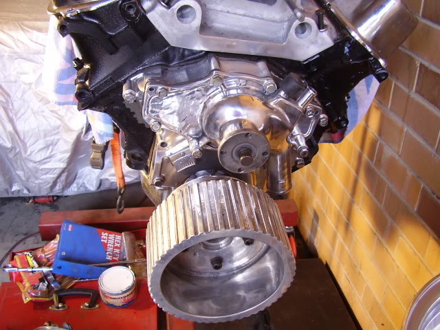

Posted 27 January 2008 - 03:15 PM
Hi Guys
More of Jeremy's work;
The water pump and heater motor covers are the latest. The Purple polish is getting a work out!
Note how the water pump has been de-veined before polishing - the ribs are missing :)
I think the polished water pump will suit the 253 I have, we are about to dress up it up and paint it before offering it for sale again.
More polishing being done tonight and we are working on the engine bay again tomorrow - Monday.

Posted 27 January 2008 - 03:48 PM
^ have you ran a pump with the ribs removed before? Does it create any problems?
I thought the 253 was sold?
#25 _Herne_
Posted 27 January 2008 - 04:35 PM
I had two 253's the EFI one sold, I still have the mildly warm 253 that came with my car and it has only 28k on it. It was poorly painted so I have half stripped the paint and now it looks awful hence it is being dressed up as it is a far better engine than it currently looks. And no the polished water pump has been run and probably wont be until the engine is sold and gets installed. I have seen polished water pumps before and have heard of no problems but should there be any chance of a problem I will include the orginal water pump as well as the polished one in the deal.
