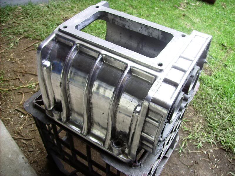

^ have you ran a pump with the ribs removed before? Does it create any problems?
I thought the 253 was sold?
ALX76 I have run a water pump on my old motor like this and have one for my new motor and it runs a 471 supercharger and have had no problems :spoton:
After all the water pump only job is to move water not cooling
Cheers, was more concerned with bearing failure with the ribs removed but you have had no probs with that.
I did cover the holes in the water pump so that no dust got into the bearing as for heat I was not worryed as they get hot all the time :spoton:

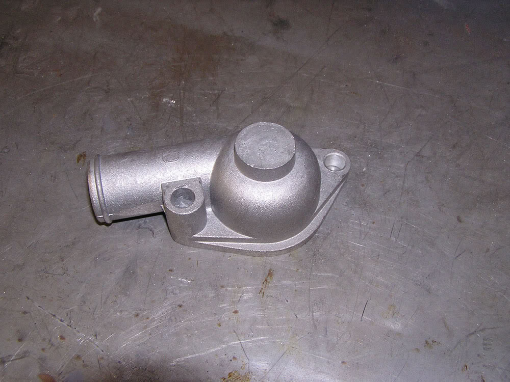

Ok guys, heres a quick tutorial of how to polish aluminium BOMBER STYLE!!!
Please note, although no explosives are used in the polishing of this aluminium, i still dont guarantee anything, read the disclaimer.

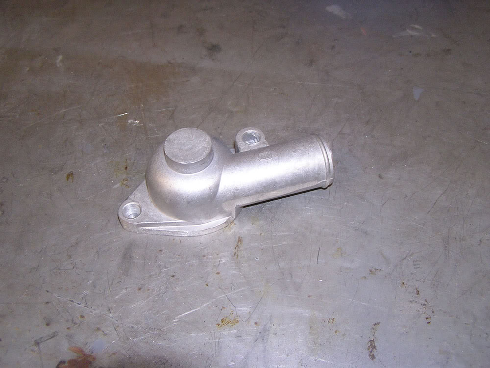

Ok, Start off with a nice brand new thermostat housing.

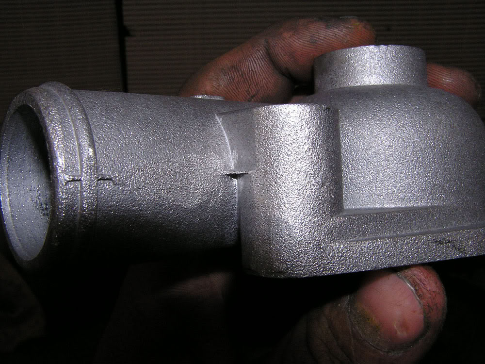

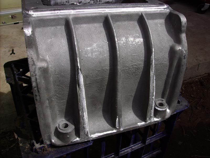

Take a real good close look at the job, and note any imperfections, casting flash pin holes, and things like that that wont look to good later. Heres a couple of trouble spots i noted.
See the casting flash in this pick, also notice how deeply pitted the factory cast is.

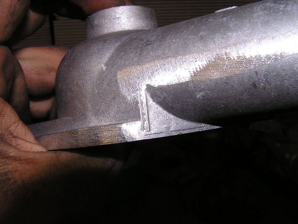

This bit Is also a bit of a problem area, although not as big. Strait out of the box it had these ugly sanding marks, aswell as a bit of flash here and there, this all must be removed.

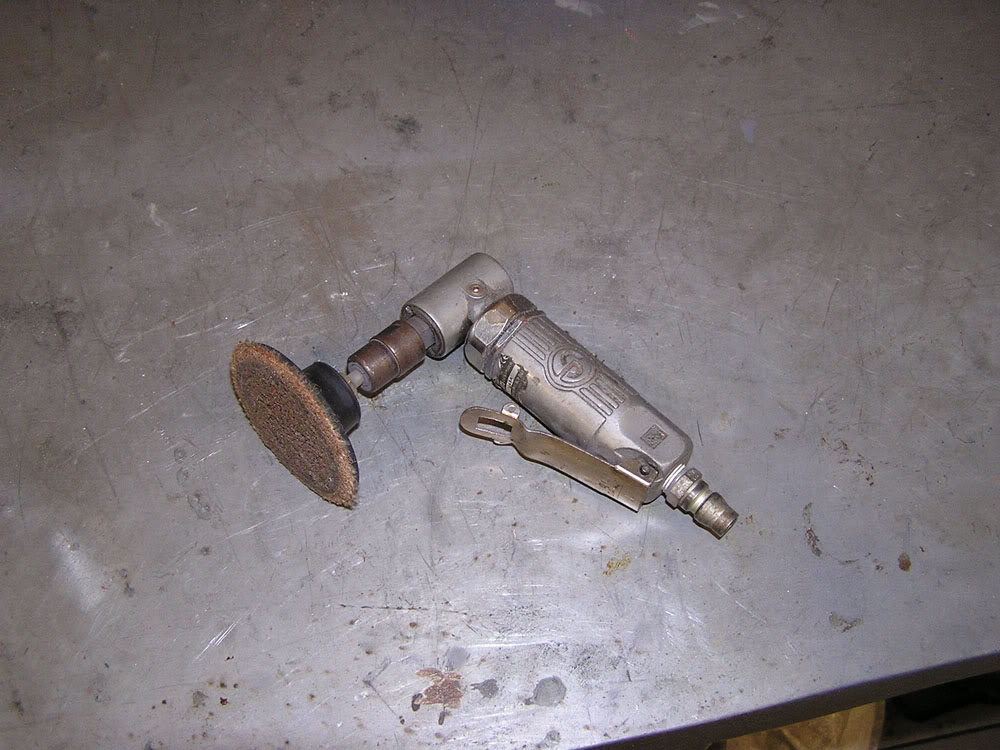

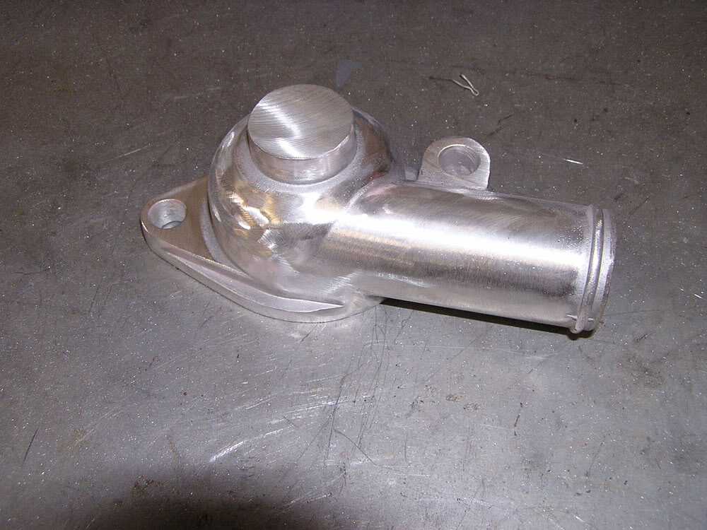

So first tool off the rank is my 3" air sander.
I started off with an 80g sanding disk on it, then went to brown scotch brite, then red. If i had a blue one i woulda used that to but im all out.

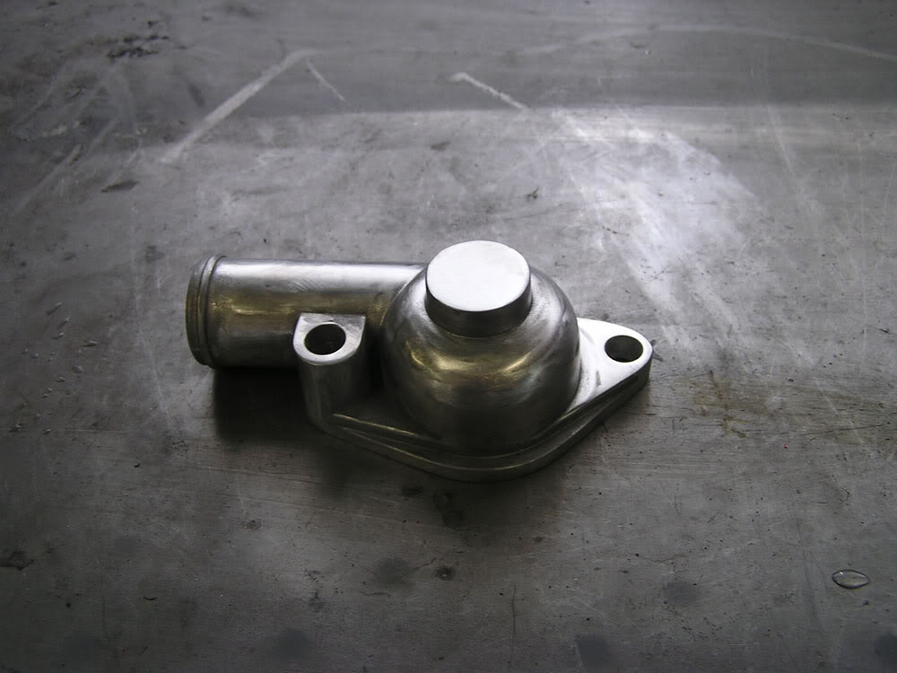

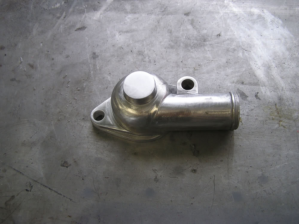

The 80g sanding disk was used to remove the casting flash i noted before, aswell as some other little imperfections. Then i used the scotch brite pads to remove all the rough cast finish so it was all nice and smooth, and looked something like this.

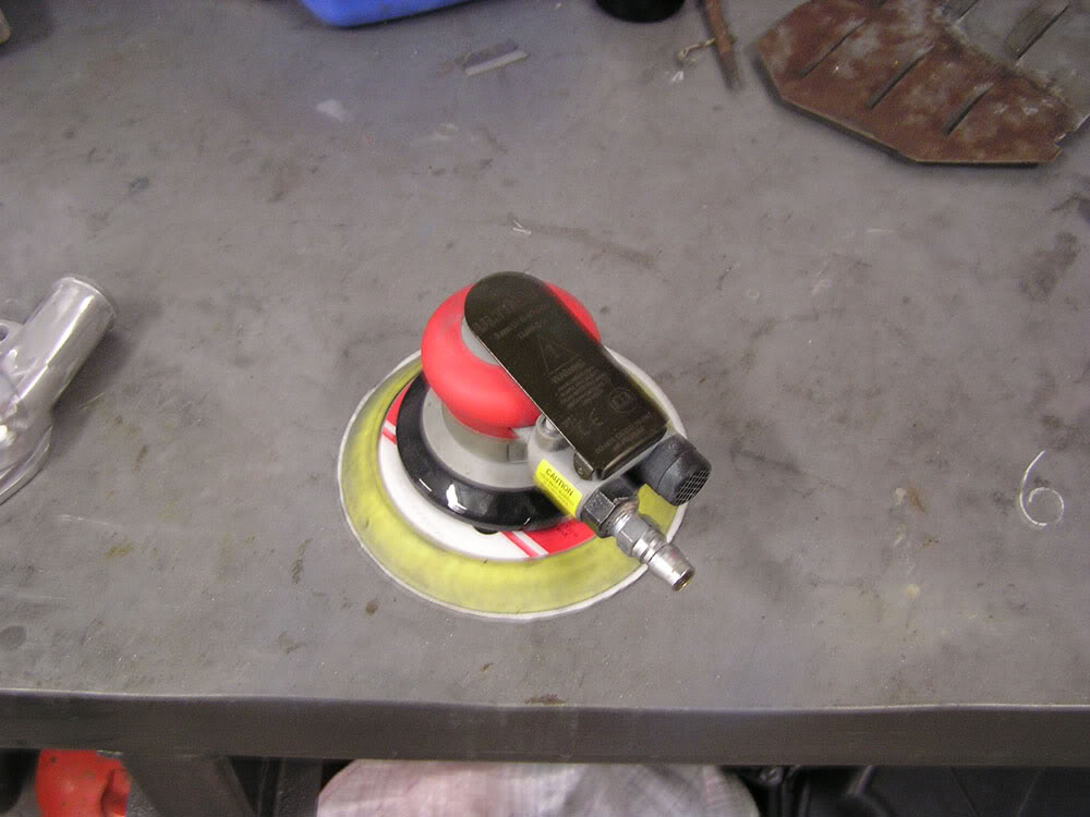

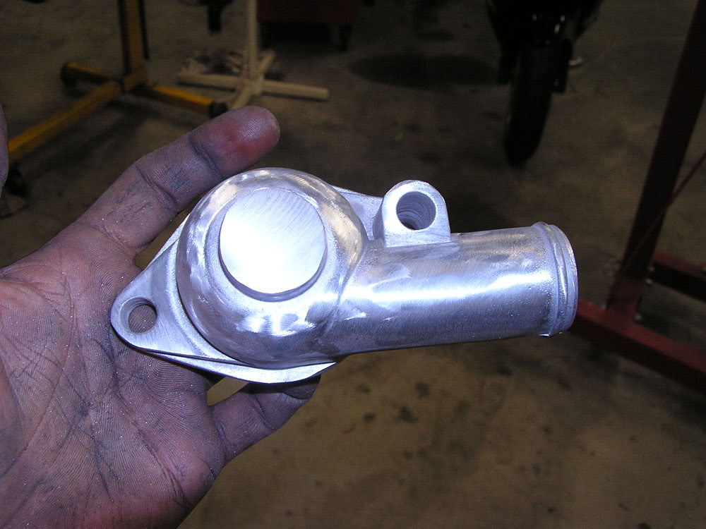

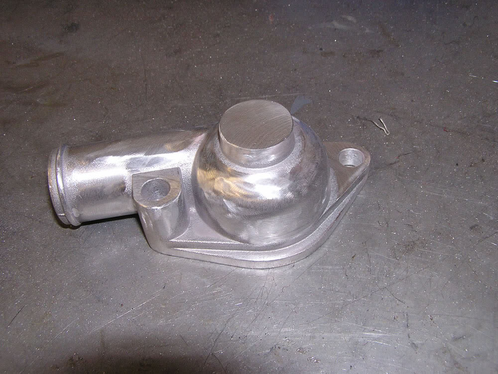

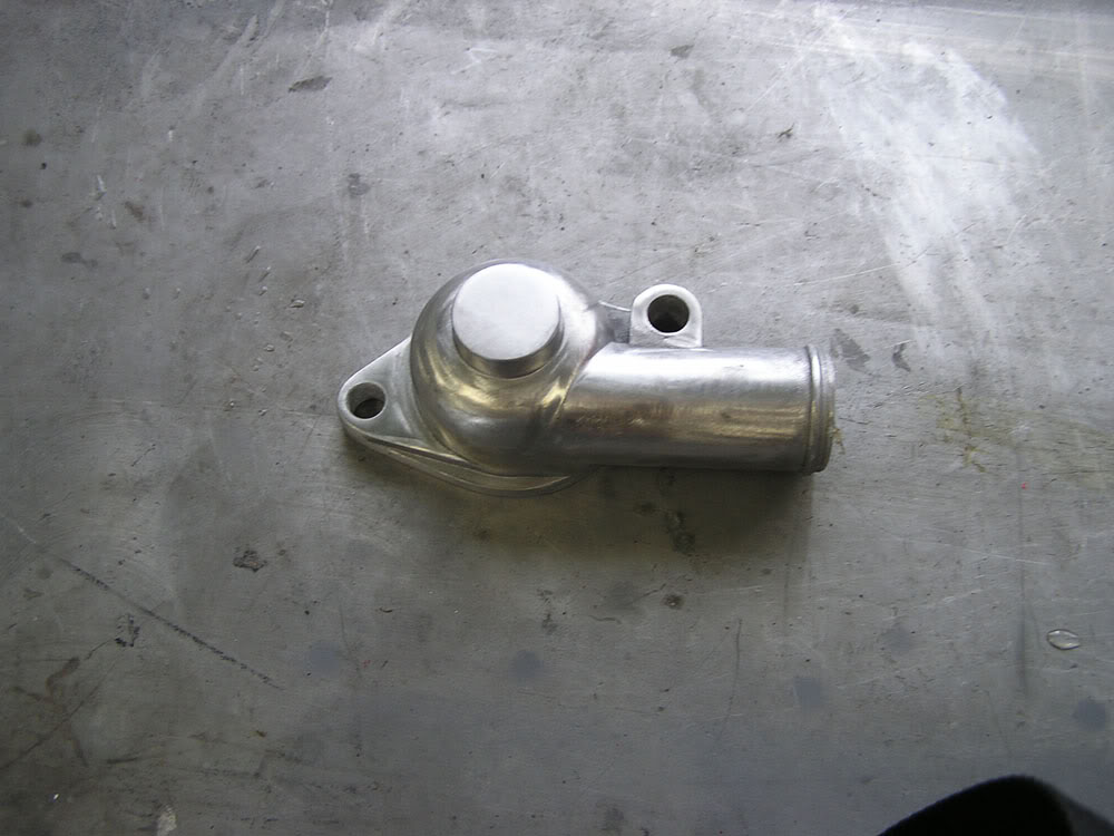

Next tool off the rank was my Handy Dandy 6" random.
I started sanding the Item with 180 grit, then went to 320 grit, then 800 grit. Make sure that you completley remove scratch marks from the stage before with each stage. So with the 180 you get rid of the scratch marks from the 3" sander, then 320 gets rid of the 180 scratch marks, then 800 gets rid of the 320 scratch marks. You end up with something that looks like this.

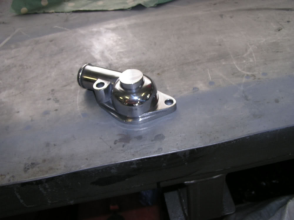

Next its time for the actual polishing.

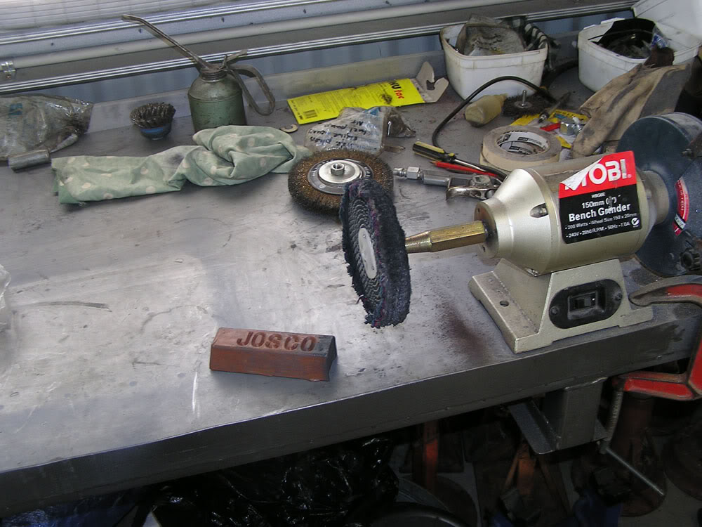

I just use Josco wheels on my 6" bench sander, everything you need is available from bunnings.

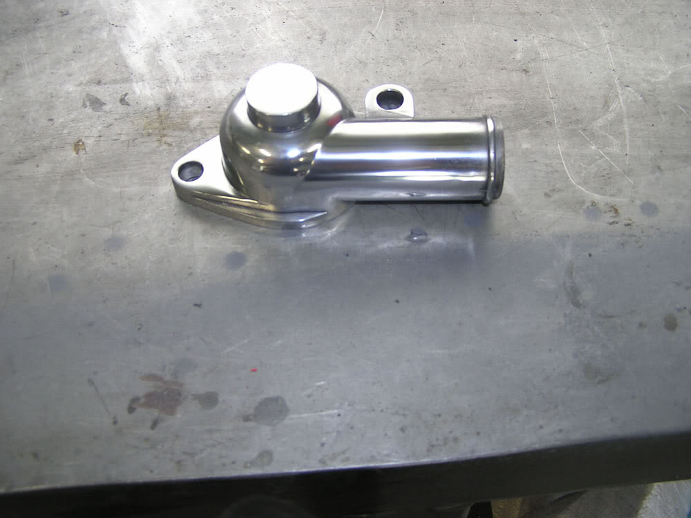

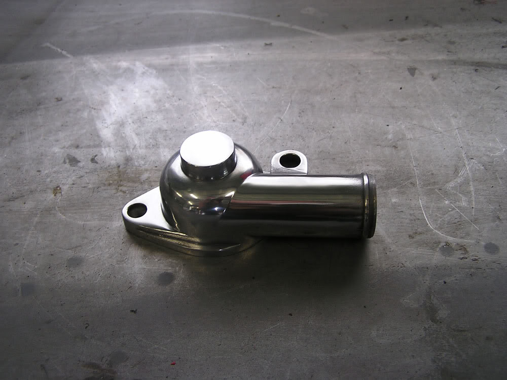

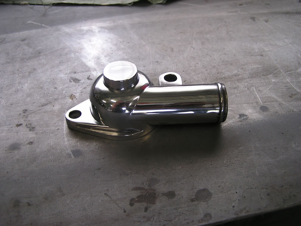

I start off with a T shirt material buff with the brown compound.

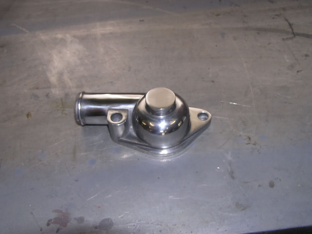

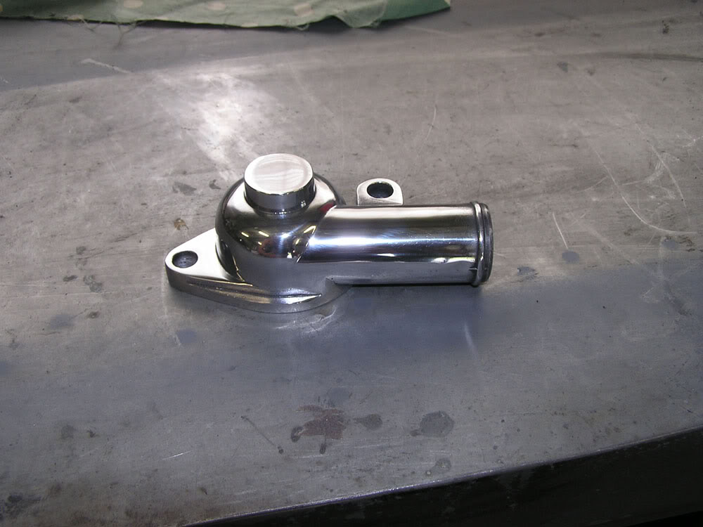

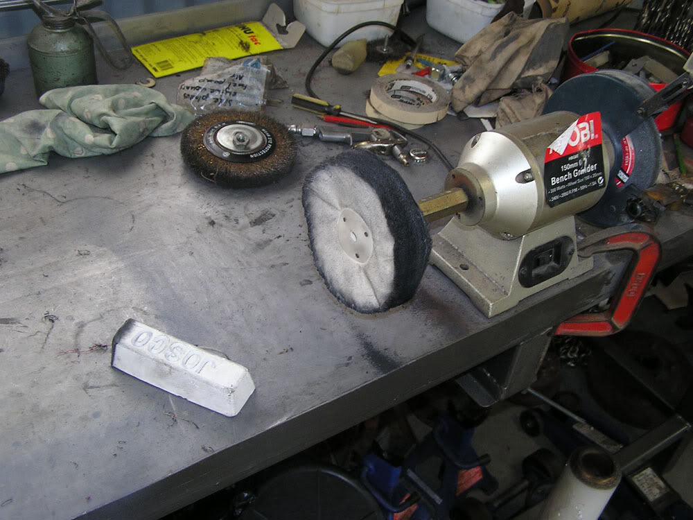

Then i go to a calico buff with white compound.
And there ya go. Pwetty, in probably a bit over half an hour and just about no manual labour.
