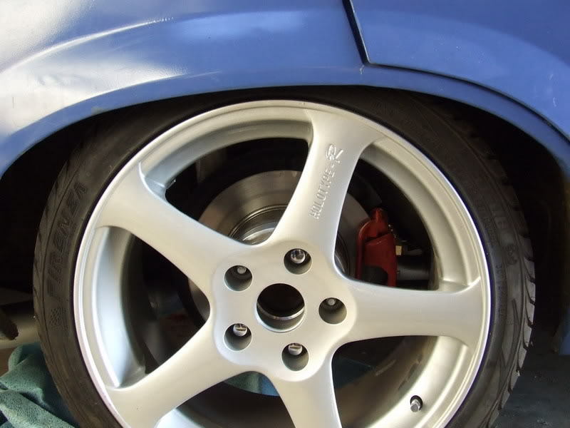

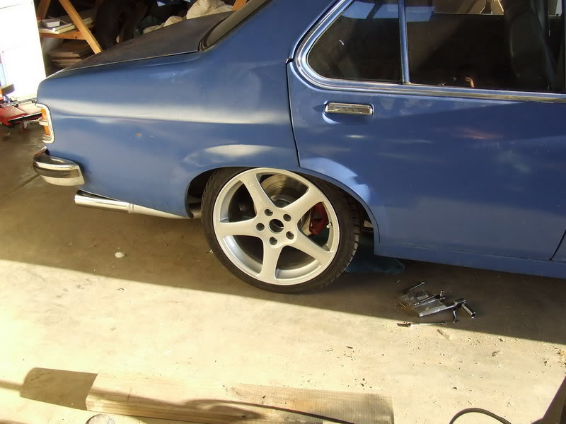

has any one got a measure with the camira springs in? like centre of rim to guard...

I don't have the measurements, but i do have photo's of my lx when i had 17's on + camira springs.

I think Makka said it drops the car 4" from standard
#20 _brett_32i_
_brett_32i_
Posted 13 November 2007 - 10:50 AM
no fair. they're my rims!
they look about 1/2" lower than my irs springs. so i reckon a set of those and insulator pads and i'll be fine.
How soft/hard are they?? i need soft to get traction. thats why the irs are no good.
#21 _rhysandhisLJ_
_rhysandhisLJ_
Posted 14 November 2007 - 07:13 AM
It's alright Brett, i've sold the 17's and are using stockies for my sleeper look!
The Camira springs are quite soft, softer than standard lx torana ones! The reason i have changed them over with custom lowered king springs is the camira ones were way too low. My cats were nearly rubbing on the road.
My king springs are still around 40mm too low but the car handles a whole lot better than with the camira ones in.
Rhys.
