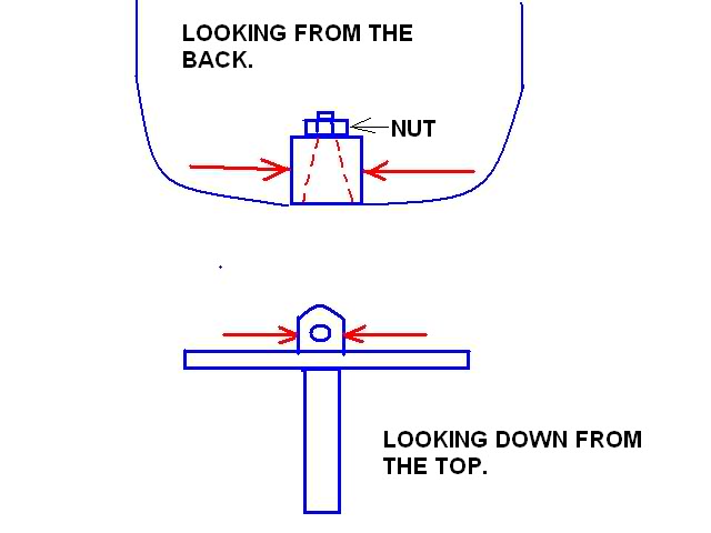

On the topic of 'lowering tricks'....im having a bti of trouble with getting the fronts out...at the moment im driving round like a muzza with the ass dumped and not the front :P lolol....its got king V8 lowered in the fronts which we put in but realised they were V8's, basically to get them in we just hamered the bottom A arm till the ball joint let go...but took agers n now wen we wanna put in 6 cyl lowered springs it wont budge!
Anyone got any tips to setting them free so that i can change em? Ive heard of ball joint breakers, but prefereably something where i dont have to spend any more money, we have been using a punch and a big metal mallot :<_<:

brad , if i understand your question you need to know how to break the taper on the ball joints?
dont whack it on the threaded bit
whack on the side to break the taper

yea im hitting it on the lower A arm just beside the ball joint...but yes, i have heard that they are tapered. So its just brute mallot-weilding force then?

No! Don't hit the control arm.
Jack the car up and put it on stands at the front.
Loosen the lower balljoint nut, 2 turns should be enough, but leave it on there.
Support one side of the stub with a hammer and hit the other side with another hammer. (Red arrows).
What this does in briefly distorts the tapered hole in the stub as you hit and the taper on the ball joint should let go.
Your spring is trying to push the lower control arm down at the same time, that is why you loosen the nut but leave it on.
Once the taper has let go, put you jack under the control arm under the ball joint and jack it up to compress the spring a little.
Now take the nut off and slowly let the jack down.
Good luck!

OHH! ....so knock it out of the taper, ill give that a shot, makes sense :)....ohh n thanks alot for the diagram, it really whips the laamas ass! ill let ya know how it goes, mid week this week we'll give it another go.

Have another read.
I don't think you get it.
You don't hit the ball joint.
You hit the sides of the stub where the ball joint's tapered pin goes through the hole in the stub.
#40 _Brad1979UC_
_Brad1979UC_
Posted 16 December 2007 - 08:40 PM
yea yea i understood....i realise its not a good idea to hit the ball joint. its the side of the stub that i hit?
#41 rodomo
Posted 16 December 2007 - 08:43 PM
Yes, support one side with a hammer head and hit the other side, kinda sandwich it.
