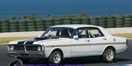

It looked like heaps of fun, and I decided I needed to get involved and I had this idea that I could go just as fast as him for a lot less money. Of course it had to be in a Torana, only problems were I had no Torana and very little spare money.
I can't quite bring myself to put a Ford picture here but if you click on the link, you can see Karls Falcon.
https://cache.gmh-to...fastlx/KWXY.jpg

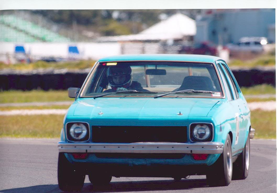

Chapter 2.
Now that I had been to the track, I knew what the major problems were. An overheating problem and bad oversteer.
Dollars were a real problem but around this time I bought a couple of UC Torrys quite cheaply and wrecked them out, selling the parts here and on ebay and so armed with some money I set to work.
I had rear springs out of a much heavier car in the LX, I threw them away and fitted a set of HQ springs. They were too long so I cut them and reworked the ends into the correct shape and got the car sitting right. I bought a big front sway bar from LXChev and re-fitted the rear bar. I fitted a CIG locker 3.36 diff to cure the wheelspin (DRCruz) out of slower corners and I bought a 3 core radiator from a forumer (Turbotorana?) for a ridiculously cheap price to get the cooling under control. I think I also fitted 14" rear tyres to offset the diff ratio change from 3.08 to 3.36
I had fitted a UC front end during the original build up, I made some spacers and managed to get about 3 deg neg camber. Measured with a builders level, a ruler and high school triginometry ! Couldn't afford a front end alignment.
I went to the next PIARC sprint in July 05 hoping to take about 10 seconds off my previous best time.
The car ran like a dream, no overheating problems, handling was much more predictable, so now I could concentrate on learning to drive on a race track. My best lap for the day was a 2.14 which although nothing flash, it was a big improvement over my first time.

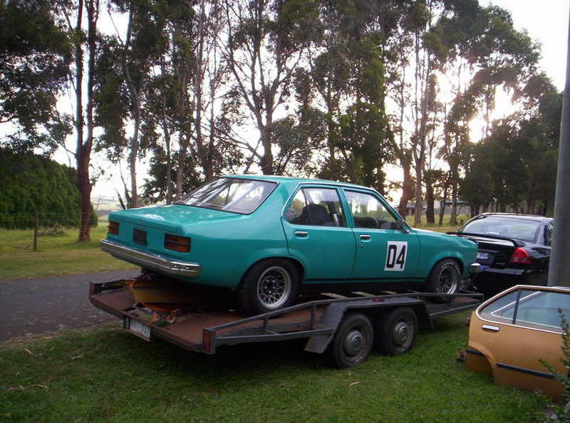

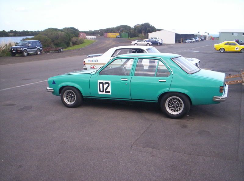

In an effort to make some more HP cheaply, I put a wanted ad on the forums, asking to borrow some triple carbies. A young guy about 30 mins up the road had a set of triple SU's sitting around so I bolted them on. I also cleaned out the front calipers and fitted new seals to try and stop one of the fronts locking under hard braking, and i fitted another set of supercheap autos front pads because the existing ones had worn on a weird angle and were almost worn out after less than 2 hours driving ! I had flat spotted a tyre due to locking a wheel coming down into MG lap after lap, apparently it looked good from the pit roof, I must have made a fair bit of smoke, so I threw another used tyre on the front, the canvas hanging out of the other one may have caused some problems at scrutineering.
So on 25th Sept 05 I headed back to the Island on a sunday. This time my laptimes would be on the internet for all to see so I had to show some improvement over my previous best of 2.14
On the warm up lap the brakes felt a bit dodgy but I pressed on, the car made a little more power in the top end with the triples and all was good until I arrived at the end of the straight on the first lap and the brake pedal went nearly to the floor. Scary !!!! My first 3 timed laps were 2.22, 2.20 and 2.19, not looking good so far.
I bled the brakes between sessions and managed to get a nice hard pedal. My next few sessions I got stuck in traffic, there were cars there like Honda Civics etc that could get away on me down the straights but then I'd catch them under brakes and they'd hold me up through the corners only to pull away again on the straight. The mighty 202 was pulling 5600 rpm in top gear down the straight, compared to 5200 with the 350 Holley so the SU's made a noticeable difference. I managed a 2.11 but I really wanted to do a 2.10 , so in my 5th session for the day I followed a damn Civic for a couple of laps then took a deep breath and passed him under brakes at the end of the straight and went on to do a 2.10.49 on my last lap of the day. This turned out to be my last lap in anger in the Torana, I sold it a couple of months later to a fellow forumer (V8racerchic). I don't know if she still has it or not, but if anyone knows the whereabouts of my old car I'd be interested to hear from them. I'd like to get a few photos of it if it still exists.
Someone asked me about the number 04, it was actually 02 the first couple of times in memory of my childhood hero - Kawasaki legend Gregg Hansford. On the day of the photo above, someone was already number 2 so I became 04, nothing to do with PB I'm afraid.

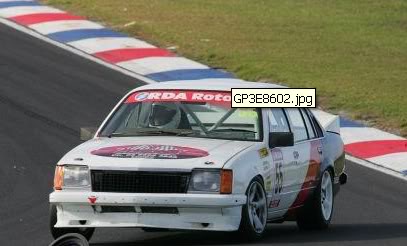

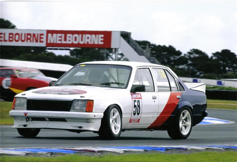

Here is a couple more photos of the Torana and one of the Commodore in the hands of the previous owner.

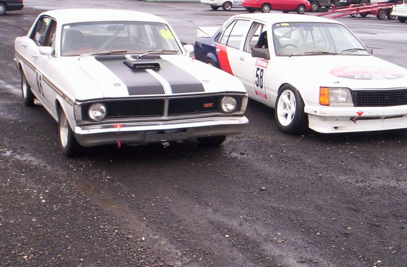

With all fingers crossed it was back to P.I. on Sun 7/5/06, Kark bought his XY along which was the first time we had been on the track together. It was the most fun I'd had since i started. Being able to race with a mate in similar speed cars was so much fun. His Falcon had a little bit more grunt on the straights but the Commodore was better under brakes and through corners.
Our lap times were almost identical, i was a little faster on the wet track early but as the track dried he set the faster lap for the day 2.03 v 2.02 if I remember correctly, its all on the PIARC website if you're keen!
