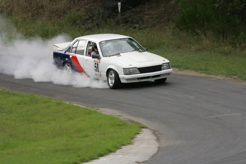

Mmmm, was I putting it on for the camera or was I just trying too hard ? Maybe this is the cause of the understeer, the front tyres weren't turning !!

#68 MRLXSS
Posted 10 March 2008 - 09:54 AM
Awesome pics!!!!

Mick, if it ever happens that we're on a circuit together, remind me to keep out of your way. :blink:
#70 Heath
Posted 10 March 2008 - 08:32 PM
I'm still trying to figure out if they are Morwell or somewhere I haven't been before... Second pic is ace lol

MRLXSS - Obviously I didn't take the photos, there was a photographer there, He came around before it started handing out brochures, he said each time we went out, he'd take 3 or 4 photos, the cost to buy a cd with all our photos was 22.50 which I think is a bargain, obviously those 2 are the best photos,
Rodomo - better not line up next to me at Calder then ! In the 2nd shot, i knew the photographer was there, so I stood on the loud pedal and got a bit of sideways action happening, I'm happy with the result.
Heath - Yeah its Morwell, 2nd last meeting on the old track. Last weekend.
