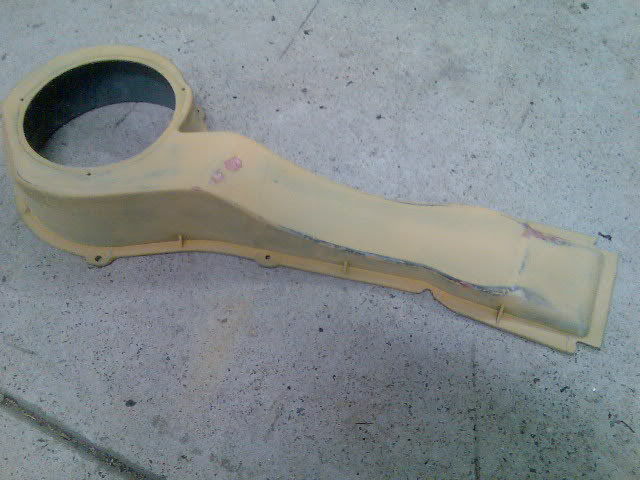

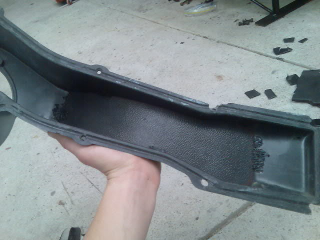

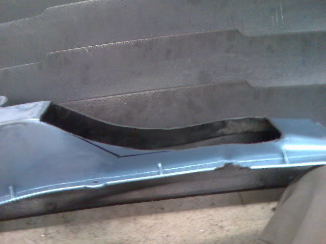

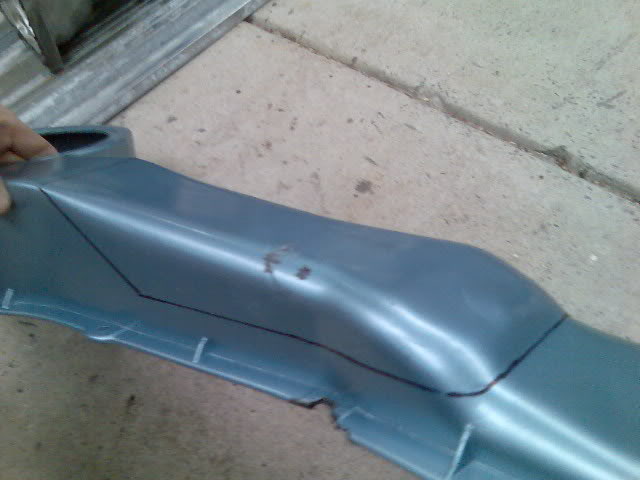

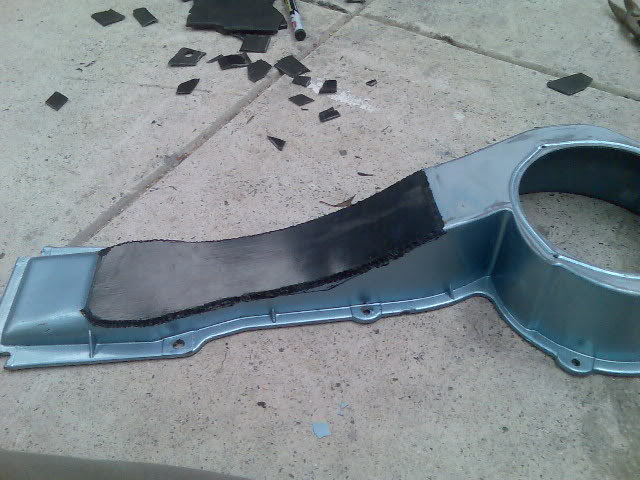

got to work at my heater box! haha we spent like 30mins just trying to get it out! luckily i slotted the rear holes anyhow heres what ive done
marked where i wanted to hack

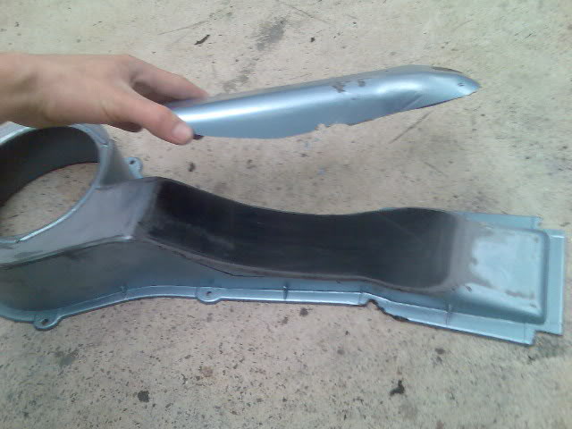

decided to make it more of a curve heres it cut out

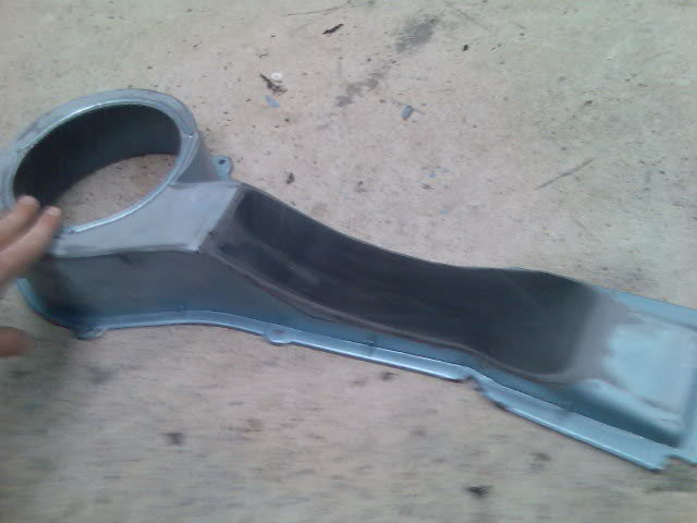

chopped up a piece which fits nicely and melted all the edges with a soldering iron making sure it mixed with both sides!
then did some tacks on the back for extra strength
filed the edges and ended up with this
here you can see the difference

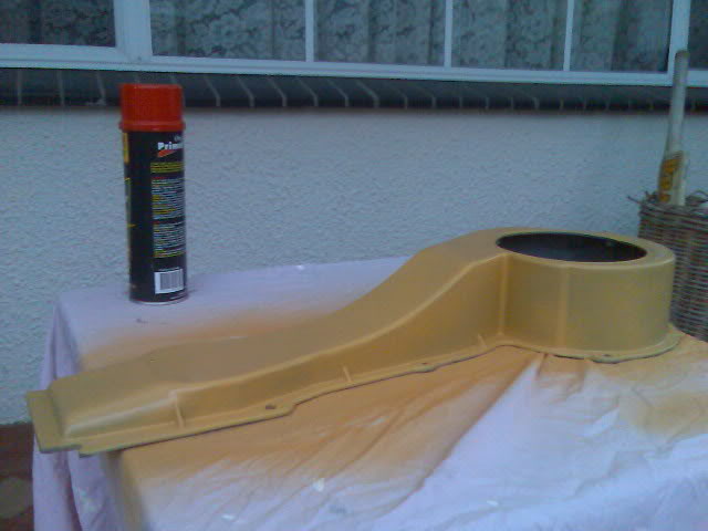

used some spray putty to fill any imperfections

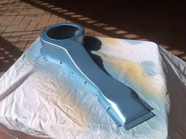

and its now ready for paint
took the pics as thought some might be interested! it is turning out really well should look great with paint i guess

That's the stuff mate :D There's $400 saved that you don't have to spend on a modified heater box :spoton:
#330 Heath
Posted 31 August 2008 - 01:21 PM
That is a neat repair. Well done

dam straight tim!

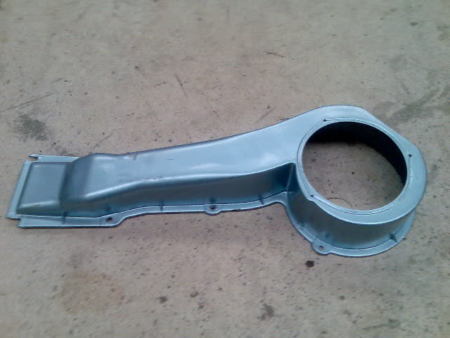

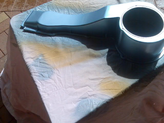

well its done! heres what she looked like before:
and now
very happy with the way it turned out!

Good job, well done
#333 rodomo
Posted 31 August 2008 - 01:25 PM
:clap:
Where did the donor plastic come from? :huh:
Looks like back window louver

my rear window louver which came with the car :P it was cracked so thought why not! and it was the same thickness too!

thanks mate! will make the engine bay a whole lot neater too as the leads can go around the back of the motor on that side now!

Very tidy job of the fan box mate, I done a very similar job on mine for the injector rails to clear, A mate was gonna fab me one up from alloy sheet but i decided to stay with the original look just sprayed it 2K gloss black.
IMO $400 For a modified box is ridiculous, for the sake of an hours work.
Keep up the good work dude :spoton:

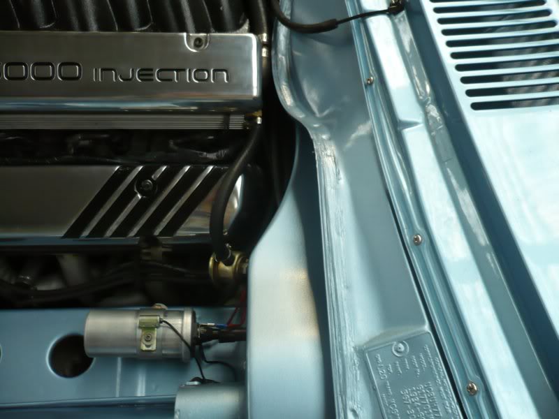

heres how everything sits now its all back in and shiny again :D
Note in the first pic the pipe to my new hidden air box..
I just have to mount the fuel regulator and its all done...

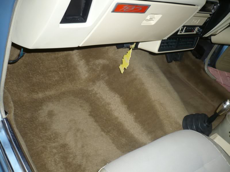

hey guys small update i bought and installed some new carpet on the weekend probably took a total of 5 hrs to remove the old and put in the new heres how it looks now!
im fairly happy with the new colour too matches up nicely although in the picture it makes the dash look heaps lighter than it is :D
i also bought carpet for the hatch area wheel arches and backs of the seats looks very neat now. just have to make up some new kick panels and it is done!

Holy shit that looks good!!!
Nice work.
#348 TerrA LX
Posted 22 September 2008 - 06:38 PM
Very nice work there mate :clap:
