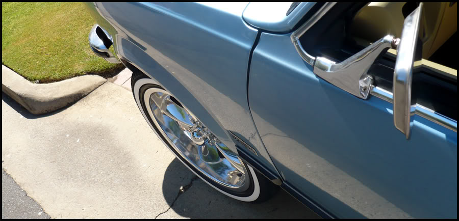

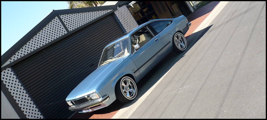

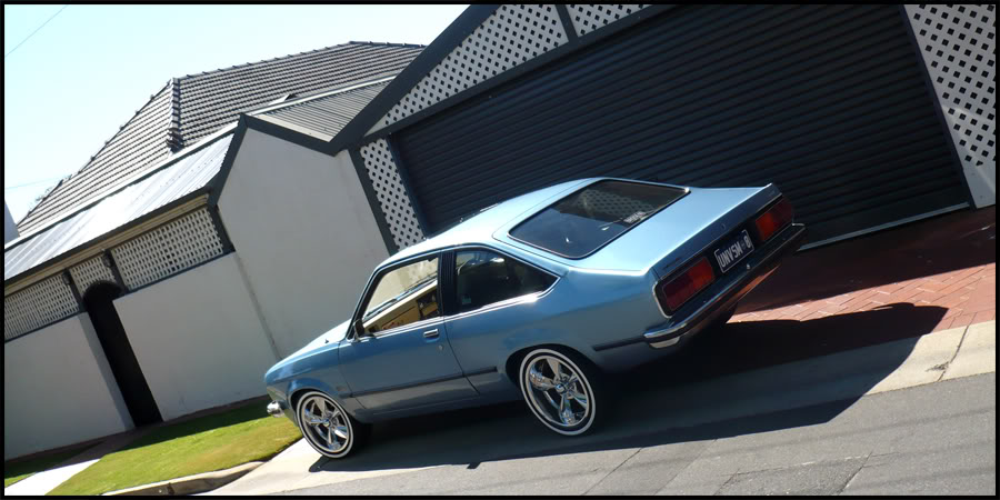

Hey guys well finally got some decent pictures today after getting my whitewalls done! tell me what u guys think personally im in love hehe

The wheels look great with the white wall tires. You have done well.

Cheers mate i'm very happy with them!

Looking good mate! I reckon you need to lower it more though!! Get those wheels and tyres tucked up into the guards!

i would lower it more but at the moment the exhaust goes over the diff and as it is with people in the back it bottoms on the diff so i'll have to get that changed.. but the back definately would look better lower...

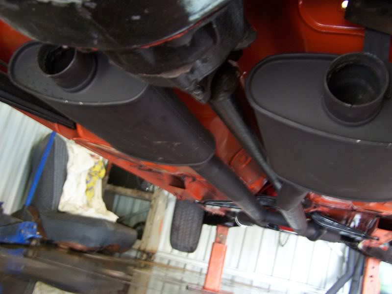

hey
go and ask a mechanic to get out his roadworthy book and get a photo copy of it ,
I asked a local mech and he said "exhaust had to be past last opening window"
when we looked at updated rules they say "40mm behind last floorpan weld"
he then said mine will be fine (dumped at diff)
it now has little elbows after the mufflers. AND SOUNDS GREAT
Cheers Baz
