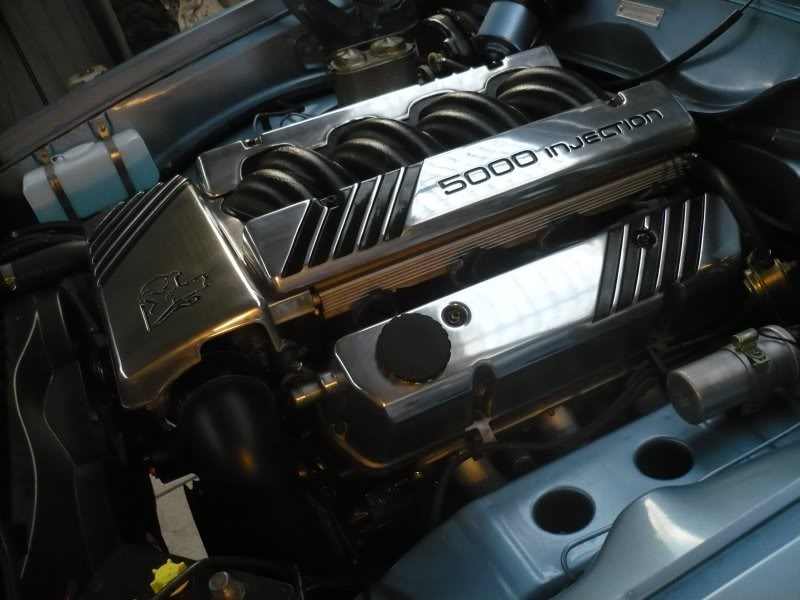

#546 _Baronvonrort_
_Baronvonrort_
Posted 14 August 2009 - 06:27 PM
I think thats the best looking "standard" injected holden engine i have seen.

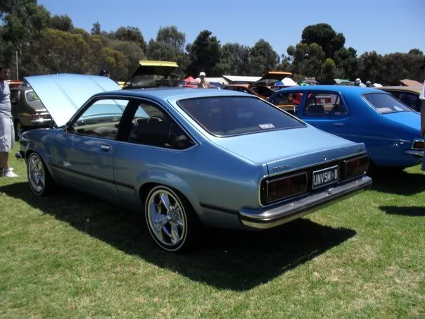

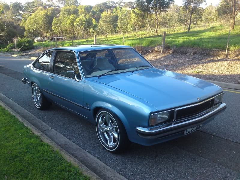

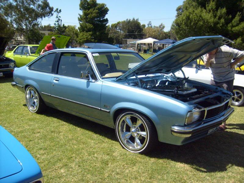

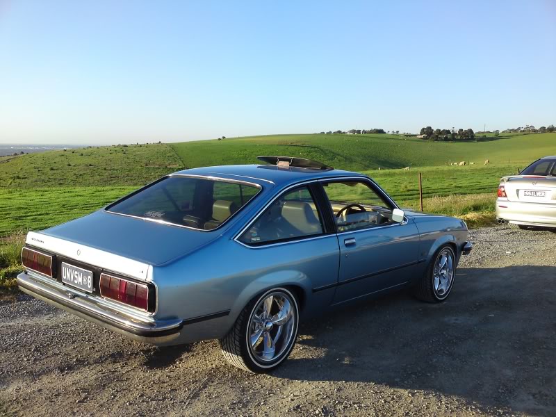

_UNVSM8_
Posted 10 November 2009 - 09:32 AM
Well it has been ages since i have updated this but seeing as i entered my car in All Torana day here in Adelaide i thought i'd post up some pics

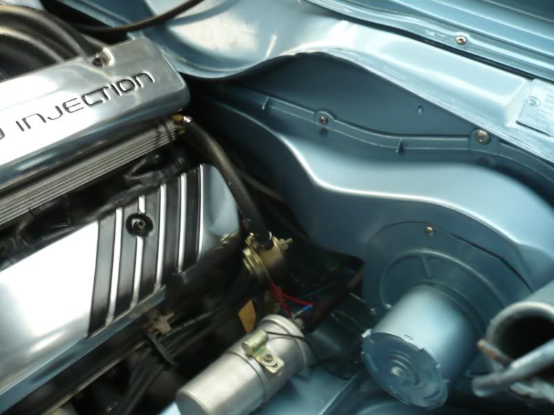

Not alot has happened with the car since last time i have however changed the springs again to re-compressed king springs which brought the back down some more and have made the ride not so rough now
I also made up a breather for the diff as it kept leaking oil everywhere from the standard breather. so with about 20cm of hose and a fuel filter i have sorted out that problem :D
Other than that i have just been driving her daily and making the most of it!
In the next few months im saving up for some new shockers, front brake upgrade getting my seats redone and some new injectors i'll be sure to keep u guys updated!
Anyways heres some pics:
(thanks to Kaz and Laurie) :D
Oh and i also scored runner up modified UC at All Torana day and got a trophy :D absolutely stoked :rockon:
