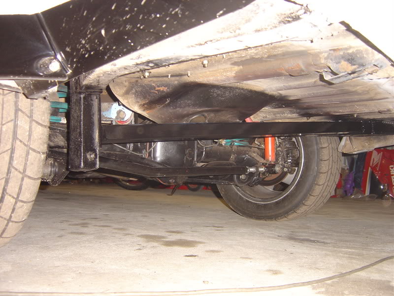

Here's my effort.
#127 _brett_32i_
_brett_32i_
Posted 04 April 2008 - 02:15 PM
you might need to put a bit of brace on the body mount? maybe diaganol, or run a bit of flat bar on its side from the top of chassis rail down past the join a few inches. does that make any sense?

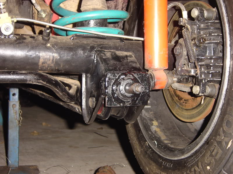

#129 _rorym_
Posted 04 April 2008 - 03:18 PM
and the nolathane upper bushes are going in the bin right?
Nope....just spares.
#130 _moot_
_moot_
Posted 05 April 2008 - 06:35 AM
heres mine
#131 _rorym_
Posted 05 April 2008 - 06:48 AM
It was actually Moots example I used with the first pickup point on the diff housing.

#133 _LXChev366_
_LXChev366_
Posted 06 April 2008 - 03:57 PM
Moot's one above is close to what mine looks like except the RH bolt mounts onto the axle tube to the right of where ^ his coilover shock is.
#134 _brett_32i_
_brett_32i_
Posted 07 April 2008 - 04:41 PM
moots chassis mount looks a lot better. is that a mcdonald brothers kit?
#135 _moot_
_moot_
Posted 07 April 2008 - 05:16 PM
yeah it is but its slightly modified.i highly recomend them

Posted 30 October 2008 - 06:35 PM
The final result.
