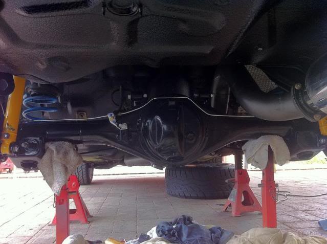

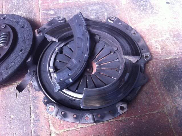

Wow March already. Took the Gem to motorvation and had a great time But I blew the diff and the clutch at the same time :S
New Clutch Thanks to Neil
Had been collecting bits and peices and working out how im going to do it for awhile but figured it was time to get the Hilux diff conversion done. Is mentioned a couple pages earlier but since the Gemini have a Torque Tube and no upper trailing arms standard I had to design and make a new way to locate the diff from scratch.

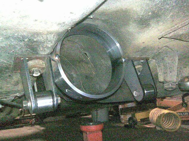

This is the first main part of the conversion, Custom front crossmember which bolts to where the stock torque tube used to mount and it provides the mounting locations for the upper arms to the body.

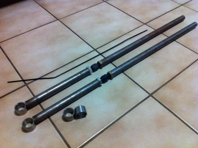

Next were to make the custom arms, I got the parts from Mcdonalds Bro's, worked out the exact lengths and angles I needed them gave them to Embleton Engineering for him to bend and weld on the bush ends.
The black peice of wire near the top was my Dummy arm which I cut to length and bent to shape and what I told Embleton to make the arms as.

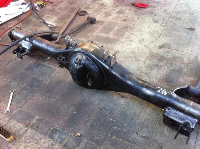

Sent the Hilux housing and my Gemini housing to Final drive for him to weld on the Gemini lower control arm mounts, shorten the diff and put Holden ends on so I can use my VN-VS commodore rear disc setup, also order Custom Moser Axles from Phil
I got the housing back and welded on the upper mounts
Then got the completed arms back from Embelton
Test Fit time:

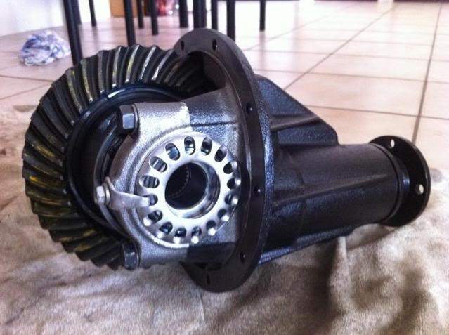

Also picked up a Detroit Tru-Trac Center from Ebay, brand new still in the box for $500, cost me $300 to have it setup and fit to the front carrier with new bearings and everything
Got everything powdercoated

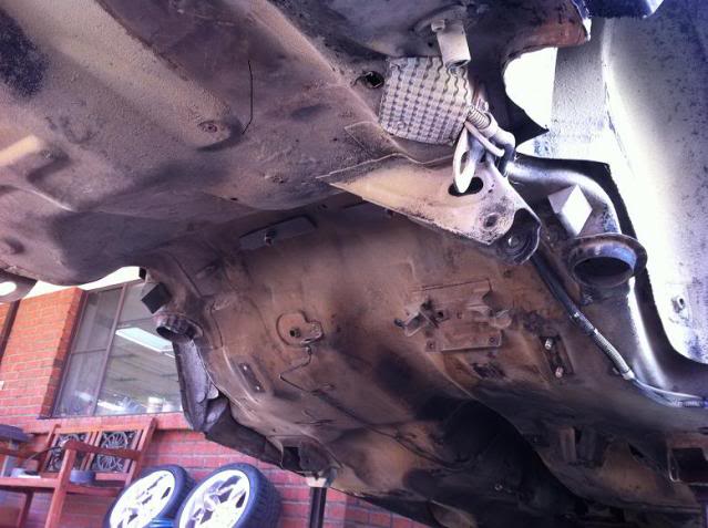

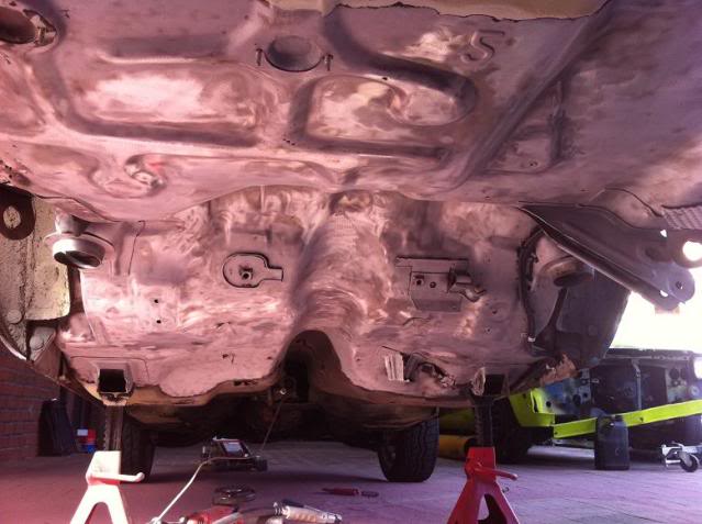

Now since I had everything stripped from the rear end and I didnt get a chance to when I painted the car I decided to strip the floor back to bare metal and paint it, nothing too flash just nice and neat, used a combination of wire wheel on the grinder and a little sandblaster I have.
Before:
Metal:
After:
Only did the back half of the car as ill do the rest when I pull the motor out next.
New tailshaft and Axles finally arrived
Stock Gemini 23 Spline vs Hilux 30 Spline
All done! Well almost goto finish fitting brakes
Went for first test drive not long ago, Was so nice to go around a round-a-bout and not have the locker jumping about... Everything felt normal, but the diff center was making a little bit of noise, mainly during part throttle... I dont know if these need to be run in? or whats the go, gonna speak to the guy who set up the center for me and see what he thinks. Have not tested the LSD fuctionality yet (done a skid) due to the noise and wanna make sure everything is right before I give it too much of a hard time.

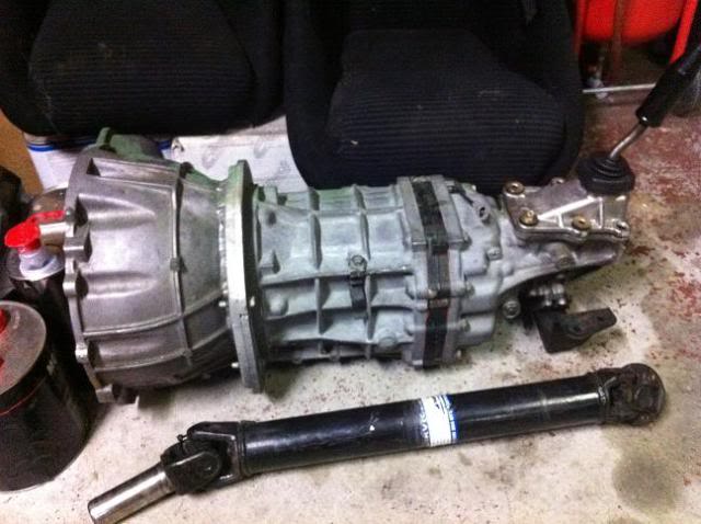

Anyway what Im trying to get at is I bought a New gearbox
Its the Big Supra 154 Box thats usually behind the 3.0L Turbo motors and apparently handle big horsepower. This one has had a Rodeo bellhousing modified and bolted on so it will fit behind a 4Z motor.
Gear rations seem nice too with a longer 1st and 2nd gear and Much longer 5th which will be great for cruising
First Gear: 3.250:1
Second Gear: 1.955:1
Third Gear: 1.310:1
Fourth Gear: 1.00:1
Fifth Gear: 0.753:1
TF-TG petrol 5 Speed
3.790:1 - 1
2.175:1 - 2
1.417:1 - 3
1.000:1 - 4
0.855:1 - 5
3.826:1 - R

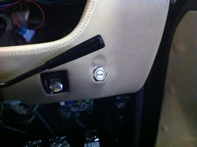

Fitted my new custom Starter switch
Speaks for itself really...

And I also picked up my Supra R154 gearbox from S&G which I had them rebuild with some upgraded goodies inside.
