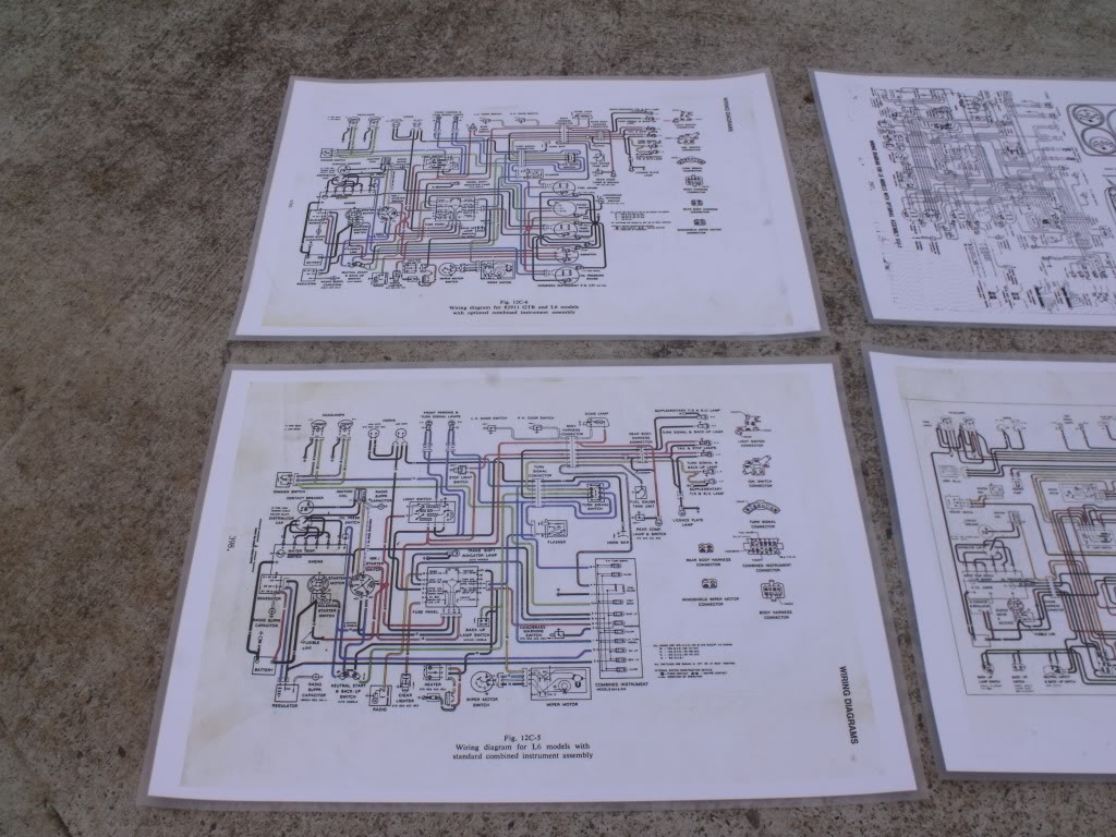

Does anyone have a wiring diagram showing LX dimmer switch wiring?
The microswitch on the blinker stalk has 3 terminals but I only seem to have 2 wires (and no lo beam)
#32 mika03au
mika03au
  • 812 posts
  • Name:Michael
  • Car:LX hatch
  • Joined: 06-July 11
Posted 10 May 2014 - 05:14 PM
Only two wires on the column dipper switch.
Item 11 on the attached diagram.
