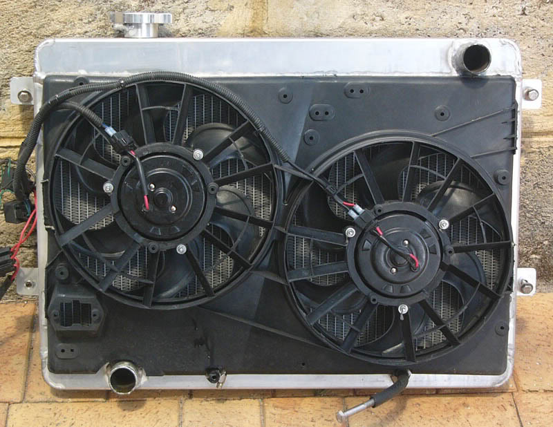

Mondeos.They fit perfectly over the core only on a torry rad.400x620mm are the dimensions.
#32 ls2lxhatch
Posted 12 May 2008 - 01:45 PM
Ford Mondeo fitted to LX Torana radiator.
