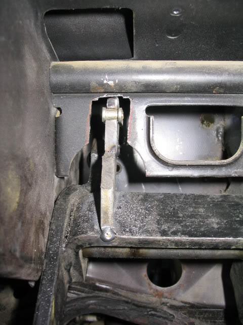

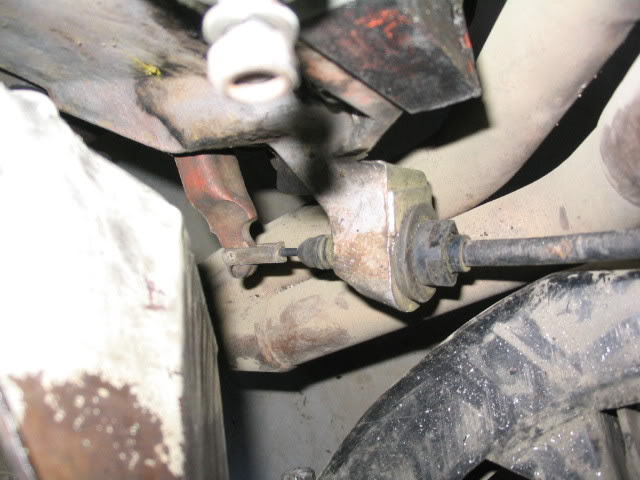

Posted 24 May 2008 - 03:53 PM
how do i know when i have fully disengaged the clutch itself?
Heres what I've been mucking around with today:
How'd i do? Clutch pedal is to the floor in the pictures, and at rest it sits flush with the brake pedal.

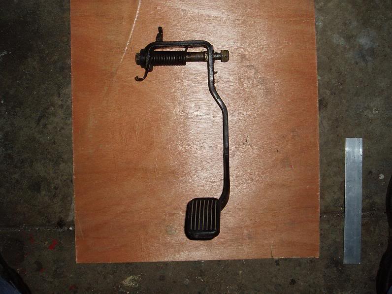

Sorry for the late pics, I see you have it just about worked out but these measurements might still help?

Hi rodomo
Is that a pic of a unmodified pedal before the hook is lengthened.
#17 rodomo
Posted 25 May 2008 - 02:36 AM
Yes.
Standard UC pedal.

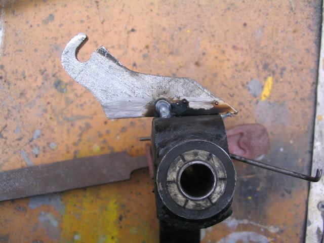

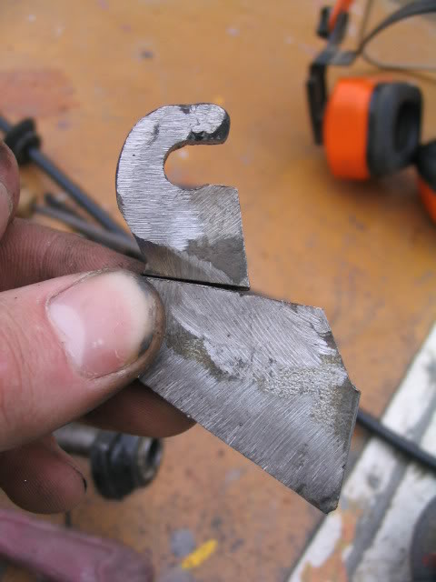

#21 toryman76
toryman76
  • 1,082 posts
  • Location:Melbourne, Vic
  • Joined: 16-January 06
Posted 25 May 2008 - 03:39 PM
heres the first one i made, looking pretty messy:
and heres the result. hopefully this won't need any more adjusting and i can fully weld it on. but i will hold off on that until i get a new clutch:
This has been done using the late HZ cable with the 'screw' done on the bellhousing. I hope this can be of use for others wishing to do something similar :rockon:

#22 _Toranamuk_
_Toranamuk_
Posted 25 May 2008 - 09:13 PM
Your pedal mod is fairly close to what I do, & up under the dash you've cut the right piece out, later if you clean it up with a die grinder just for cosmetic appearance & to avoid cutting yourself later.
By moving the pedal hook forward (like the HZ type) you may run out of cable adjustment, I just lift the original hook up 25mm, this leaves a greater gap between the firewall & the hook & seems to put the cable adjusting nut (at the bellhousing) in the middle of its range.
By the photo's your probably 25mm further forward with the hook than you need to be.
Well done on your mod & glad you've posted some pics for others to see.

#23 rodomo
Posted 25 May 2008 - 09:18 PM
I agree, compared to the earlier UC pic, it looks too close to the firewall.
