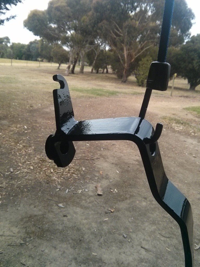

The hook that i have made up was not copied from either of the H-series pedals i have here, it was more just make some and see what works. I have moved it closer to the firewall as well as up because thats how far the cable came through the firewall to enable the pedal to sit flat with the brake pedal. If i had of simply just added the 25mm up on the UC pedal, then my pedal would have still been sticking up about 2in from the brake pedal.
So from all that i gather the UC cable must be slightly longer then the cable i have from the HZ?
With the adjusting nut, how do i know when the cable is adjusted correctly?

Adjust the pivot in the bell housing to the middle of it's adjustment.
Adjust the cable to the middle of it's adjustment.
Hold your clutch pedal level with the brake pedal and have another look at where your hook is on the pedal.
UC HATCH, we meant that the hook looks too far forward.

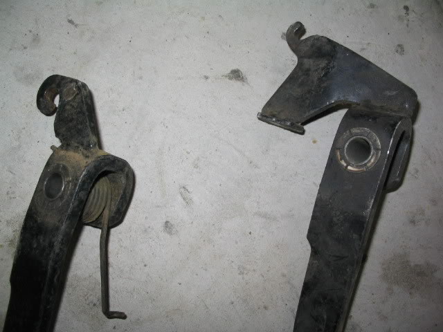

The one on the left came with my full cable setup believed to be out of a HZ. Notice the reverse hook, the cable doesn't come off when operated.
The one on the right came with my engine and gearbox believed to be out of a HJ or HX.

The left one is a full cable (late HZ or WB) - might be a 6cyl (would have to get a pedal out and compare). The right hand one is a HX or early HZ with half cable half rat-trap. In my description I described the direction in which the hooks faced back to front. Toryman, if you put those 2 x pedals side by side and they end up the same length from pivot to pad then the left hand one is a V8 pedal. If it's longer than the right hand pedal it's a 6cyl one.

both pedals are the same length
#36 yel327
  • 13,975 posts
Posted 28 May 2008 - 07:59 PM
It's a V8 one then. Pretty rare. It's what you need to convert any HQ-WB V8 to full cable setup and get rid of the horrible half and full rat-trap setups.

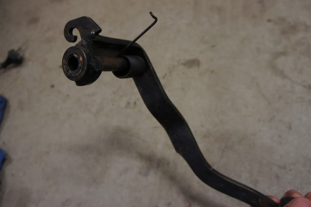

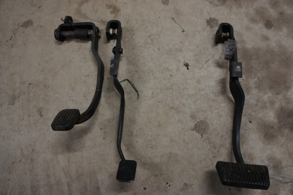

Whilst I was doing a search, I came across this thread - heaps of good info however could someone please advise me if I am on the right track or not..
I am in the process of doing a manual conversion (was an auto) in my LX sedan.. V8 with a singlerail gearbox. I have finally found a UC clutch pedal, but the length doesn't seem correct.
In this picture - the pedal on the left is suppose to be the UC clutch pedal, the pedal in the middle is suppose to be the UC brake, and the one on the right is the auto brake pedal that I removed from my torana.
Heres a closer look at the UC pedals..
As you can see, the UC clutch pedal (?) is alot shorter than the others.. is this normal, or could this be from a WB or something?

Those pedals look like OK. The brake and clutch pedals pivot from different bolts.
Just make sure that manual and auto brake pedals have the booster pushrod pin in the same place (staight and bent pushrods).

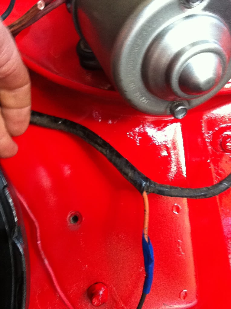

Just confirming that the clutch cable passes through this hole just above the stud (once its drilled out bigger!!)
At this stage I have left the hook on the pedal un-touched.
