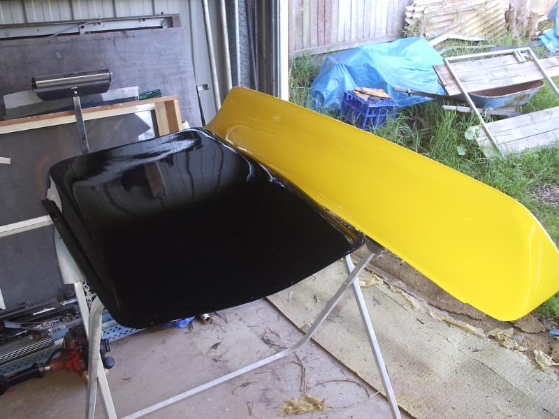

Well we're getting near the pointy end. I just finished glassing the inside of the rear flare that needed to be cut to get the correct gap in the door. Remember this:
Attached File  drivers flares 029.jpg   113.49K   7 downloads
Attached File  drivers flares 032.jpg   126.07K   8 downloads
What to do next is to clean the inside of the cut so that the glass mat will have something to stick too. I used my small belt sander,
Attached File  drivers flares 037.jpg   136.33K   7 downloads
Attached File  drivers flares 039.jpg   111.34K   7 downloads
Attached File  drivers flares 040.jpg   82.3K   7 downloads
After cleaning up the glass on the inside I take to it with my fibreglass repair kit
Attached File  drivers flares 041.jpg   170.12K   7 downloads
This is how I will place the glass mat on the inside when I mix the resin and hardener
Attached File  drivers flares 042.jpg   91.18K   7 downloads
After it is mixed and put in place I lay it out in the sun to help it dry.
Attached File  drivers flares 043.jpg   170.84K   7 downloads
Attached File  drivers flares 051.jpg   123.46K   7 downloads
This is the outside after sanding
Attached File  drivers flares 038.jpg   74.34K   9 downloads

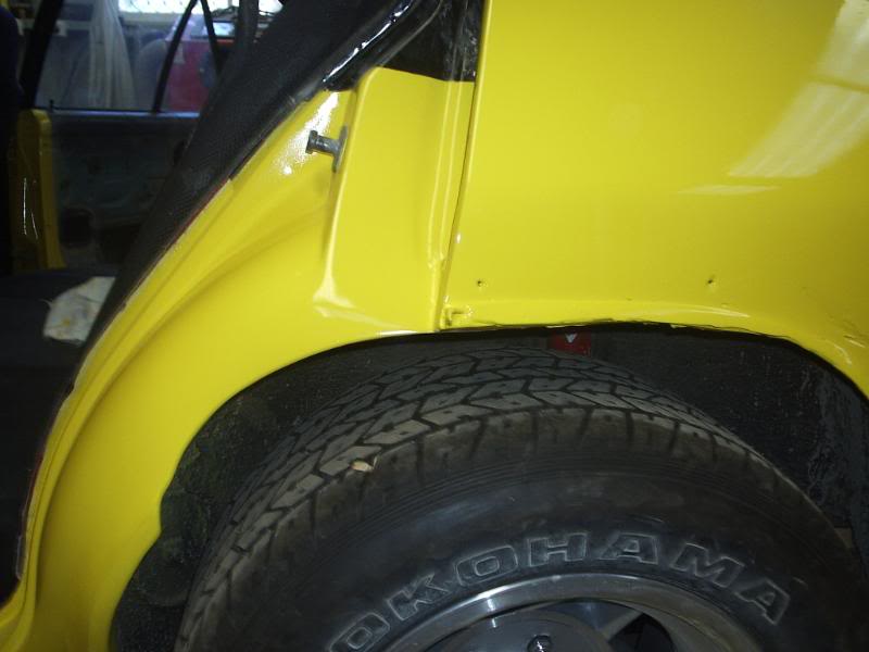

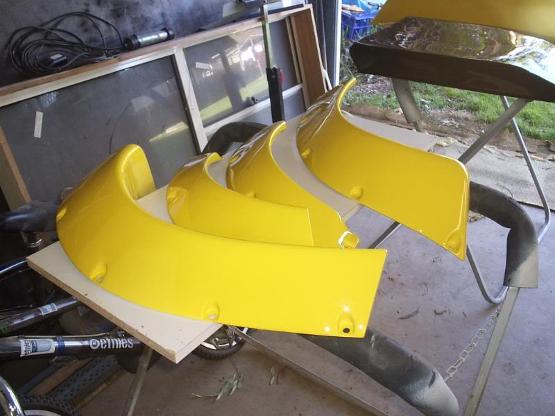

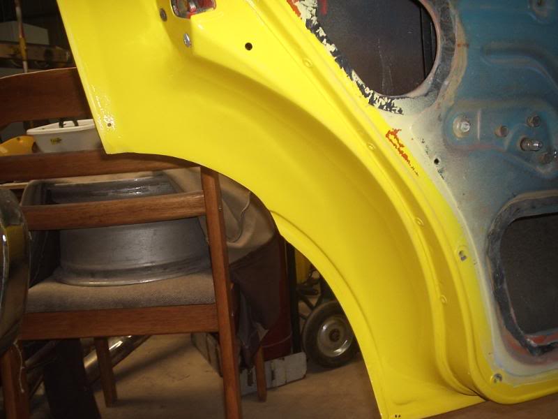

Ok so after all the repairs are done I applied primer. As there is a bit of paint work to do on this project I decided to send the car to a friends paint shop to have it painted. Here are the repairs after primer.
Attached File  drivers flares 049.jpg   102.62K   7 downloads
Attached File  drivers flares 047.jpg   140.54K   9 downloads
Attached File  drivers flares 046.jpg   133.91K   7 downloads
Attached File  drivers flares 050.jpg   142.92K   8 downloads
Attached File  drivers flares 044.jpg   161.54K   8 downloads

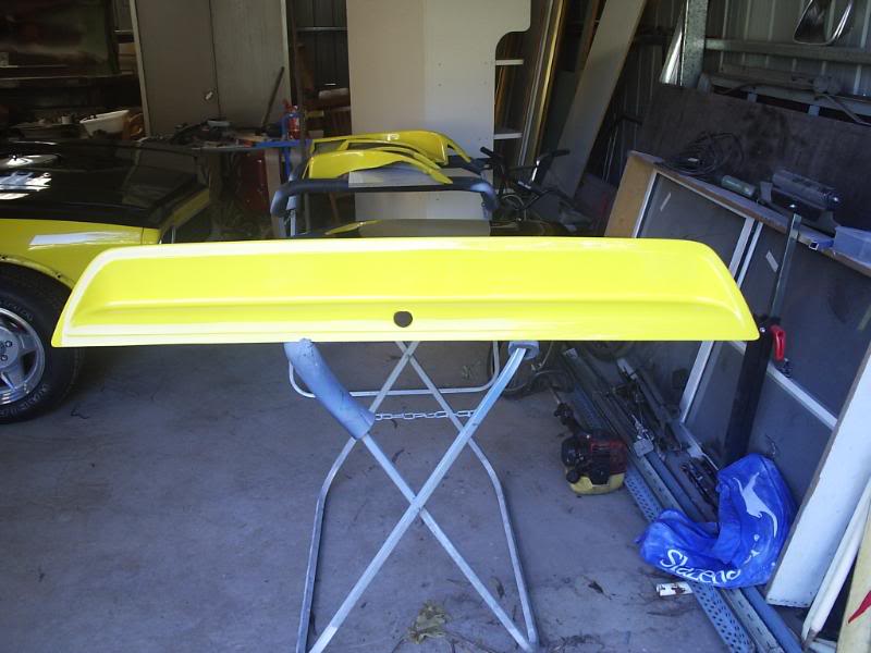

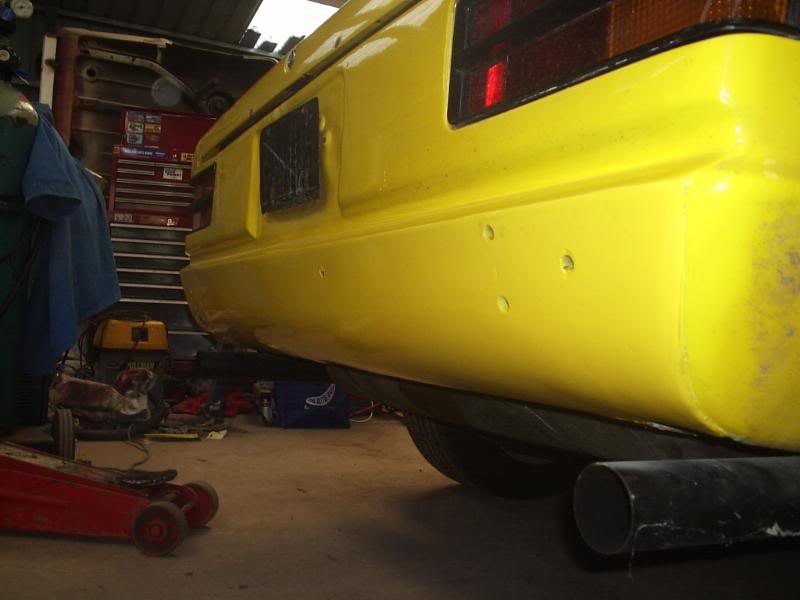

Just a quick one here, I spoke with the owner who wanted an old aerial hole welded up in the top of the passengers front guard. Naturally its a good time to this as we have to paint the bonnet and bonnet scoop.
Attached File  drivers flares 045.jpg   113.44K   8 downloads

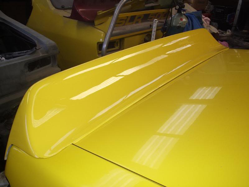

I refitted the rear spoiler for transport and its off to the painters tomorrow. Keep watching within the week for the finished product.
Attached File  drivers flares 048.jpg   127.55K   8 downloads
