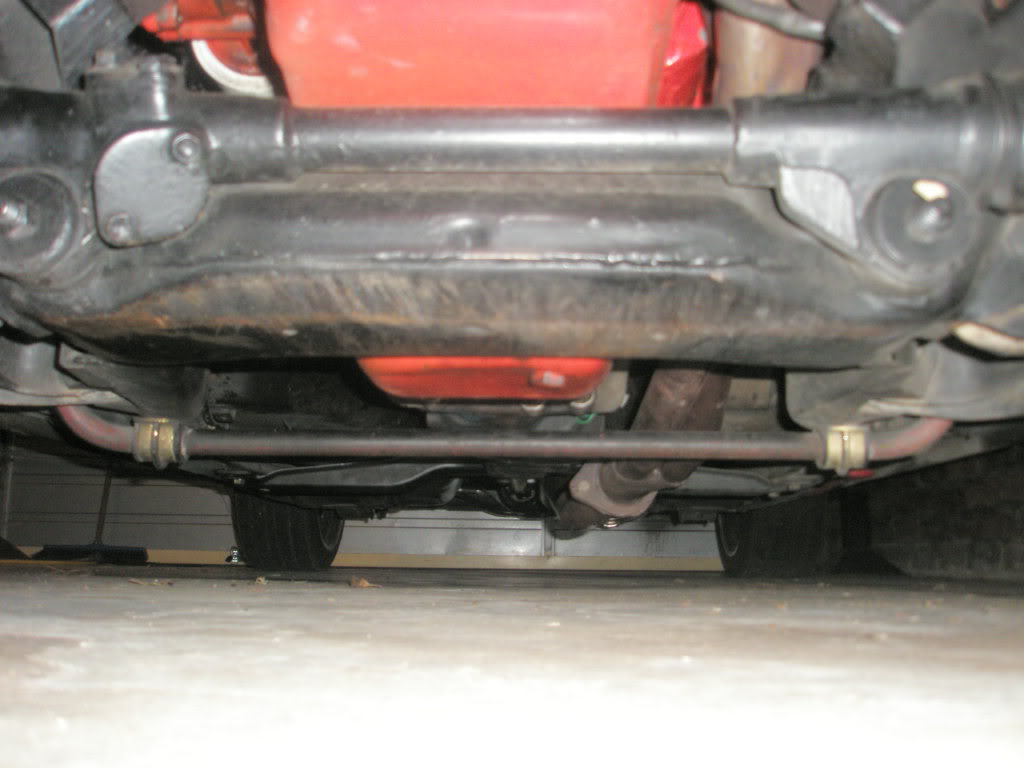

One question for cruiza - you mention "weld bracing plate to underside" of any sub-frame / k-frame. What's the reason for this, is flex really an issue? Any pics to show what you're talking about, I'd be interested to see that. As for the rest of your list - I think you've summed it all up beautifully. It's pretty much how I built my front end too - besides things like Bilstein shocks as well (I used Sports Ryders)... the other thing I would like to change, is to go for the solid bushes to mount my LX rack - is anyone making these yet? I reckon there'd be a few interested people if someone did a run of them.....
Hi LX Chev
I was told when I was doing this that flex bending was an issue and for me it has helped protect the sump, (still had to weld up holes twice) sorry no pics but if you look at underside flat plate with slight kick welded at seam at front below rack mounting and then rest of way round. Another thought could be that plate also beefed up for jacking the car up, I didnt think to ask just did what I was told.

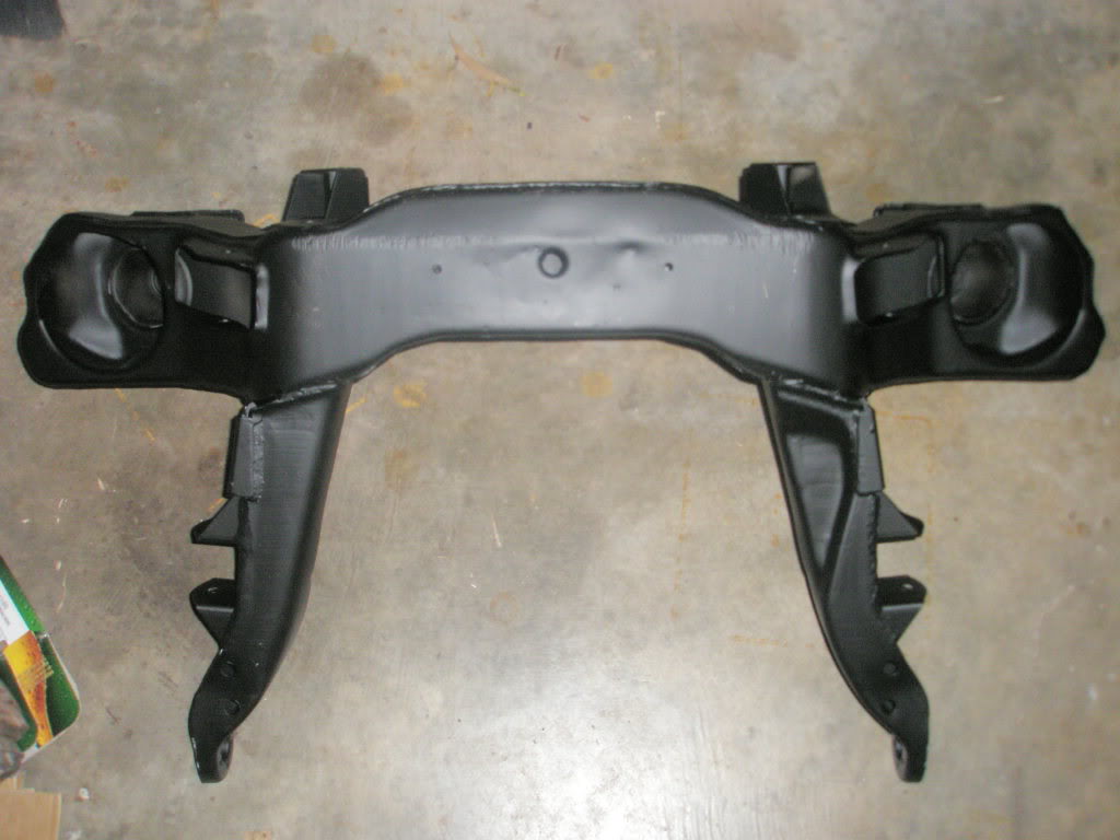

anyone got a pic of the underside of a front subframe? I will photshop mod to pic of standard one

I hope these'll do.

Yep they will do nicely, I see yours has a dent it which I figure is the reason for beefing it up.
out line in red foldline is ----- I am making sense now? :blink:

#39 76lxhatch
Posted 07 May 2009 - 08:28 AM
You just put another plate over that area?
#40 _cruiza_
_cruiza_
Posted 07 May 2009 - 09:20 AM
yip :D

What thickness plate did you use? I'm thinkin 5-6mm???

Nah 2 - 3 mm tops I cut the hole in the centre so it looked totally standard too only way to tell I had doine it was bit of weld at the ends, I thing the sandwich effect of two layers of metal gives it the strength as much as thickness, as I have mentioned in another thread the underside of my car copped a huge beating from lumps and bumps in the roads in NZ
Aahh, yep. That makes sense. Thanks mate, I think I'll have a crack at that.
If you do post some pics, also remmber not to weld too much in one area other wise heat will distort bend the K frame

While we're here, does anyone know what the recess in the pass. side outrigger (on the right in the pic of the bare x-member) is for?
Edited by Squarepants, 09 May 2009 - 05:29 PM.
#46 76lxhatch
Posted 09 May 2009 - 09:19 PM
Both outriggers are identical I think, so the passenger side recess does nothing but on the driver side it provides steering gear clearance on top.
