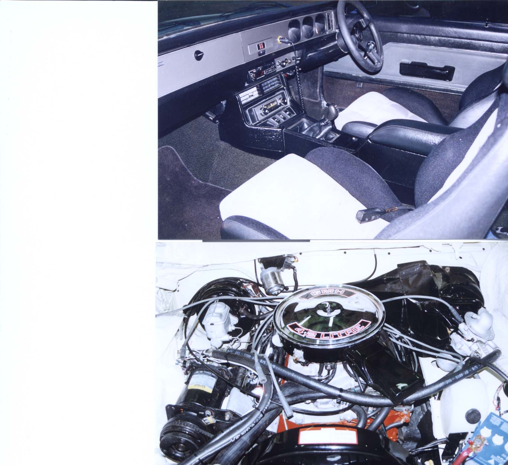

Hi Devils' here is my six cylinder set up.
Hope this helps clear up any other q's about compatability
with V8's too.
Cheers, leakey
Oh, and for the record, here is the dash set up for factory air too BlakeSS.
When I move the sliders all the sounds are 'sucking' air as they are vacuum
controlled, not wire controlled.

leakey,you have a vir setup, that domed vessel with the 4 hoses goig into it is the receiver dryer and valve unit. (valve in receiver) you have an lx?
speaking from experience, mostly bad, r134a or HC's wont work well in a vir. on r12 these systems will cool spectacularly, expect vent temp of 5C with blower on high in 40C heat. expect temps in the teens with the other stuff. supposedly got something to do with the system needing the higher density of the r12. vir have been reworked for134, but still wouldnt cut the mustard in my car.
Is your systemworking,out of gas. It is worth ringing, hunting around to try and track down some r12, you will pay a bit more for it, but it should 1. give superior cooling and 2, overall less hassles. i wish i did, my system no is minus the vir and runs on r134 and is barely good enough, would have cost far less to track down r12
dont let any one near the car with anything else, unless they really know what they are doing......ask them to give you written guarantees of the vent temps, get them to describe how the vir works etc
sp34e sounds like its a good drop in alternative,but suspect it would have the same probs in a vir unit
