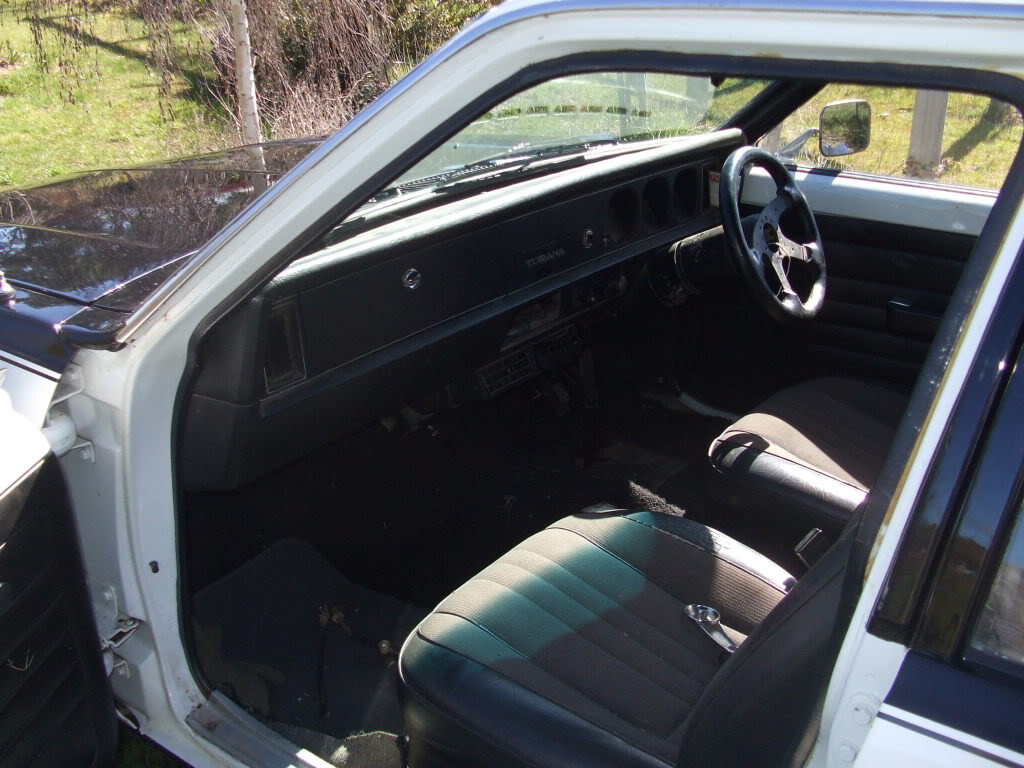

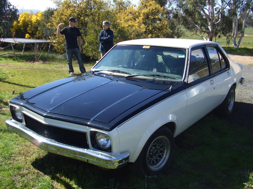

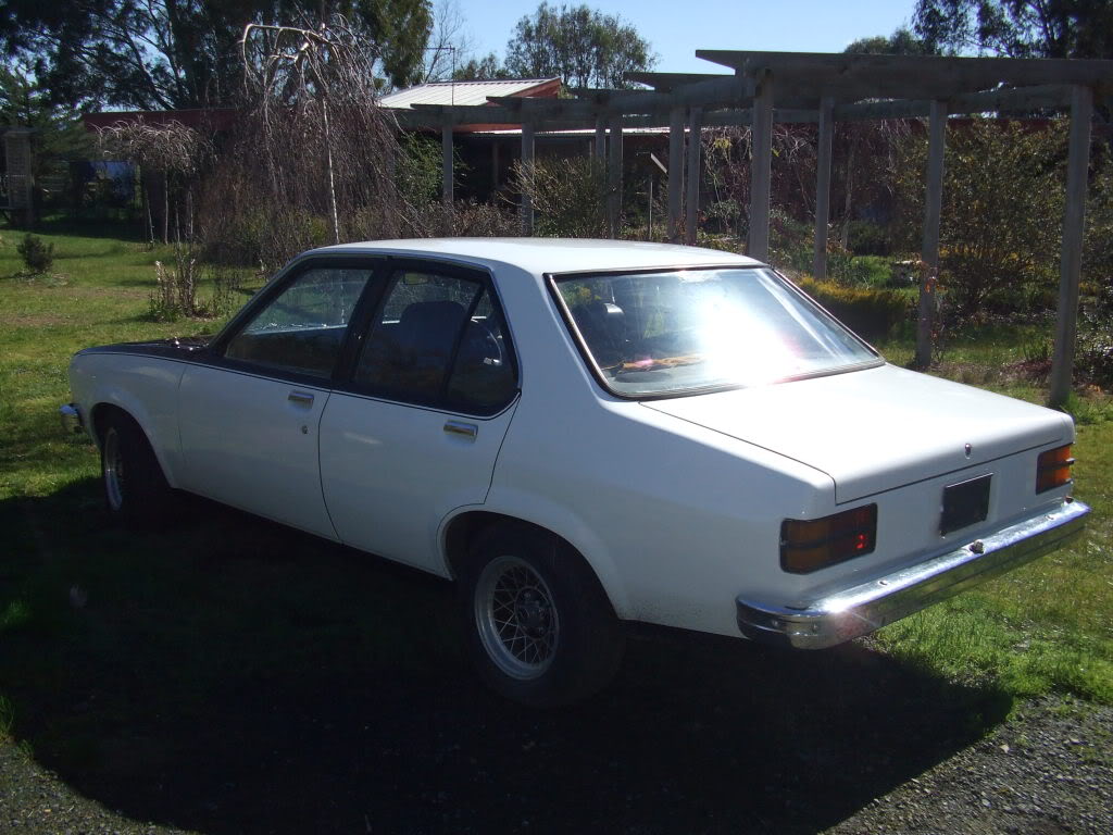

Hey all, new to the forum and new to the aussie muscle car scene! Currently drive an r33 skyline turbo that im swapping for my mates LH torana.
Car has had a full bare metal respray in white with a black bonnet, everything re-chromed too so great shell for a project!
Currently has a warm 186, aus 4 spd n banjo thats all coming out.

sorry bout the dumb ass questions, all pretty new to me, will attach couple of pics of the car. let us know what you think

https://cache.gmh-to...ng/DSCF0889.jpg
https://cache.gmh-to...ng/DSCF0888.jpg

https://cache.gmh-to...ng/DSCF0890.jpg
and another just 4 good luck!
