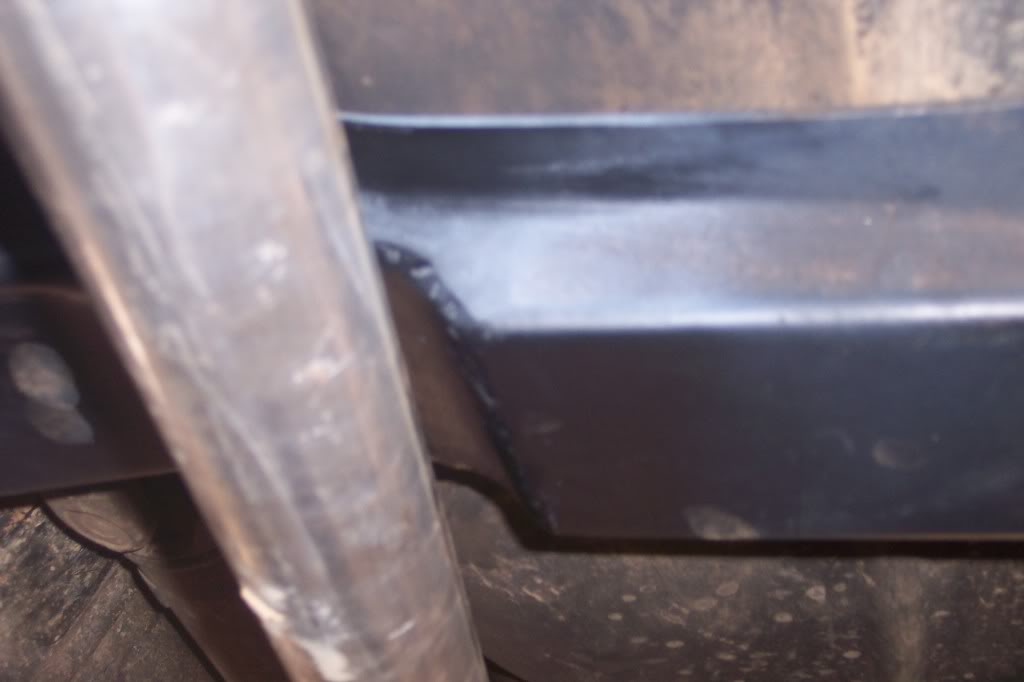

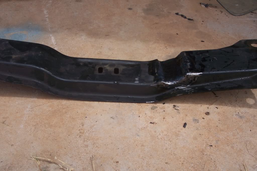

The job for today was to fit my new exhaust. I wanted to tuck it up real nice coz the idea of crushing my exhaust on the first speed hump didnt really appeal to me. i decided to modify my crosmember and this is what i did.
just a quick cut and weld in a new piece
heaps better and flows better than two bends too!
