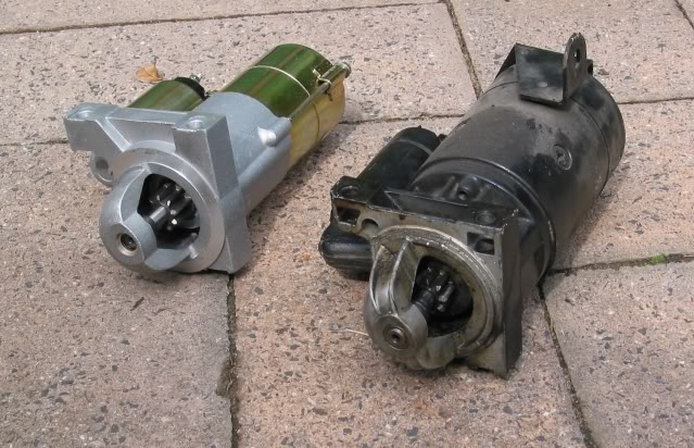

Just wanted to say thanks to all who contributed to this thread as the information was very helpful in finding a replacement starter for my 5.0L VK. Damn thing has had a reluctance to start when hot or left sitting for a few days (like an almost flat battery) for some time now. Battery and leads were known to be fine as they're relatively new so I decided to purchase the Jaylec Hi-Torque starter rather than another reco'd standard one. Best thing I ever did as the cranking issues have now disappeared. :spoton:
Jaylec compared to the original.....
Jeff
