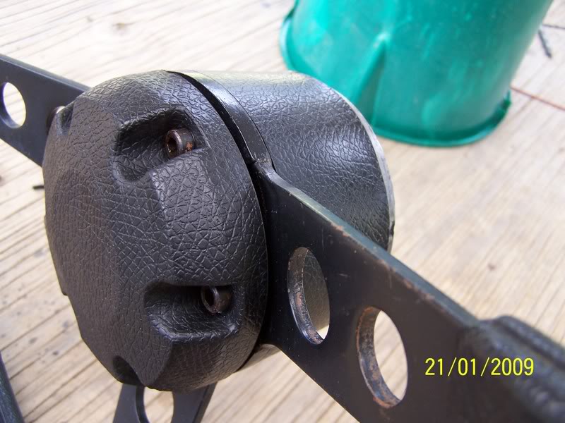

Here is the Rare Spares wheel:
if you look close you can see the separation between wheel and boss

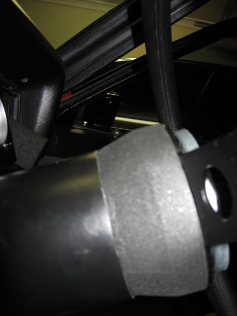

Posted 21 January 2009 - 10:19 AM
and here's a well-worn original one piece:
Its probably easier to see with the horn piece removed though...

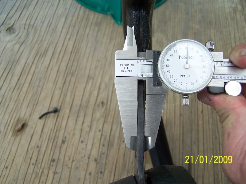

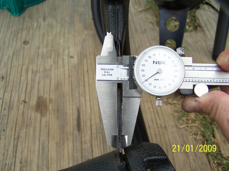

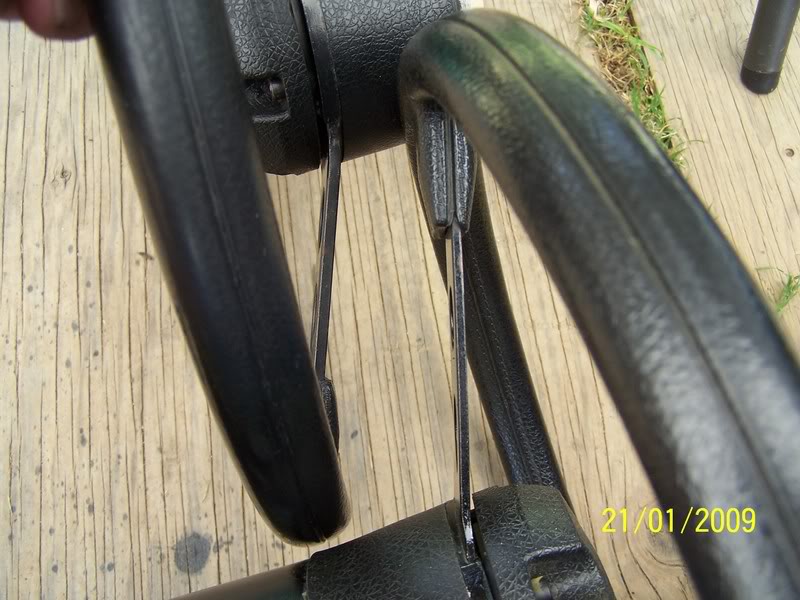

ORIGINAL THICK AND THIN SPOKES, YOU CAN ALSO SEE THE GROOVE AROUND THE RIM AND THE REAR OF THE WHEELS IS PART OF THE RIM AND COVERED WITH A GRAIN FINISHED RUBBER
MEASURING THE THIN SPOKE WHEEL
MEASURING THE THICK SPOKED WHEEL
SHOWING THE CENTRE CAP IN RELATION TO THE WHEEL, NOTICE A SMALL GAP. NO UGLY BOLTS HOLDING THE RIM TO THE BOSS AND THE BOSS AREA IS THE SAME DIAMETER ALL THE WAY ALONG
