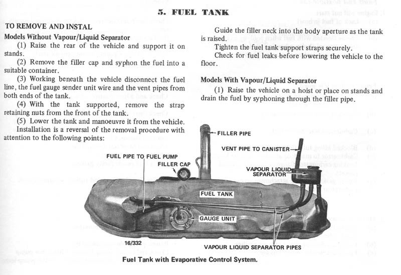

O, also. With the petrol tank pressure... Are all your breather lines connected? That will help you when filling up. My old tank didn't have breather lines and it just use to spit petrol out the filler if i did more that 1/4 squeeze on the trigger. Now i have a better tank in, it has all the breather lines and i can squeeze the trigger 100% of the way

Most drop tanks do not have the breather at the back of the tank connected to the filler. I think this contributes to problems filling the tank, so I have added it to my drop tank.

Thanks guys, yes the breathers are all connected as I bought the tank sealed with no breathers or filler and just copied the factory one. However the original tank used to pressurise too, although I could never figure out why as all the breather lines were always clear when I checked them.
