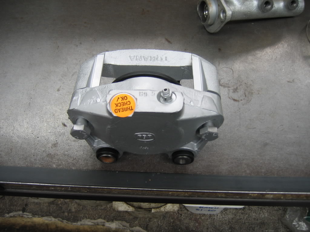

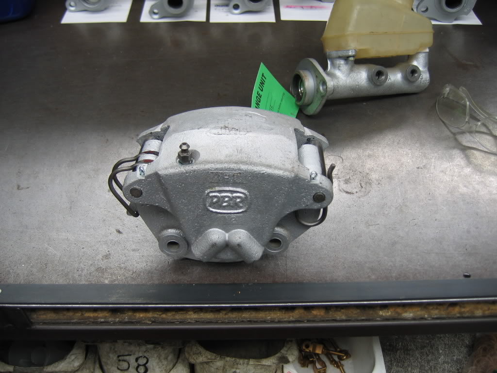

Torana
All LH and early LX (not inc L34)
Cast iron PBR
Takes DB14 pad shape

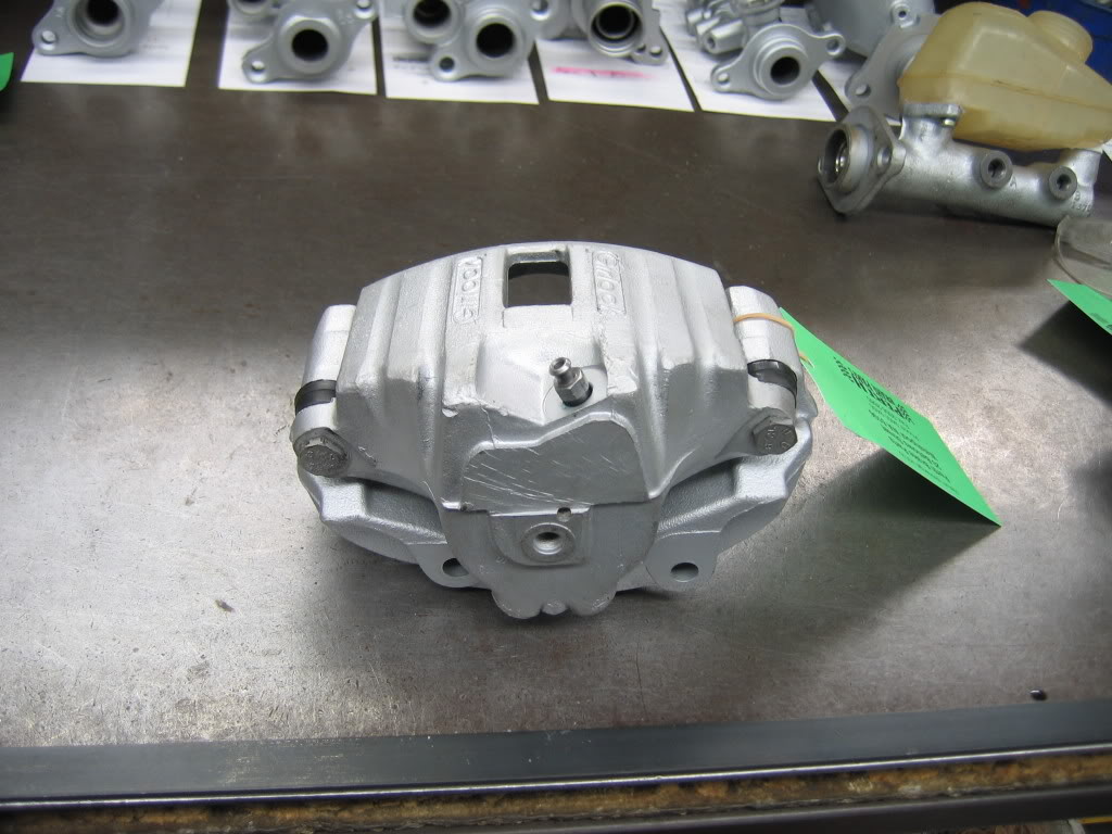

Later LX and UC to 7/79
Alloy PBR
Takes DB1028 pad shape

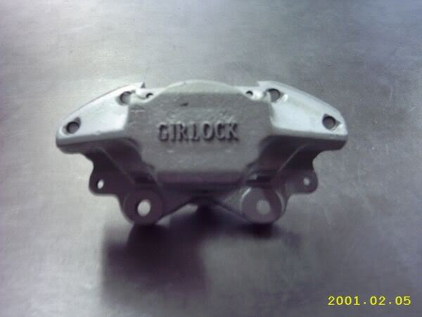

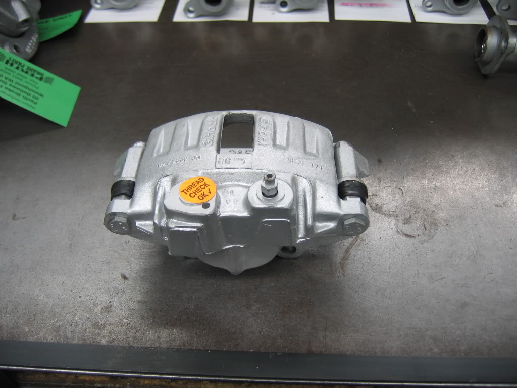

Late UC
Alloy PBR (sometimes Girlock marked. PBR bought Girlock)
Takes DB1085 pad shape
Late UC are the better ones....... then PBR cast LH ones
The PBR alloy although it has the largest piston and pad area is the worst of the bunch

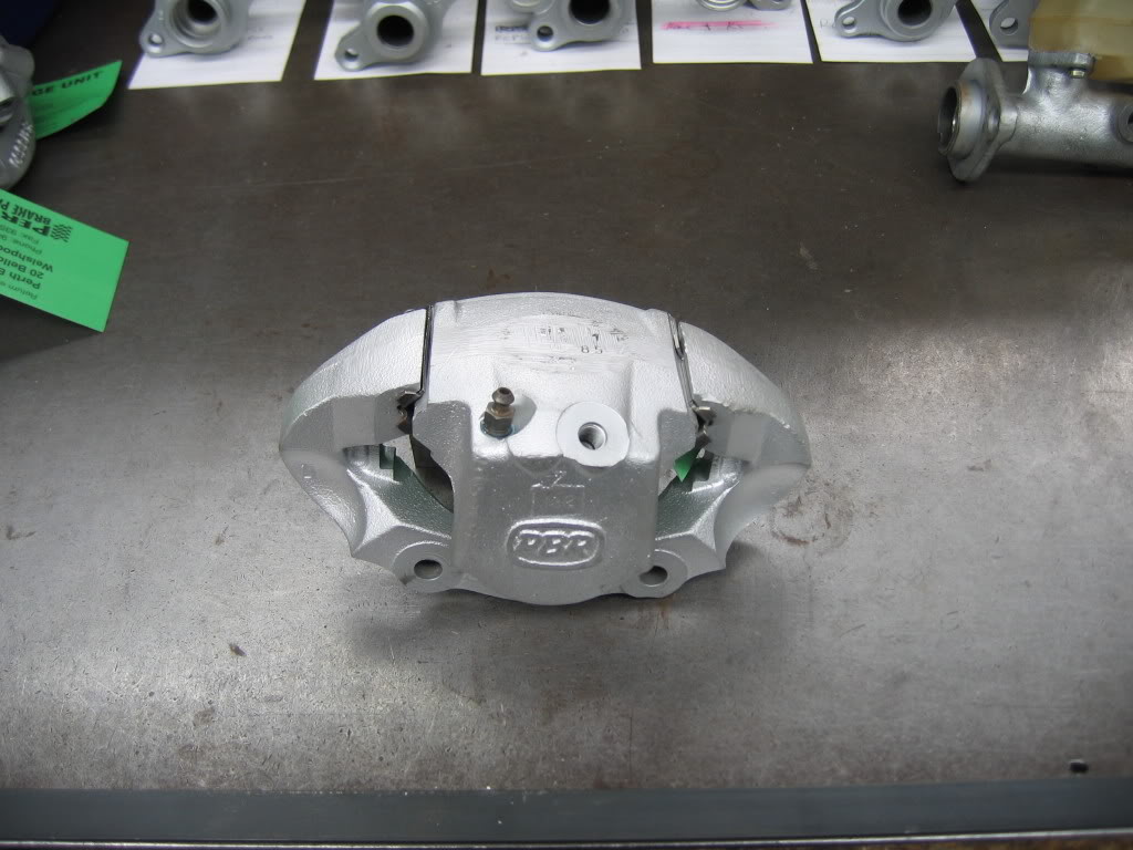

And now to add further... HQ-WB calipers
HQ cast iron
DB6 kidney shaped pad
L34 ran something very similar but hose inlet at top like Torana
They revised the design a few times thru the HQ years... but they are essentially the same

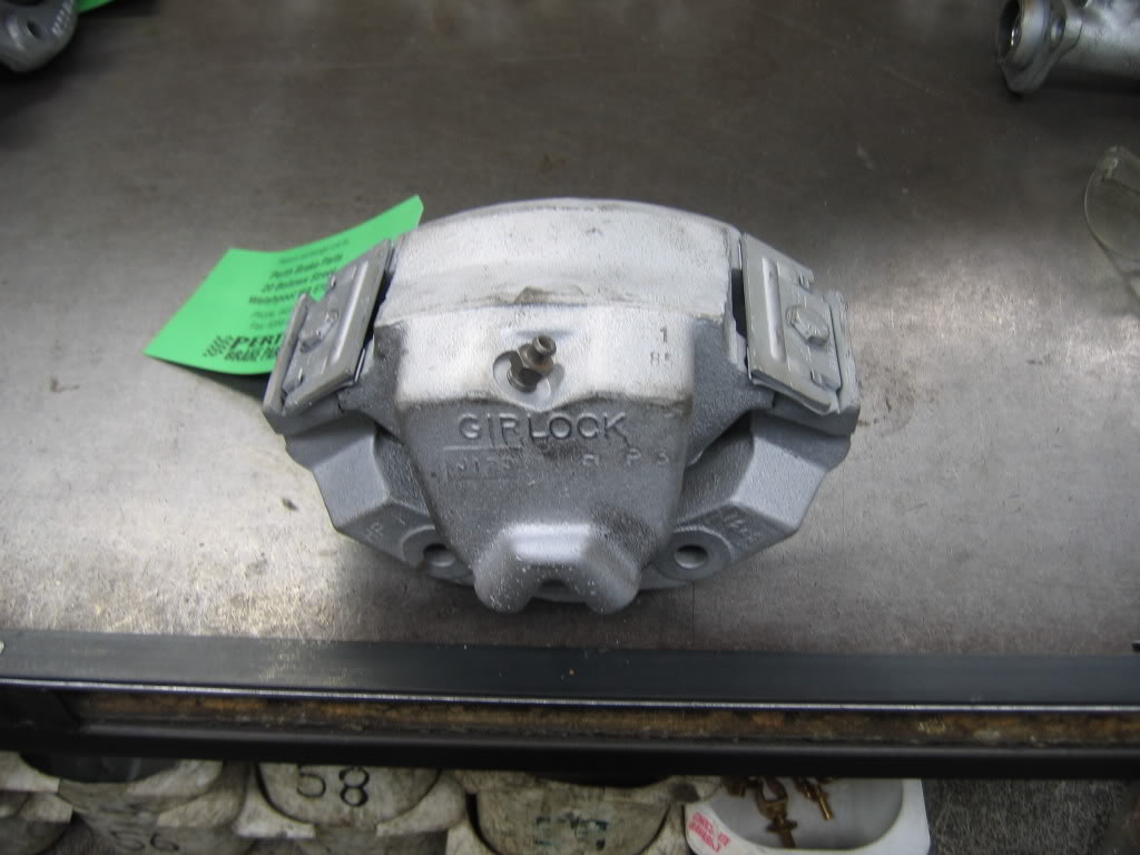

HQ-J cast iron Girlock caliper
My favourite... but the heaviest and hardest to find
Used on 350 Statemans and commercials mainly
Slides on plates (Takes DB1004 pads)

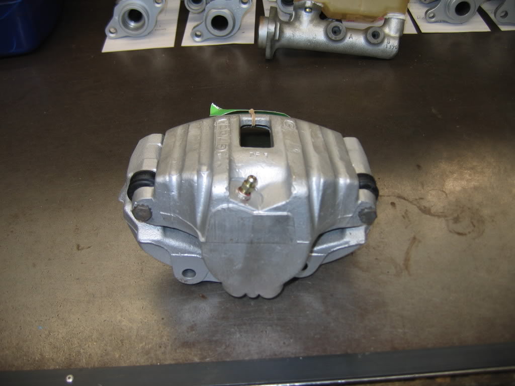

Girlock alloy... has a cast cradle with HOLDEN embossed on it
The worst caliper on the face of the planet
Big piston and pad area (DB1029) ... but crap
Known in the industry as creaky groany calipers... prone to breaking off the mounting slide areas when the pins sieze... total shite... avoid
Now the picture is actually the Torana version with the hose inlet in the top... HX one is at the bottom... and the pic suits solid Torana discs not HQ vented... but its the closest pic I have... Torana caliper is equally shite !!

They vary in size,shape and weight.... If I was picking calipers for a HQ-WB I would use the Girlock cast iron first , PBR cast second , WB third , HZ forth and the HX alloy PBR's would be propping the door open in the dunny.
