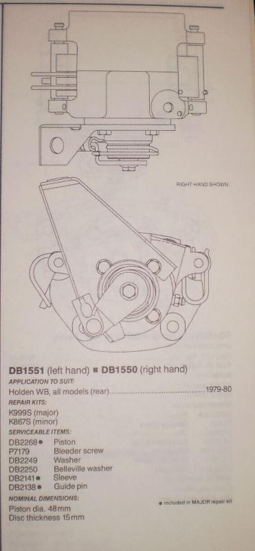

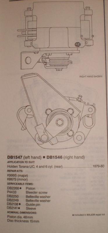

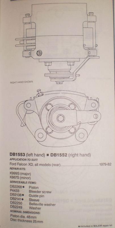

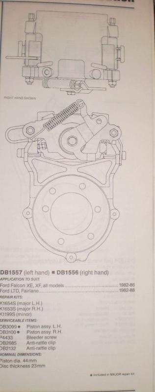

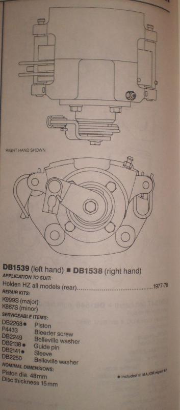

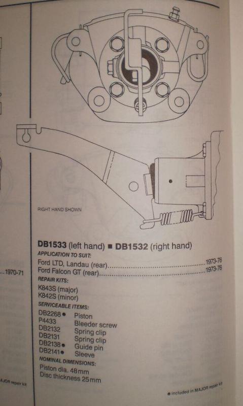

Rears
Old school
Falcon XB-XF
HZ-WB-Torana
XA-B
XC
XD
XE-F
HZ
WB
Torana (inc A9X)

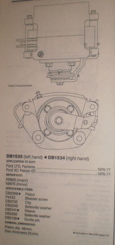

Datto, I am recoing my front calipers and was wondering if you could tell me what kit and piston I need, they are for an LH and are the same as the first pic at the beginning of the thread.
#29 dattoman
Posted 28 March 2014 - 09:32 PM
K1043S ... nice cheap commodore kit
Just throw the slide boot rubbers away
Piston is DB2746 .,.. also commodore
P4433 if your throwing new bleeders in it
