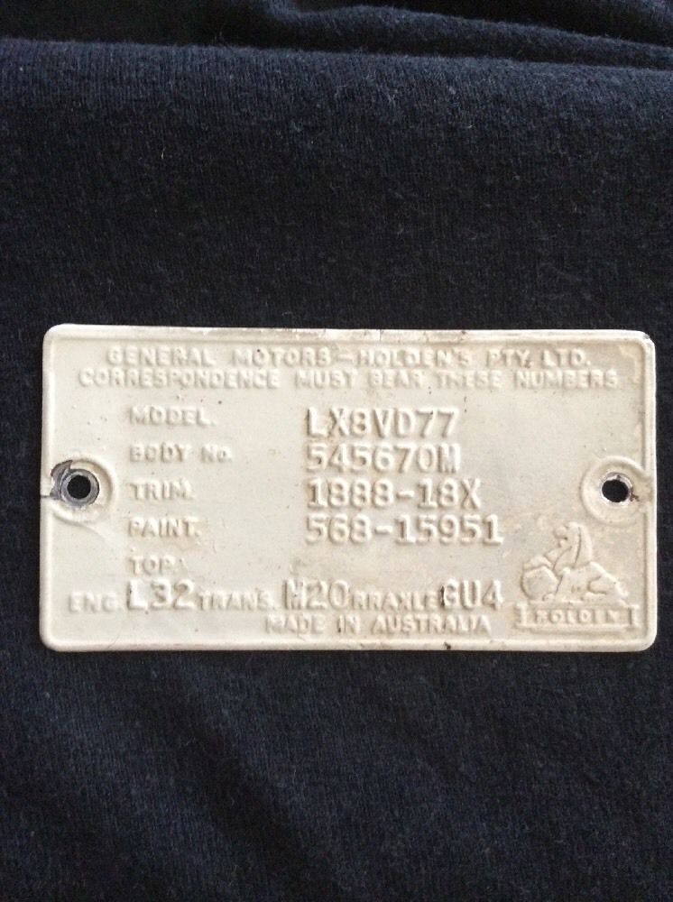

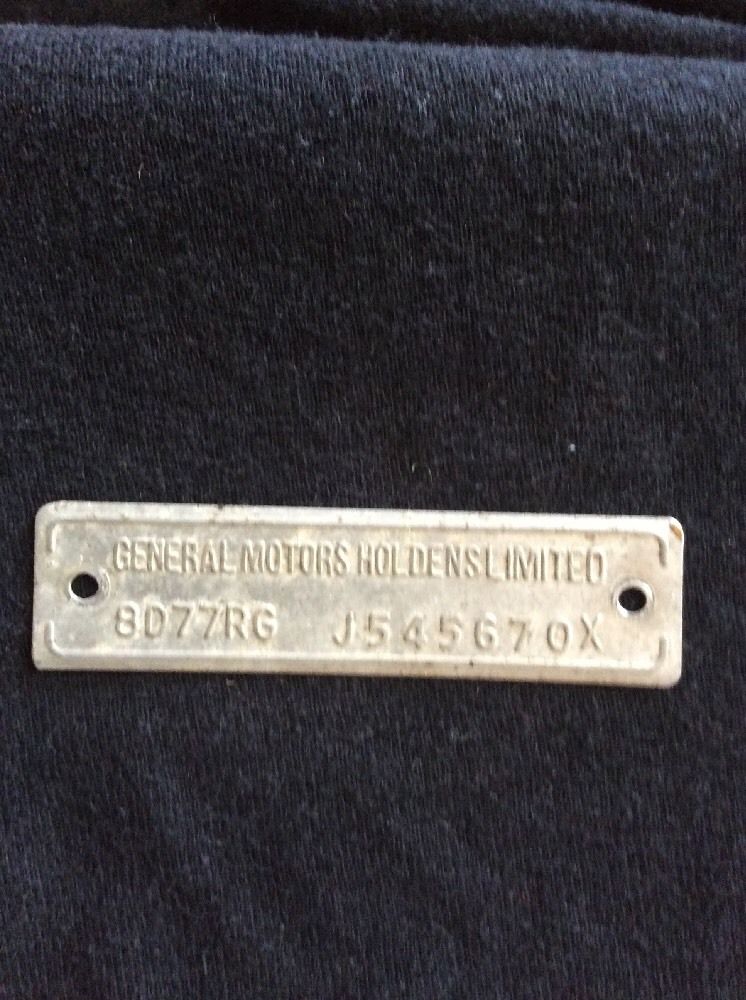

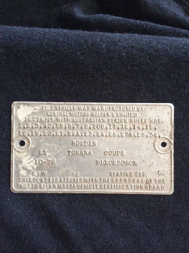

These were mentioned in another thread.
http://www.gmh-toran...ay/#entry873520
Sorry if already done before.
Attached File  post-43243-0-07550700-1418377286.jpg   66.91K   7 downloads
Attached File  post-43243-0-22791000-1418377280.jpg   134.68K   5 downloads
Attached File  post-43243-0-62567200-1418377291.jpg   64.17K   6 downloads

For sale on Ebay 1/2/2015
LX8VD77
545670M
1888-18X
568-15951
L32 M20 GU4
10/76 BLX093080M
8D77RG  J545670X
#360 S pack
Posted 01 February 2015 - 11:20 PM
LX8VD77
545670M
1888-18X
568-15951
L32 M20 GU4
10/76 BLX093080M
8D77RG  J545670X
I believe that should be BLX023080M

You need to actually type out the numbers
From Mick's fb post
Chassis Number: ALX054496M
Build date: 8/76
So really it should be CLX054496M
Next, the VIN Tag and the Body Tag
The Body No: 454887 is actually an LH body number. Production date was 24/10/74 and was 8B69DFJ454887H.
Firstly, any LX built after 6/76 will start with BLX and not ALX
Secondly, that Chassis No 054496M is actually a Sept 1977 built 8H77 Hatchback (body J593200)
There were no M40's built at that time due to A9X production.
The stamped chassis number on the body is so far wrong, it just dumb!
The body number: J454887 is actually an LH body number too.
The Body number, J454887, was originally an LH8VB69. The VIN was 8B69DFJ454887H. Production Date was 24/10/74. Engine # HD16327. The car was 2850, Trimatic, drum brakes, 2.78:1 rear axle.
From the pic; VIN 8D77TFJ454887X
s
I had it as a 2 then looked again and thought it was a 9 but thinking about it now it can't be a 9, will have another look, I think a 2 is right for 10/76
Checked again definitely BLX023080M
Edited by tuxedoss, 02 February 2015 - 01:01 PM.
Yep, my 10/76 is within about 780 of that.
Cheers, TB

They certainly look real enough,but just curious on when they started using "A" after COUPE, and was GMH consistent
with the ADR #'s as they progressed through time...eg..27A 28.29.31.34,even though it seems some numbers were not used
did they actually at least "count up" even though some #'s were not used?,or did they chop and change?,probably info around here
somewhere about that but half the time it's easier to ask again.
#375 yel327
  • 13,977 posts
Posted 04 February 2015 - 03:53 PM
A started once ADR27A came into force, only appears on ADR27A auto cars. ADR's were not numbered or set by GMH, they just complied with teh relevant ones.
