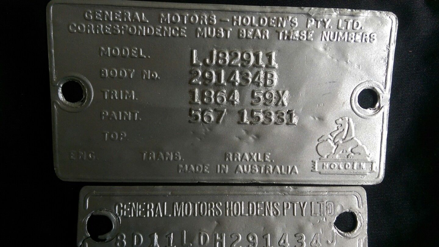

Gumtree
This Adelaide XU-1 VIN tag has been up for sale a few times over the past years. 82911JL211441, but this time with a Brisbane body ID tag. No 02468-B Chateau Mauve Met.

LJ GTR Tags on ebay
Started by Kevrev, Today, 08:11 AM
#1 Kevrev
  • photo-thumb-53903.jpg?_r=1493072283
  • 165 posts
  • Name:Kevin
  • Location:Rural Vic
  • Car:73 LJ GTR
  • Joined: 21-August 14
car.png View Garage
Posted Today, 08:11 AM
Couple of LJ GTR tags on ebay this week
http://www.ebay.com....=STRK:MEBIDX:IT
VIN 8D11LDH291434J
Body 291434B
Trim 1864-59X
Paint 567 15331
Whatever happened to the dodgy tag thread?
Cheers Kev

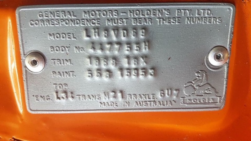

#619 hanra
Posted 21 May 2017 - 07:44 PM
Lolz
DAB17392-0116-4D40-B580-71C9821F5E10_zps
70344DB9-7316-4FB1-87E9-62CF50CCDD1E_zps
227E9837-5FD4-4D39-B5BF-A7585E59DB9A_zps
#620 Bigfella237
Bigfella237
    Socially Distant
  • 4,396 posts
  • Name:Andrew
  • Joined: 31-October 14
Posted 21 May 2017 - 08:41 PM
For the search engine:
I can't quite make out the chassis number, I think it's ALH019*48M but I'd only be guessing the missing digit?
8D69TE J447755H
LH8VD69
447755H
The paint code (568-15953) is Mandarin Red but that doesn't seem to agree with the trim code in my list, unless it's some combo I haven't seen before?
L31 M21 GU7
#621 hanra
Posted 21 May 2017 - 08:50 PM
Have a look at the body plate again. Dodgy.
#622 RallyRed
RallyRed
  • 8,273 posts
  • Car:LC GTR etc
  • Joined: 02-October 11
Posted 21 May 2017 - 08:52 PM
L34?..N21?
#623 S pack
Posted 21 May 2017 - 08:54 PM
L34?..N21?
Col, that's exactly what I was going to say but you beat me to it.:)
#624 IMORAL
IMORAL
    Bored
  • 2,569 posts
  • Car:LX SS HATCH - IMORAL
  • Joined: 24-February 11
Posted 21 May 2017 - 09:19 PM
Bathurst box?.....
#625 grumpy xu1
grumpy xu1
  • 2,812 posts
  • Name:Gary
  • Location:Queensland
  • Car:lj xu1
  • Joined: 01-February 10
Posted 21 May 2017 - 09:49 PM
Fake shit box is more the case I'd suggest. Looks like a 5 year old blind kid did the stamping !
