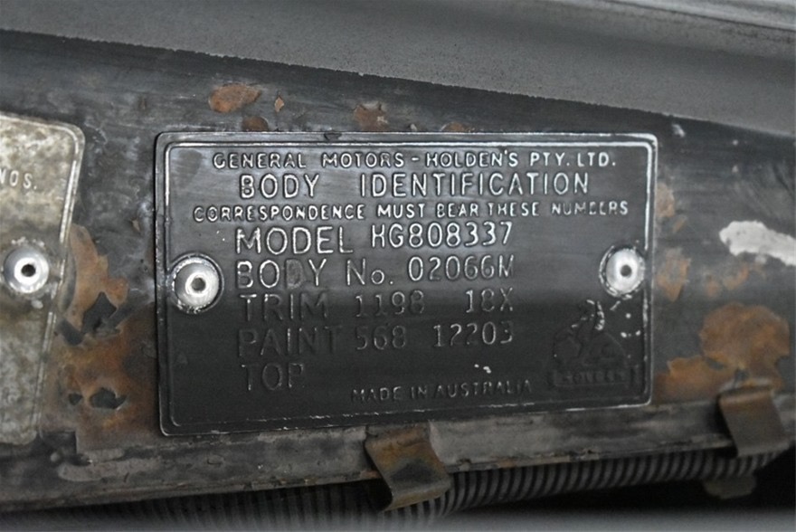

Someone just paid $35k for a guide coated and primed HG Monaro through Grays with a fake body tag. Not that it really matters on a base spec car, but the deception is there.

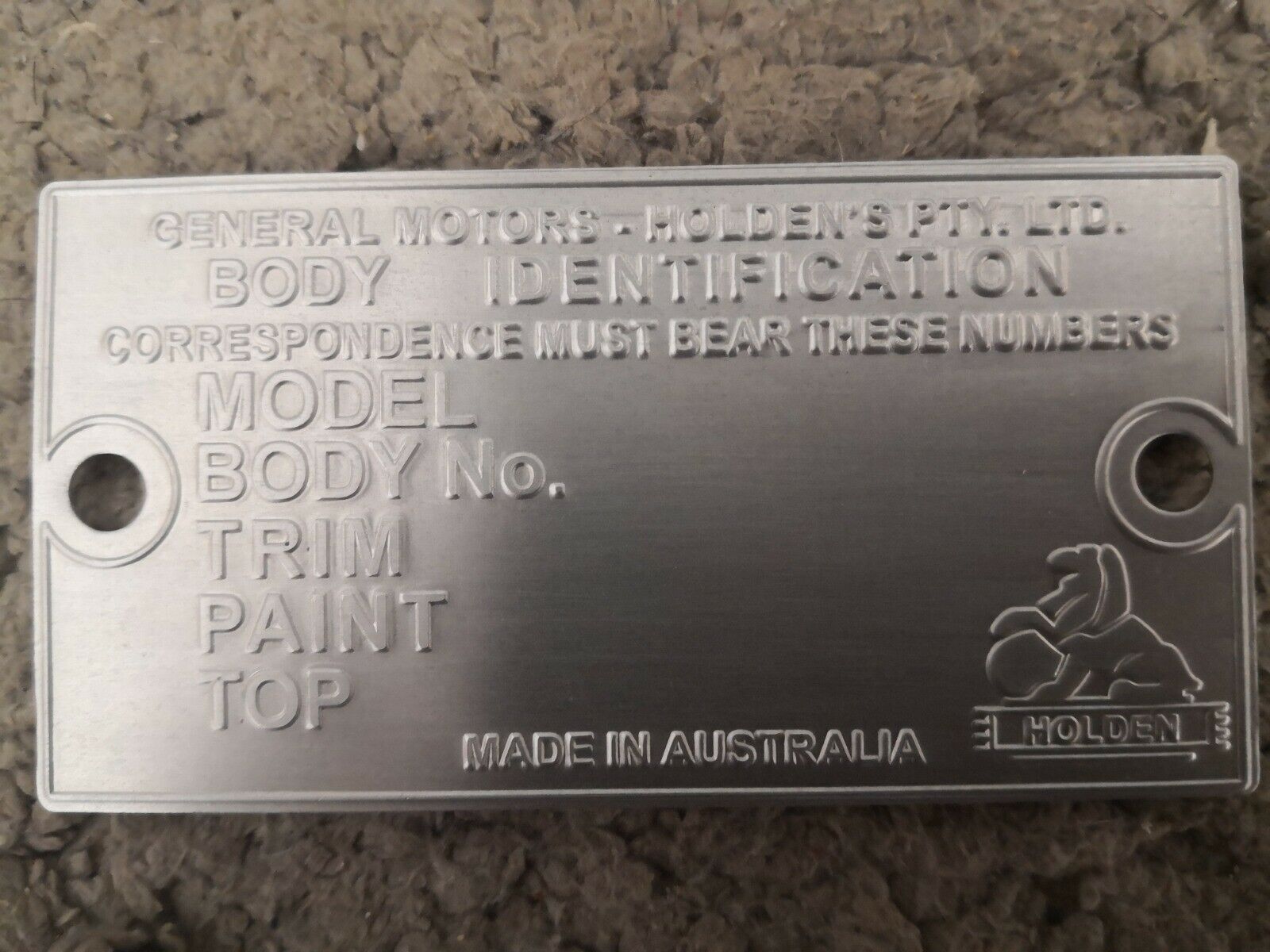

It looks like he used one of these. Perhaps it might have fooled a few more people if he made it look as old as the compliance plate.
Pricks are still selling these on ebay and gumtree in plain sight of the cops. A couple of them are probably even reading this. So instead of bending over backwards to book someone on a quiet country road for speeding by a couple of kilometers an hour, how about finding these bastards and giving them what for.

02066M

Yel327 how'd you pick the Monaro plates dodginess? What should people look out for?
#789 yel327
  • 13,975 posts
Posted 07 September 2019 - 01:38 PM
Look at the BODY number versus the chassis number, don't need to look any further. People who create fake tags more often than not think they are so smart yet they are really so stupid they outsmart themselves!

#795 S pack
Posted 08 September 2019 - 08:02 AM
Definitely not of the same manufacture.
#796 Shiney005
Shiney005
  • 10,028 posts
  • Name:Laurie
  • Location:Dubya Hay
  • Joined: 19-January 12
Posted 08 September 2019 - 10:05 AM
Yeah, I see it now they are side by side.
