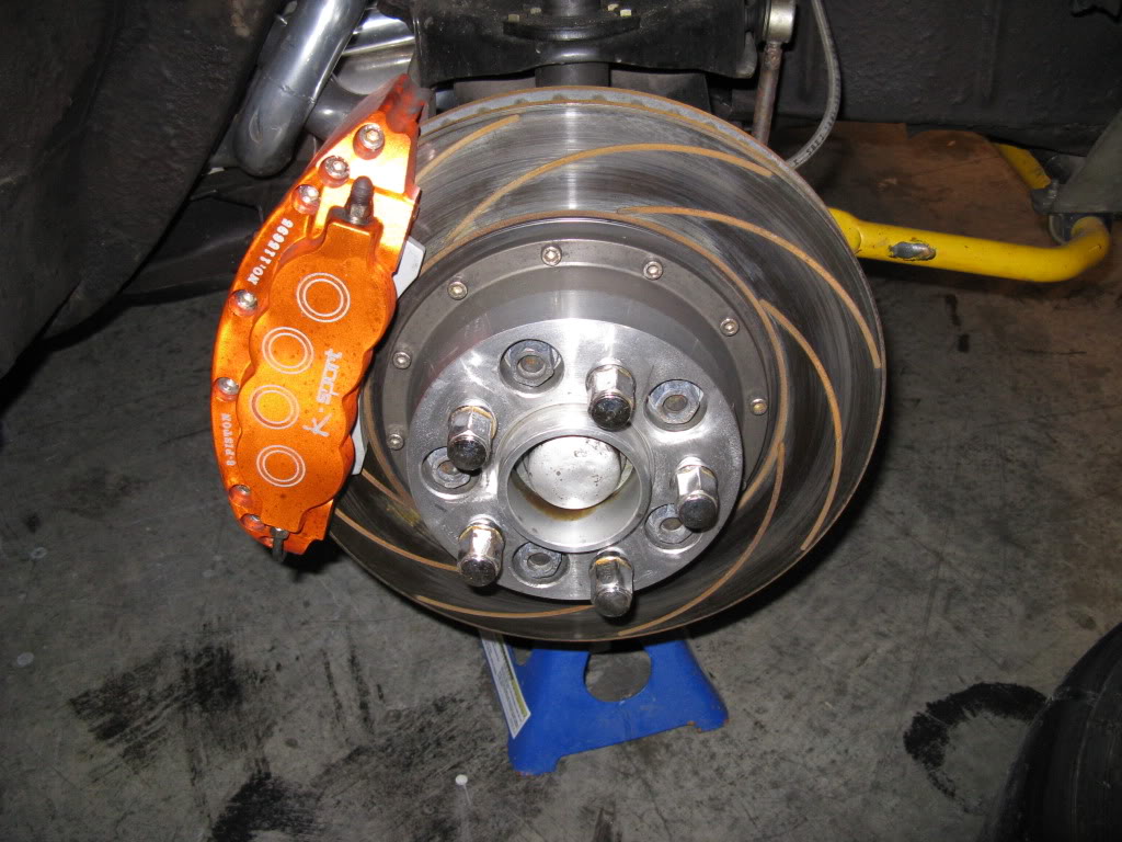

Hi all
Here is an interesting way of converting your existing stud pattern to, well, whatever you want I guess. In this case, it also provides the required "spacing" for the Commodore wheel offset.
I'm not saying this idea is good, bad or otherwise (I'm no engineer), but I did find it interesting.
I assume that this does not classify as a "spacer"??
Took the photo today at Motorex in Sydney.
Cheers, H

#59 ls2lxhatch
Posted 11 July 2009 - 10:44 PM
Hi all
Cheers, H
Spacers and adaptors are not legal in any state unless factory fitted. If you have an accident as a result of the adaptor failing your insurance company would have the option of walking away. An adaptor that is safe to use can be made but it will still not be legal or insured.
There is a picture of a failed adaptor in this thread.

Posted 12 July 2009 - 11:57 AM
Indeed, Personally theres no way I would ever run spacers I do remember that thread and the driver is extremely lucky,ive heard seen similar stories on other Auto websites too so its certainly not uncommon!

Posted 12 July 2009 - 10:07 PM
Geez! Thanks for the link......

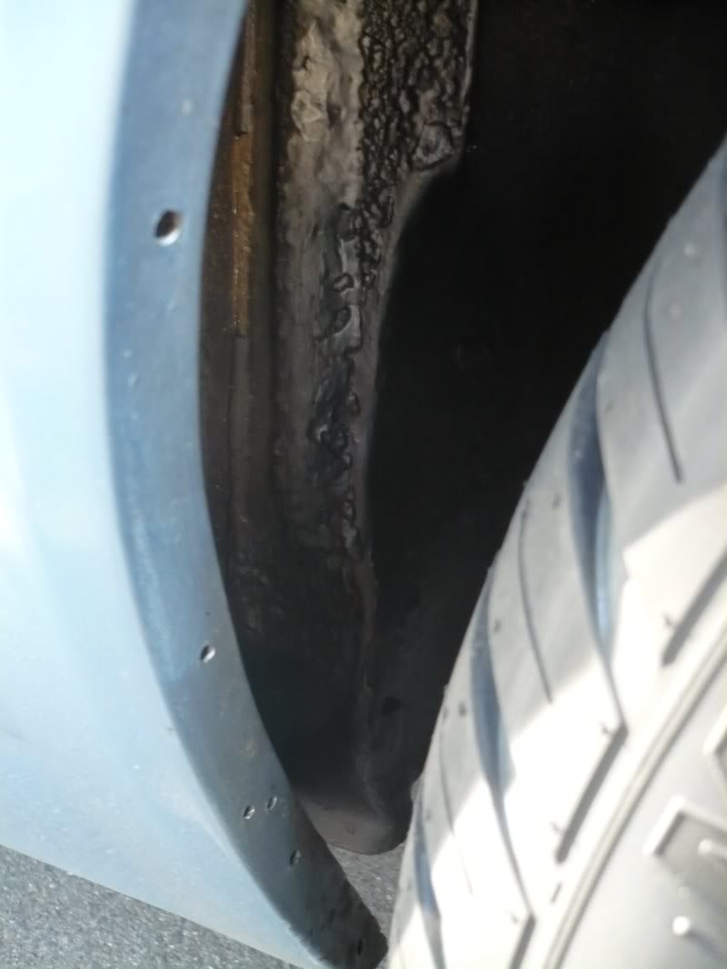

What rubber are you guys running with your 17's. Im keen to run a 45 profile on my 17inch streeters but it looks like i might have to cut the guard to make it fit as I only have 50mm clearance from the wheel to guard and measuring 45mm profile on my commodore ute, it measures at 75mm from wheel to outer edge of tyre.
Would running a bigger profile on the rears compared to the front look stupid?

Posted 14 July 2009 - 10:43 AM
i have 45 profile on my streeters and all my guards are rolled and it did require a little inner guard work
Ben

#72 _UNVSM8_
_UNVSM8_
Posted 14 July 2009 - 04:02 PM
youngy that picture is of the front guard
there was no modification to the rear guards besides getting them rolled..
Ben

hi ben, what about at the front. How close are you there?
I had to trim the front bottom corner of the wheel arch off as well as the inner guard behind the wheel like UNVSM8 has shown.

Posted 15 July 2009 - 09:16 AM
Yeah thats my issue. The inner guard behind the wheel is not noticable but the front lip will be noticable. Do you have any photos of the front lip modification squarepants??
Thanks youngy

Posted 15 July 2009 - 11:57 AM
Attached File  P6230028.JPG   411.17K   46 downloadsMy Front Tyres and rims are 215/40 zr17's on 17 X 7 inch boyd coddington smoothies
Attached File  P6230026.JPG   400.86K   38 downloadsNo mods required to rear lip
Attached File  P6230030.JPG   291.05K   18 downloadsAttached File  P6230031.JPG   318.83K   23 downloads but i had to cut the front corner off the guard as well (like square pants) although i just added the front spoiler and it covered the problem.
With the fronts ive got the CRS stub axles and i have VP commodre rotors the hub from the face of the disc to the bolt up face is about twice as thick as a HQ rotor not sure if this has had any bearing on the issue?
Attached File  P6230032.JPG   182.42K   26 downloadsRear 235/45 zr17's on the same 7 inch rims,do fit i had to lip the guards to stop scrubbing.
i hope this is of benefit
